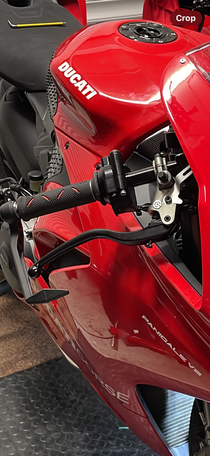

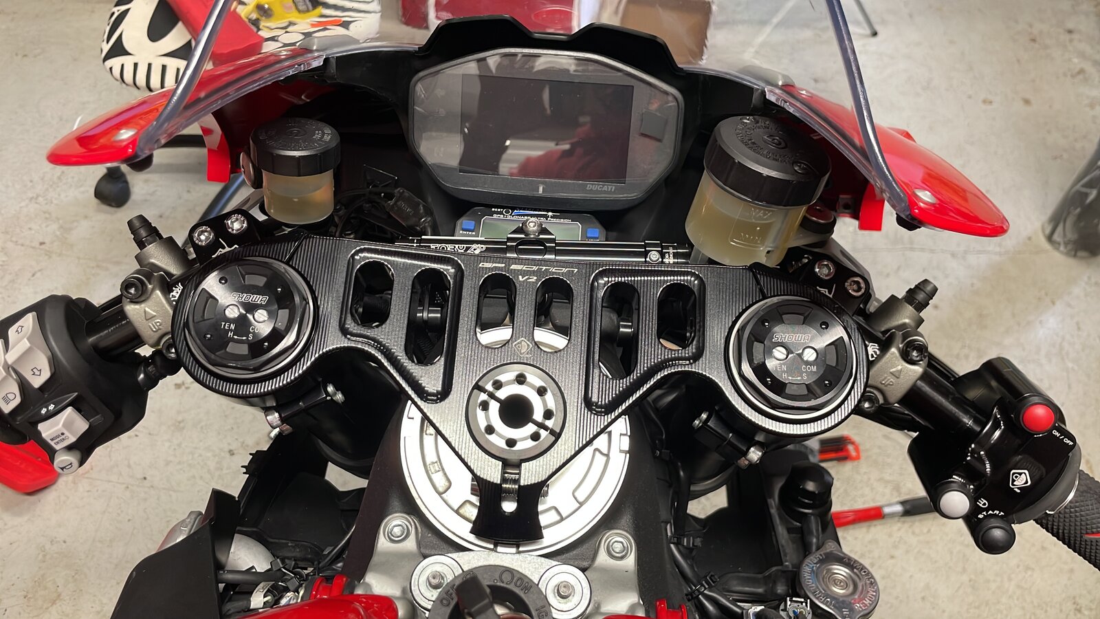

    I fitted a Ducabike throttle switch to my v2 that got rid of the start/kill switch cluster. Not a fan of their stuff normally but their switches are made by Jetprime. So ok. Gives a lot more room on the clip in to position the brake lever exactly where you want it.

  14. Here’s a shot of the space you get with the aforementioned switch.

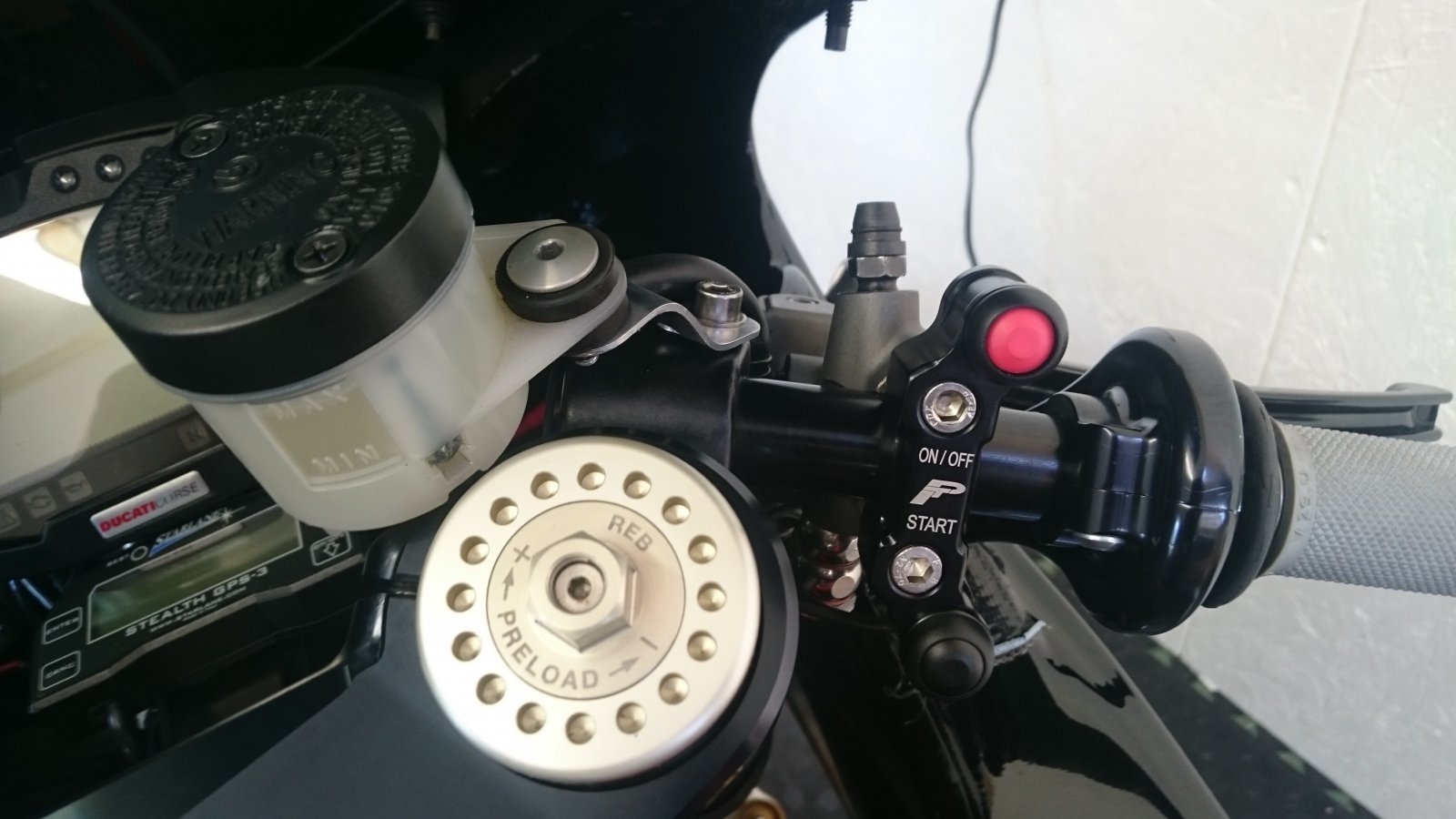

  15. Here’s the one I have. The switches are integrated into the master cylinder bar clamp.
