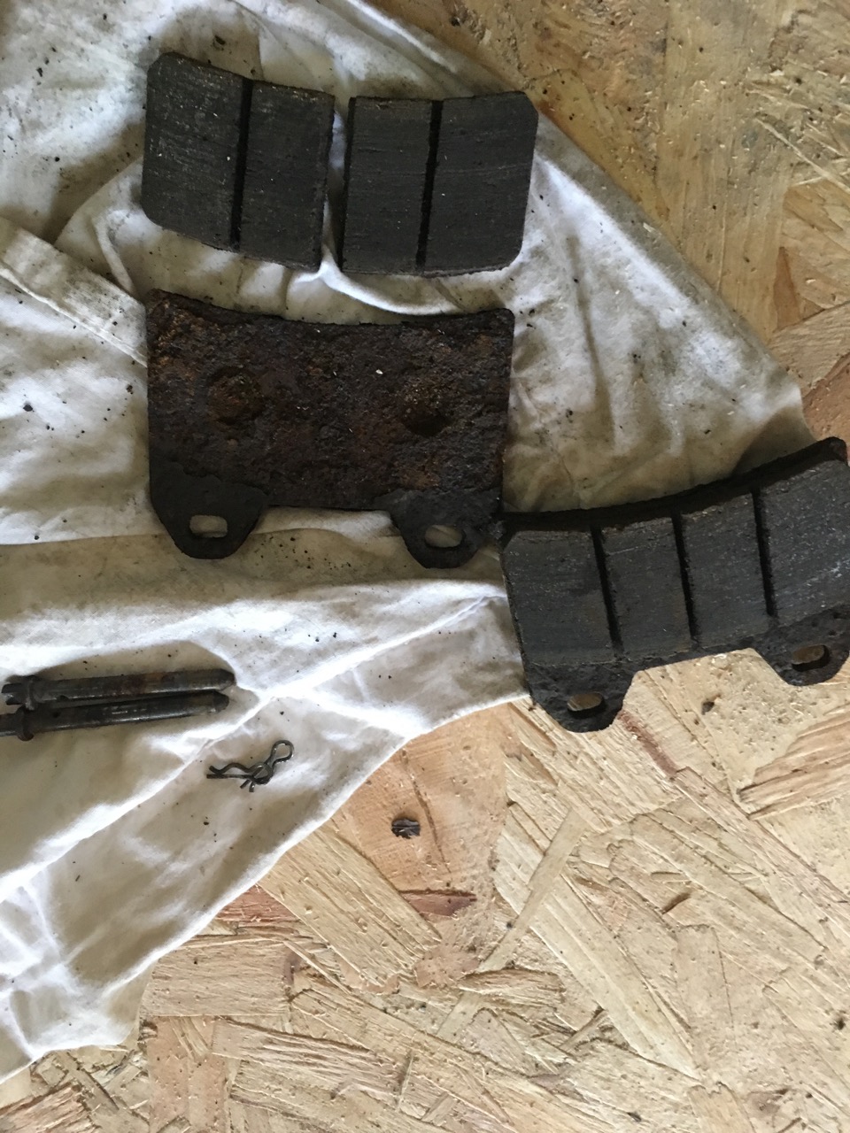

    Q4. Brakes - I'd definitely overhaul the brakes before use. Mine sat for several years and look how they ended up

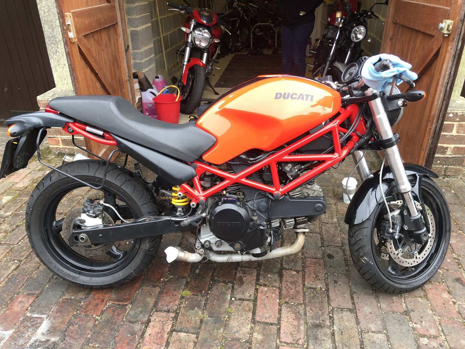

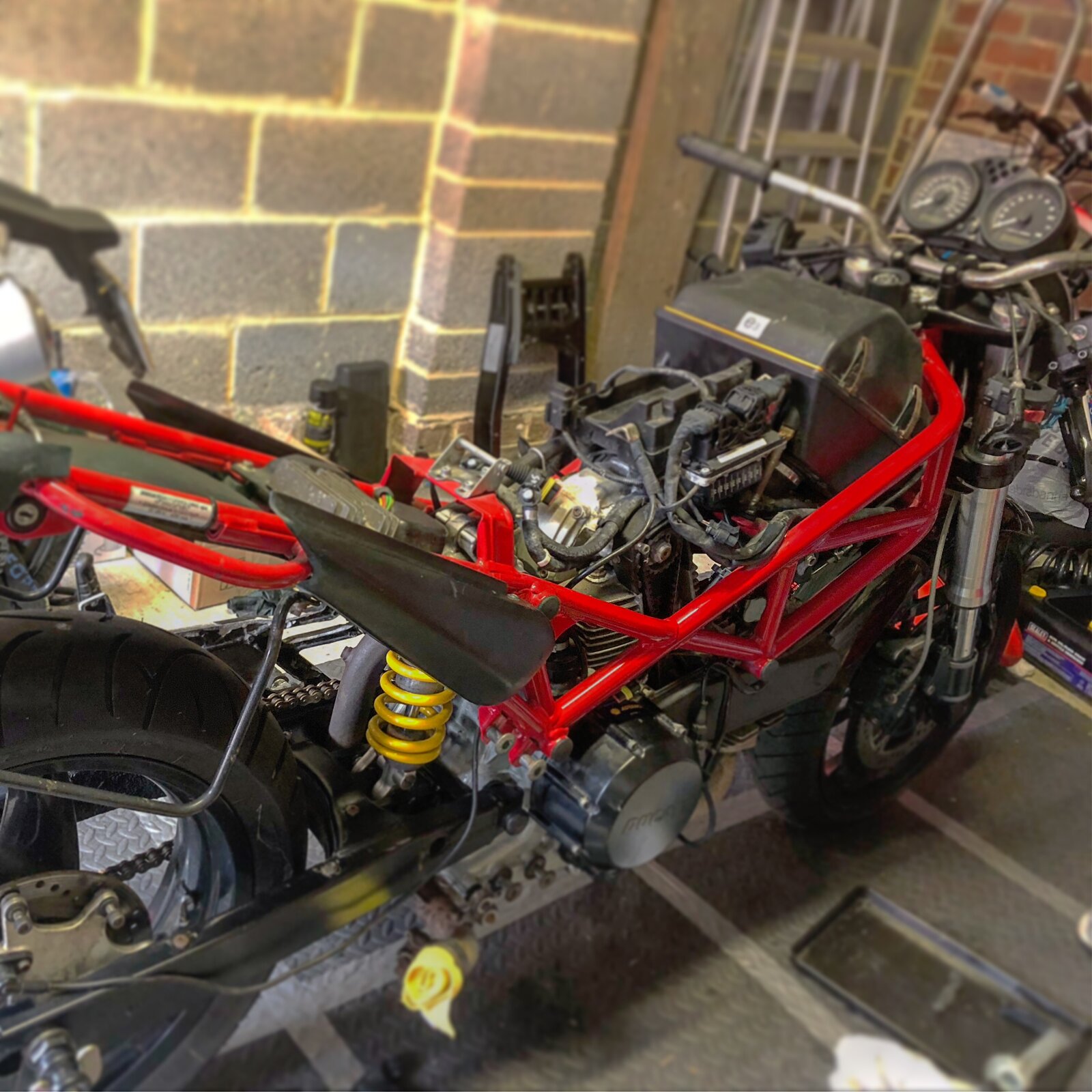

  4. Thanks for the quick and helpful replies! Much appreciated. Here’s a few pics...

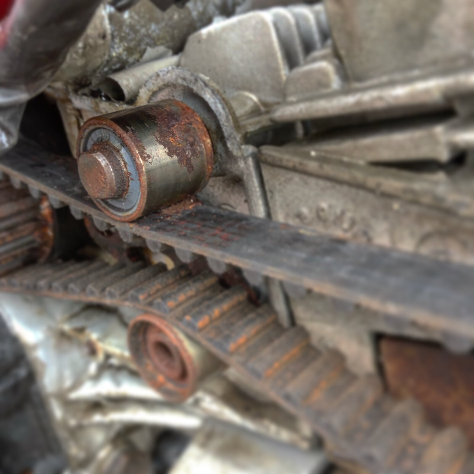

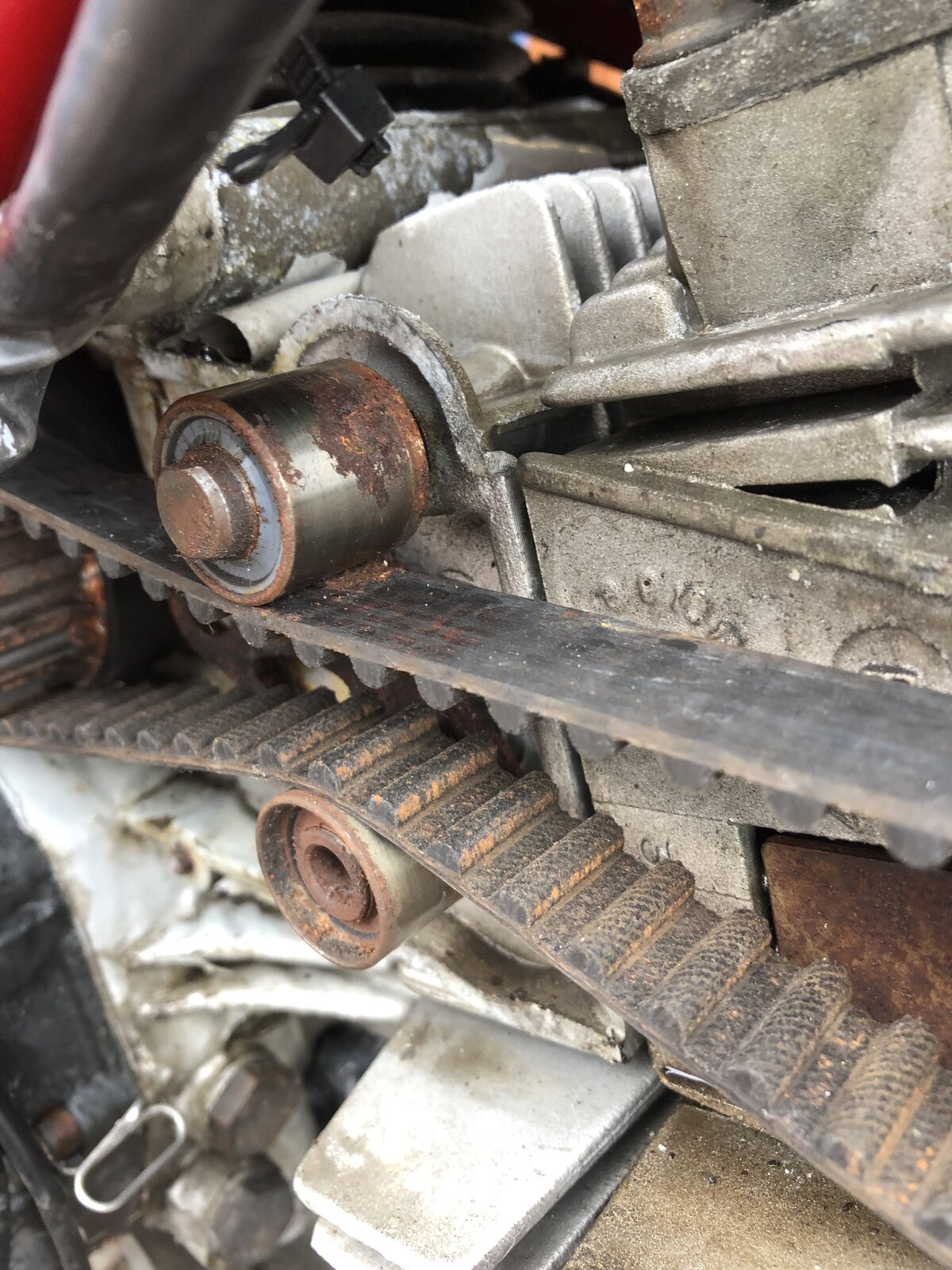

    Note the rusty belt rollers. They spin freely without any grouty sensation so I figured the belts will probably polish them up quickly enough. I’ll keep an eye out. I found what looks like a great app for tensioning belts on belt driven bicycles. It’s called gates carbon drive. It allows you to ping the belts and it freezes on the sound frequency. The 45 degree twist seemed pretty spot on too so seems ok. It’s free so maybe check it out.
    So I’ve just been out and through impatience hooked up the battery and hit the go button (without fuel). The starter sounds functional and the oil is being drawn up from the sump. Fuel pump makes the right noises too. One weird thing I noticed (and I’ll welcome your thoughts) is that when the engine was turning over, large amounts of water was chugging out the right exhaust?! As per the pic that side doesn’t have a silencer yet. I guess it’s just collected over time but I’m led to believe it was garaged!

    Gobs of water out the exhaust is condensation being blown out, normally it would trickle out when you're riding with the silencers on and you wouldn't know, my ST4 sat for a long time and after first start dribble water from the exhaust joints so I wouldn't worry too much.
    I think you should at least clean the rusty rollers with emery/steel wool to save the belts a bit of damage.

  6. I presume those photos were taken when the old belts were still in place and they're not the 'new' belts that went on?
    I agree with Harry above, get out the 240 grit emery cloth and then some wire wool on the roller surface that touches the belts.
  7. Hey! Thanks, yes that was with the old belts and I’ve since cleaned as much of the mank off the rollers! So update... new fuel unions arrived so tank filled and battery connected. Engine (sort of) started. Sadly, not the horizontal cylinder?! Can’t figure out why. Spark works and I can’t see any reason why the air wouldn’t be getting in. The only other thing I can think of, is that fuel isn’t getting in?? Any thoughts anyone?
