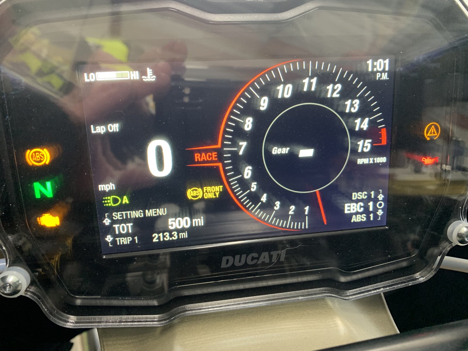

Not even got to the first service..500miles in and the QS/Auto blipper/ gear indicator has packed in :-( When it was working I noticed that between some gear change up shifts there is a noticeable delay in shifting...it’s like you are rolling off the throttle..so it cuts the power for far too long..it’s not slick at all..is that normal? Not gonna lie it’s annoying..but not as annoying as the whole thing dying now!
Take it back to the supplying dealer to sort out. Early Panigale V4’s had a software upgrade after some owners had QS problems. Not suggesting it’s the reason for your problem but I wouldn’t have attempted to run the bike in, in race mode. Andy
I’m assuming this a MY21 or 20? If so it’s a bad do from Ducati. There have been QS and gear position sensor issues since it’s launch in 2017. I changed the QS on my MY18 V4S for an after market H&M job. Tbf the OE QS on mine was holding up ok but I was hearing about plenty of failures. The gear position sensor did fail on mine. But good old Neil at Cornerspeed replaced it under warranty. As their failure was heat related (bolted to engine case), I think Ducati improved the design. If it’s the gear position sensor, make sure you get the latest rev. They have different part numbers.
The OE QUICKSHIFTER IS CRAP HAD MINE REPLACED THREE TIMES ON MY 1299 , last one seems to be holding up .
Yeah mine was replaced last year! QS changed up ok, it just would blip and go down. Also caused bike to stall twice for no reason... Now on the newer latest version. Smooth as butter up and down with zero stalling. It’s a known issue apparently. Unless your taking it too MR who apparently mentioned they haven’t ever changed a faulty one, or heard of any such issues. Oh and blamed my Rearsets on the issue!.... Hopefully you get it sorted soon
It’s 2020 V4 Well apparently there’s a recall on the bike for this which was issued late last year and I wasn’t contacted over it The dealers sorting it out next week. Still not good from Ducati being a known issue. Does anyone know anything about an evo 2 software update? Was told by another guy that it transformed his V4 and was well worth it? His was a 2019 bike though so not sure if that’s the same case with a 2020?
