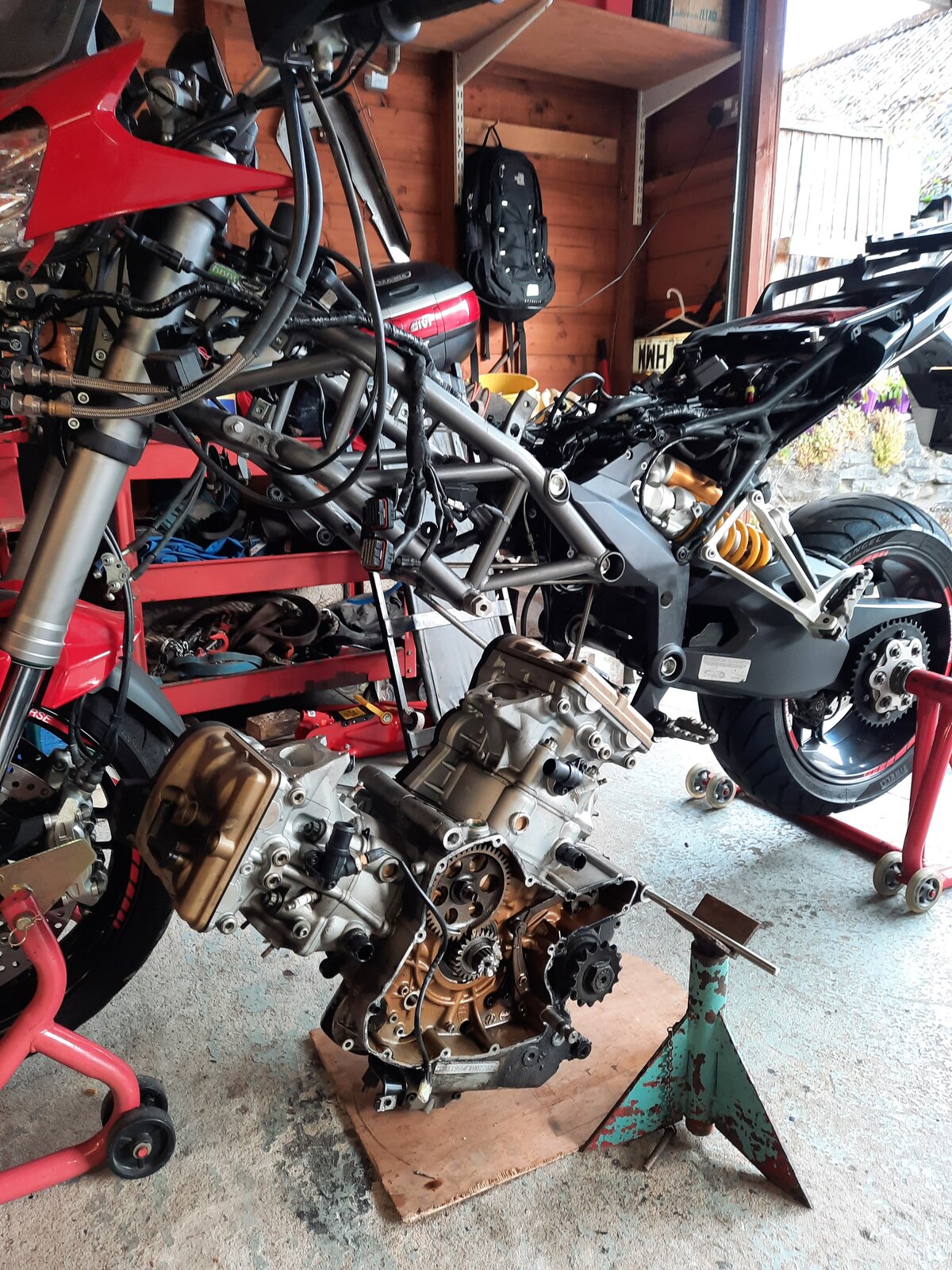

  7. Engine out ready for Ducati to examine, been on to Ducati and they need to see the engine and determine what caused the crank to break.
