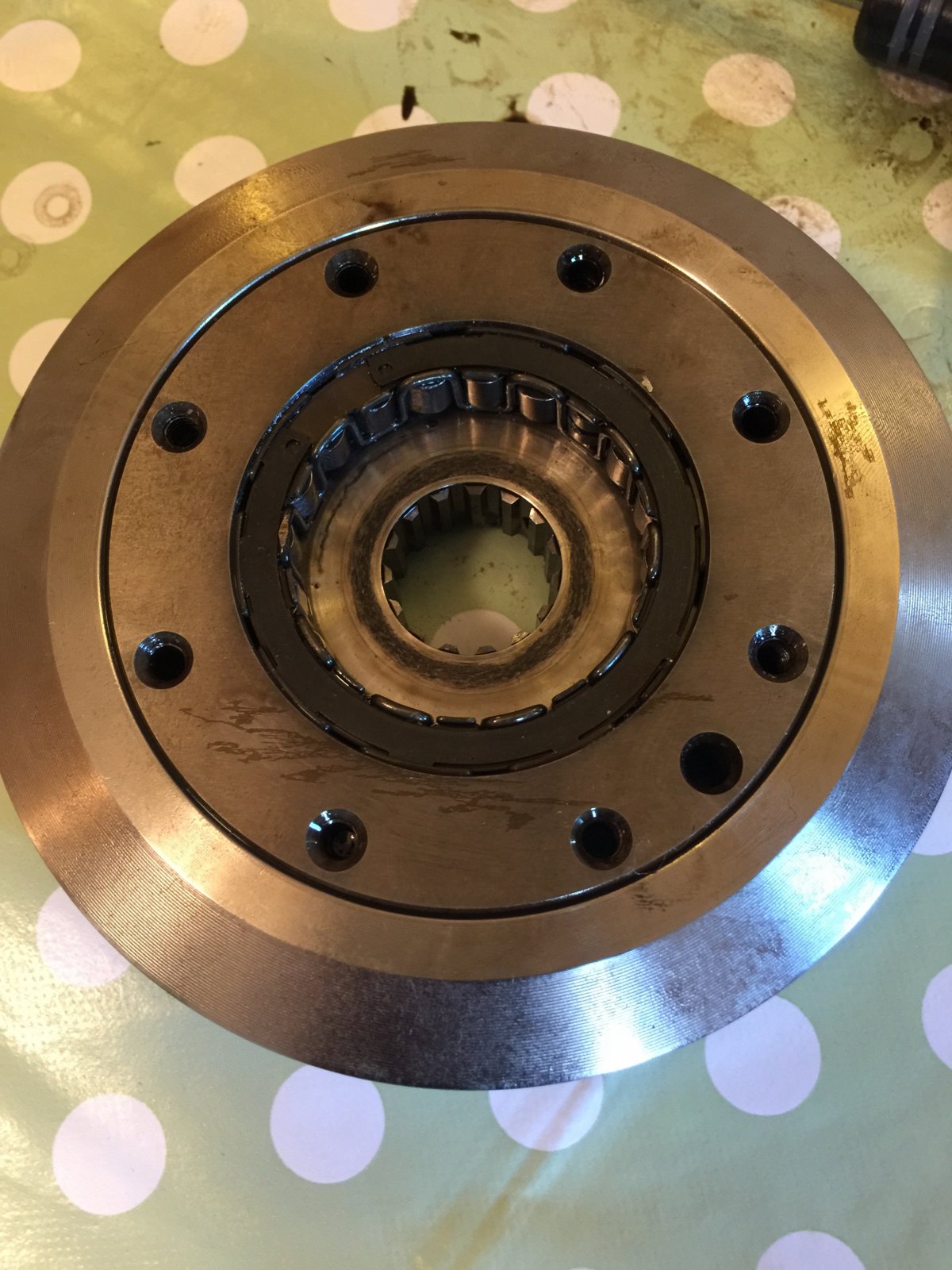

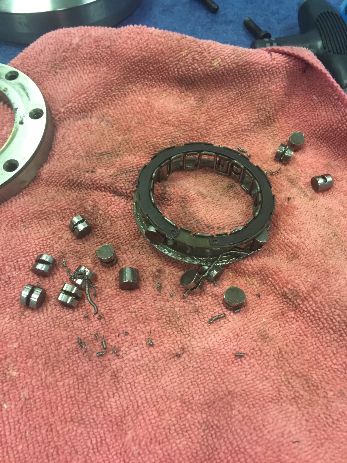

Firstly just wanted to say thank you to all the guys and girls on here who gave me very sound advice over the last month or so, it is surely appreciated and in fact far more helpful than any dealer has been in my 17yrs of riding. Saying that , for all those newbies or lucky folk with no sprag issues I have attached a pic of the mess I was greeted with when I cracked the flywheel apart this evening. Some times it's just handy to see what your looking for as my flywheel assembly did not look too shabby at first glance . Looks are however deceiving ! Let the rebuild begin! Once again , many thanks for the help and advice , I hope that my skills improve and can return the favour one day very soon . Andy

Just goes to show how important it is to have a healthy battery and starting circuit. Not just for instant starting but for a healthy sprag...
