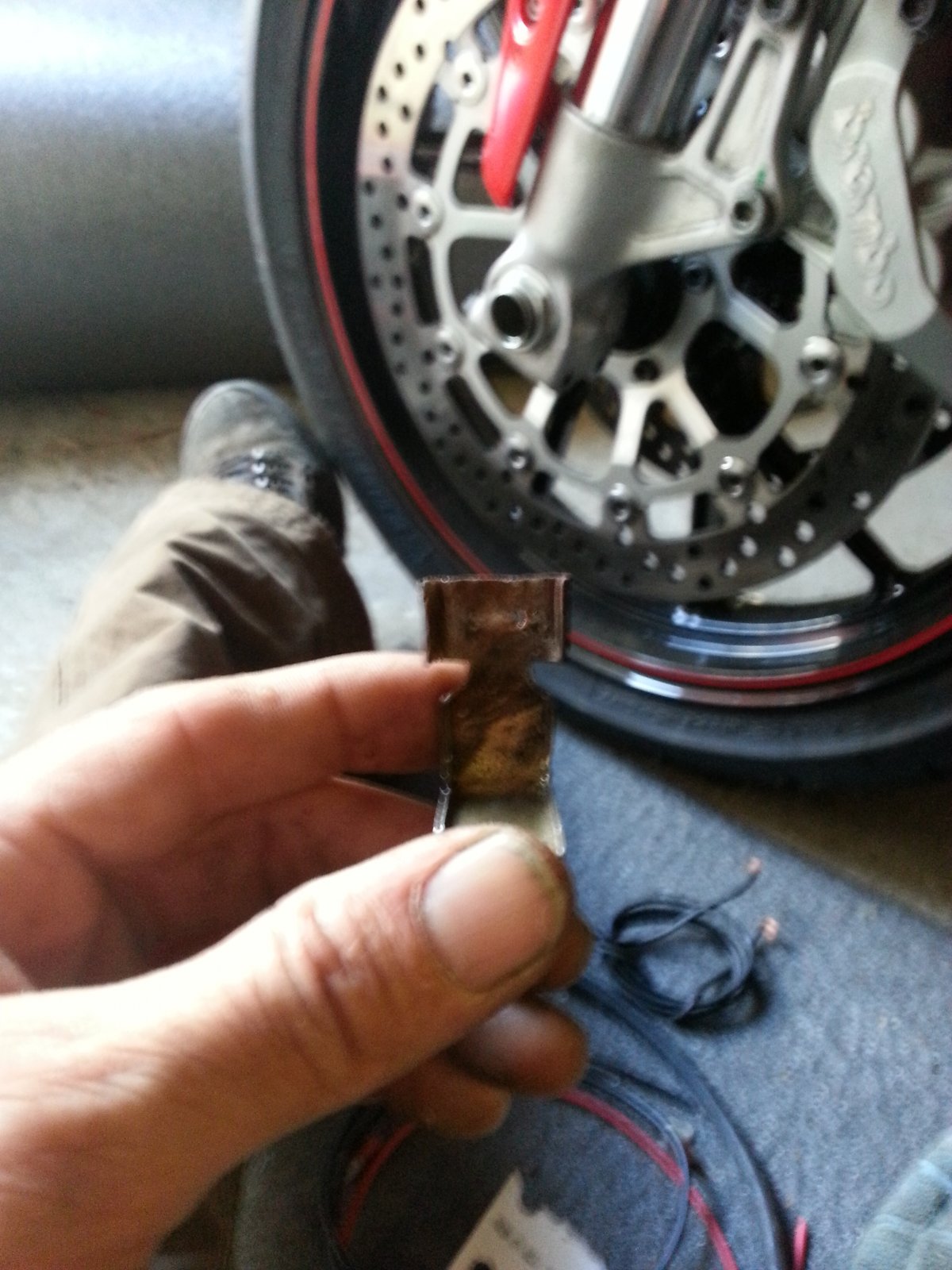

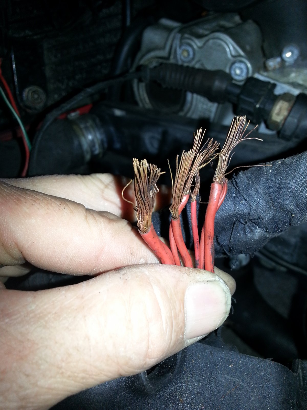

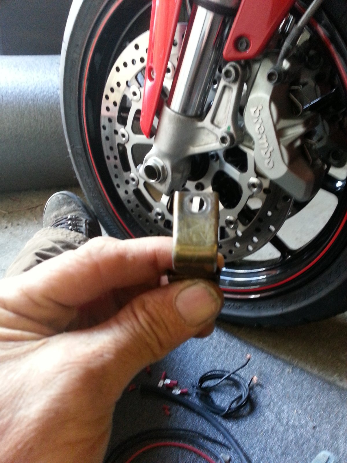

  14. Hi
    Just thought this might be helpful , it's from something that happened to my 749 .
    Did you notice any voltage fluctuation on your display ?
    I had a very similar problem that ended in my bike not restarting .. when i was riding the voltage would fluctuate down as low as 11v from 13.9v .
    we ( wife was on the back ) pulled into a little pub for a drink , upon coming out .. ignition on but voltage was showing just 10.8 v , hit the starter.. nothing just the voltage drop passed 9v and then show lo.. so whats your thinking.. battery died.. rectifier etc .
    finally got it home after i got jumped started ( which took ages to get it to catch) as it wouldn't even bump start !
    Got the battery tested .. fine went through all the wiring with multimeter without finding any obvious fault , borrowed a rectifier and solenoid from streetfighter900 .. still the same .
    battery showed 13.9v with ignition off and a small drop when switched on at the battery .. yet the bike showed lo soon as i turn ignition on , at the solenoid it was still 13+ v with ignition on yet the bike showed bugger all on the display, even had glen at moto v scratching his head on this one .
    Cutting an even longer story short , i did find the problem .
    The main terminal that goes to the positive side of the battery look fine .. from the outside !
    I first noticed even with just the ignition switched on the terminal got hot to touch , so i removed the terminal to have a closer look .. didn't look bad from the outside so i split it open .. the wires inside ( there are quite a few go into the terminal ) were terrible especially the small ones .
    Basically i think moisture gets in there and it can't get out so the inside of the terminal rusts losing connection with the smaller wires they start to arc causing the heat and losing strands at the same time beginning of the end of that, as it only get worse until fixed as the strands become less etc .. and sending the bike into thinking .. no voltage don't start !
    i stripped them back to good wire got a capsule end from local motor shop soldered them all in there .. job done running like a dream .
    pics attached of what i found .
    maybe something to look at , maybe of some help :)

  17. No probs , just thought it might be worth checking out while your doing stuff to it [​IMG]
