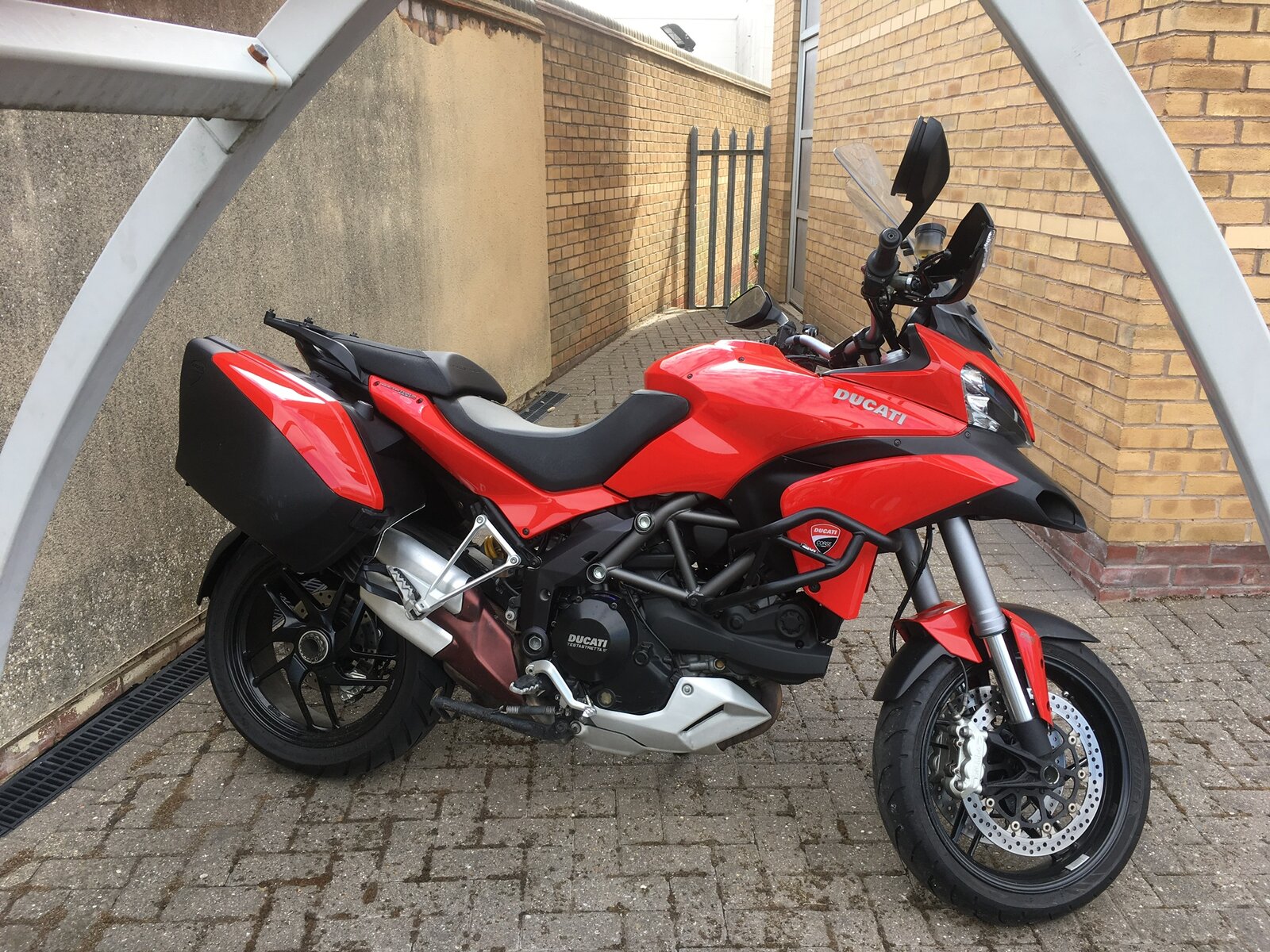

  1. Among the random pile of bits I got with my bike was a bronze coloured exhaust heat sheild. Not sure if I prefer the black or bronze but can anyone tell me about the bronze one. Is it some sort of special edition "feature" or just some bolt on bling.
  2. Throw up an image of it please
  3. Like this you mean? That’s on a 2013 touring s if it helps,
    Mick.
  4. I had the same heat shield on my grey 2013 GT which was written off ..... the replacement later year (built 2014 but registered 2016) red GT has the more usual black coloured heat shield

  6. It seems it is a standard Ducati part as when i had new tyres recently its Duc branded inside. Never thought about it but i was chatting to a bloke on Rutland Water recently with the same year bike and his was black, not sure what that means though!!

  9. Mine was this colour. I'm pretty sure it started life black and discoloured over time with heat. I had it re anodized black and it has been fine since
  10. Mine went from black to that colour , I think it's a time & heat thing.

  15. They are black when new but turn that colour due to the intense heat of the exhaust. Strange but true...
    I restored mine with high temperature paint and that works well but as said your boot can still scratch it off as I've done
  16. It was black when new but has "bronzed" over time , sand with 120 grit and respray with a flat black exhaust header spray bomb paint , which will probably require 3 heat treatments in your home oven [ mine was 250C , 400C and 550C at 30 minutes each , but results in a reasonably strong paint that will stay black .
