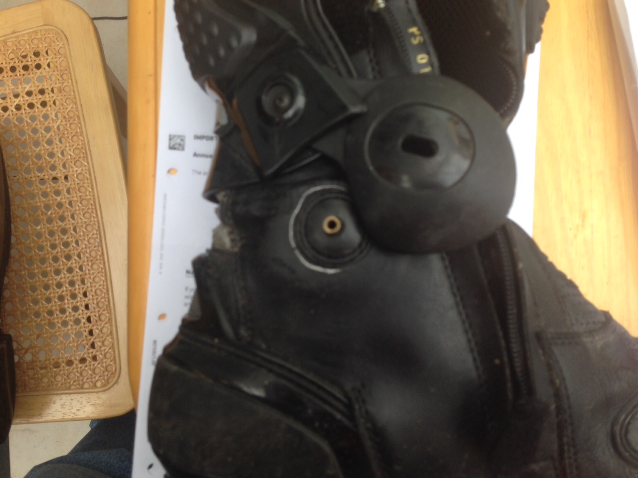

    Firstly my bloody Frank Thomas boots lost a plastic cover on the ankle protection exposing a copper bolt which has scratched my frame!!!! in a word BUGGER!!! remedys anyone??

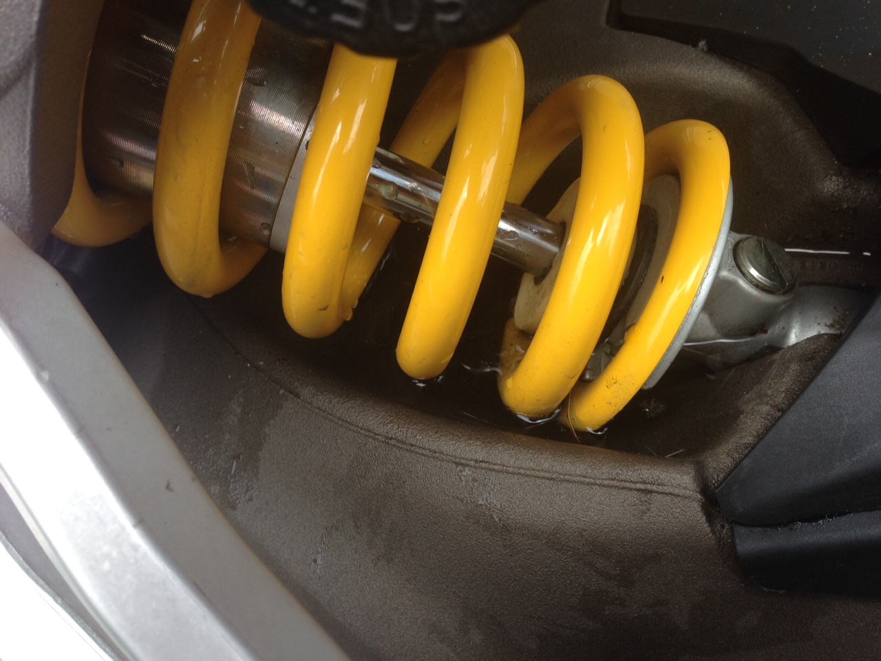

    I think this last one has already been covered but the base of the shock makes a nice litte bird bath as traps water...a lot of it, in the end I used our vaccum cleaner to suck it all up, (divorce pending unless I change the soggy bag!!)

  2. I feel your pain regarding the frame Franksie. My choice of repair would be to get a colour match from an auto paint supplier, I would definatley go for 2K paint (usually 50/50 paint/hardener +10% thinner mix). Don't add the thinner though (that's for spray gun use), then dab it into the scratch (dapple effect to match, a couple of applications should do it:)

    Reading other posts about the puddle the shock sits in state that there is a small drain hole that can block...

  10. The last picture is some water sitting near the suspension ? Actually there is a hole around there to water to go down I think your one must have blocked ! I didn't have that problem.

  13. I looked out for the 'pool' when I washed my bike today and, yes, it does fill up. I didn't find a drain hole so pumped the water out - I will have a closer look for the hole tomorrow ;)

  14. Took mine in to the dealers for its long overdue first service and they said there isn't a drainage hole!!!!!! I, certainly couldn't find one so intrigued to see where it is"
