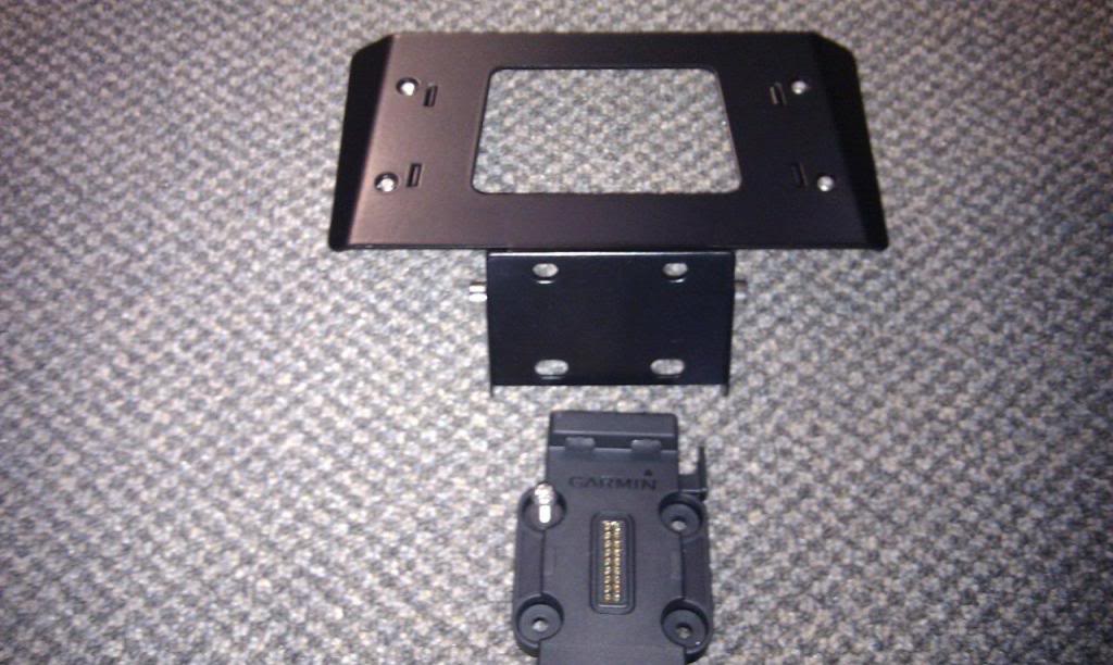

  1. I have had a couple of people ask about the above dash Nav holder
    The navholder mount is only available from Germany but ships wordlwide
    Navihalter Motorrad, Ducati Multistrada 1200 - Artikeldetailansicht - Online-Shop
    Thanks to Humpo from US site for the easy fitting instructions I have listed here
    1. Mount sat nav bracket on mount
    2. Remove screen
    3. Mount bracket with bolts facing down to windscreen slider bracket, nut lock bolts
    4. Run cable over the back of mount, down to the left side of the bike.
    5. Remove the black cover next to the wing on left side of the bike.
    6. You will see a white plug with two wires going no where. This is your GPS power. Test for + - and solder connections.
    7. Test and replace side panel.
    8. Check angle and hight of unit. There is 3 different mounting holes. I like the centre one.
    9. Replace screen.
    AndyW has some great info here
    Ducati Multistrada 1200 - MTS1200.info redirect

  4. The screen bracket is not very meaty, what is it like with a sat nav on it, does it bounce about or is it secure ?
    There were a few on ebay when i got multi, but missed out on both, and had enough RAM bits to sort
  5. I find it very stable. The fixings ensure it doesnt bounce around.

  12. The Garmin mount for the 350 has the same 4 holes in a rectangle mounting system as that of the 660 so should bolt right in.
    It's the same on my old 2610 so I'd say it's unlikely that Garmin have changed the spacing on this one.
    Why not ring a dealer and ask them for the measurements or to compare it to a 660 to be 100% certain.....
    Even if it's a bit off, 2 minutes with a small drill and it would definitely fit!
