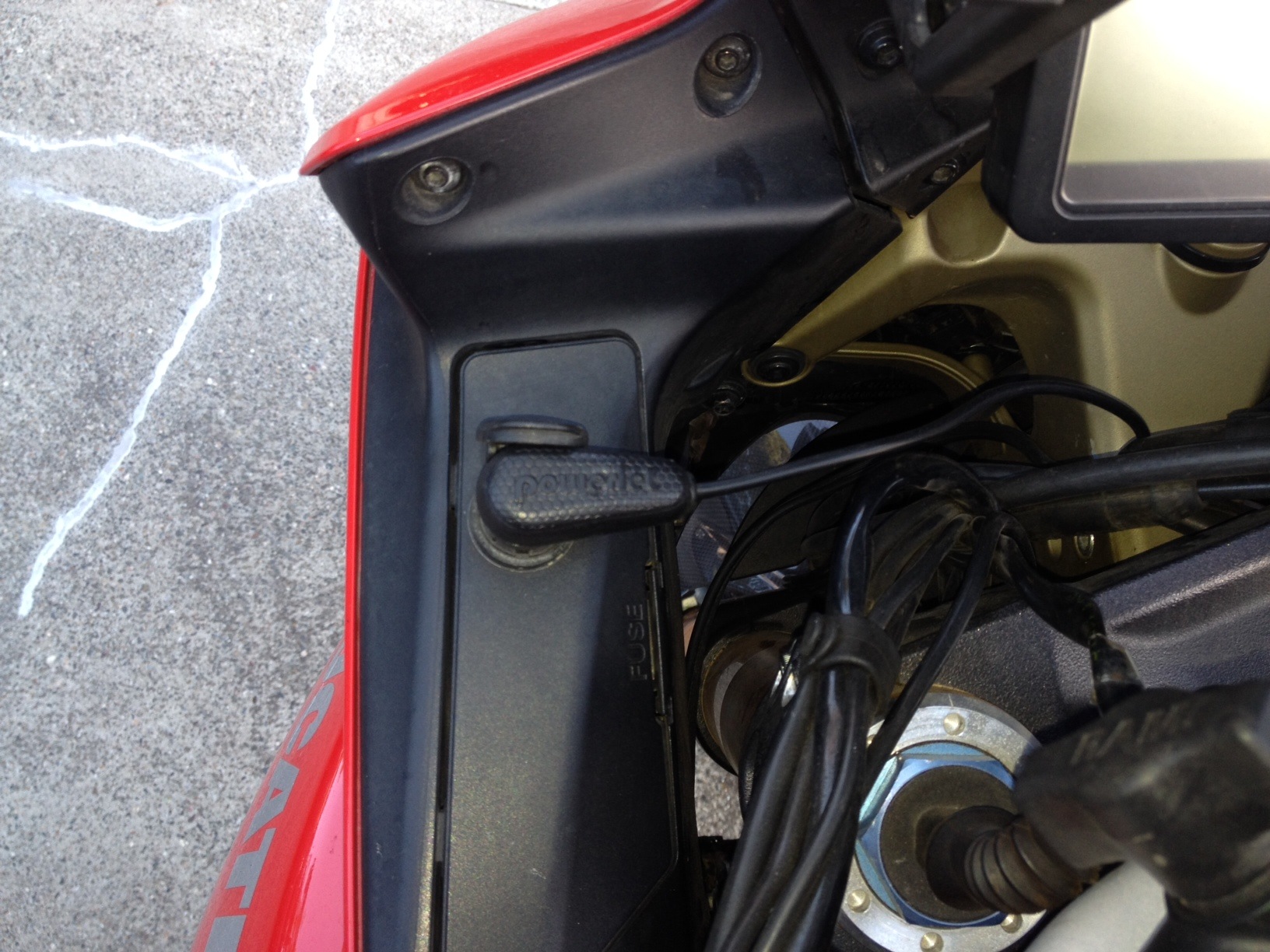

I went with these and added moved one of the stock din plugs up to the front fuse cover. Powerlet Low Profile Plug to Apple 3G-4s 36" Charging Cable - Powerlet Products RAM Apple iPhone Mounts (RAM-HOL-UN7BU)

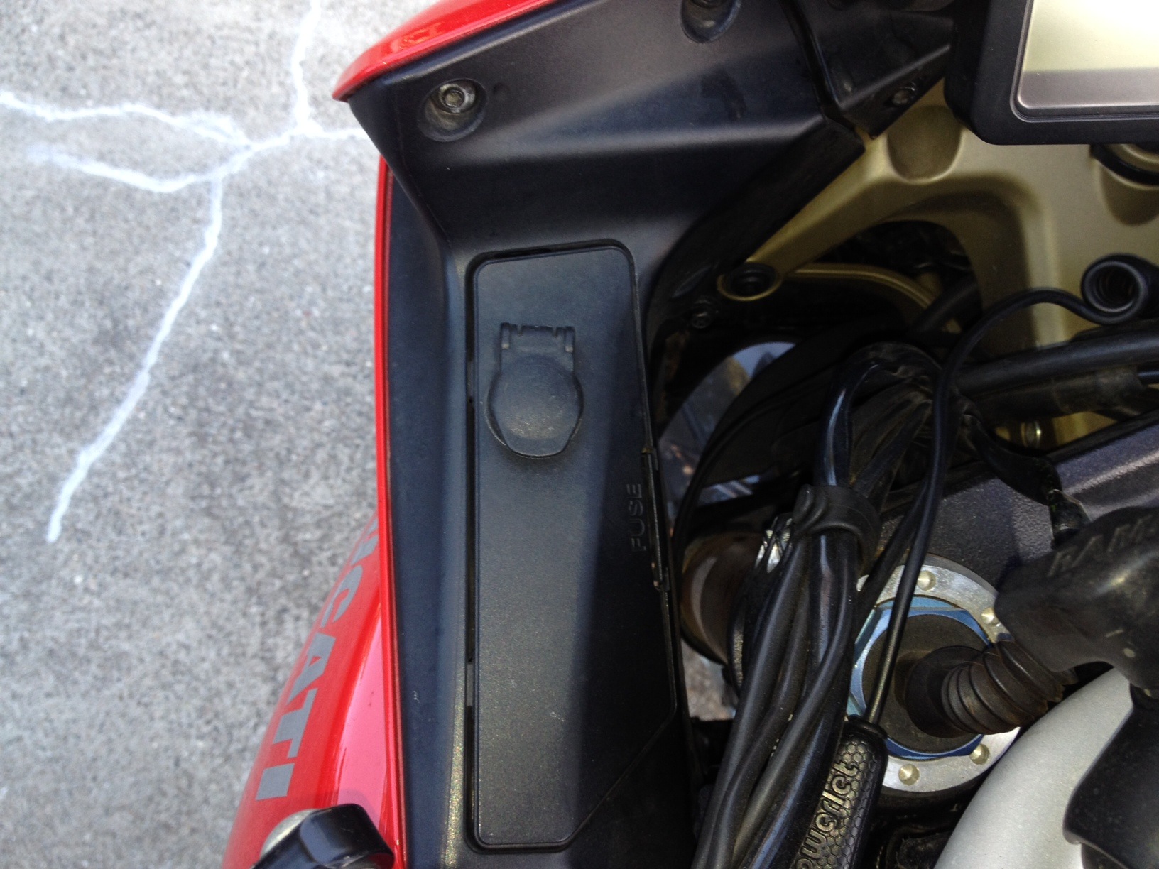

Figaro, the power outlet shown is one the stock ones which come with the bike, that I R&R'D from the rear. It would be nice if Ducati would put one up front, as now I have to do it again with the 2013! You can order almost any plug configuration from Powerlet.
