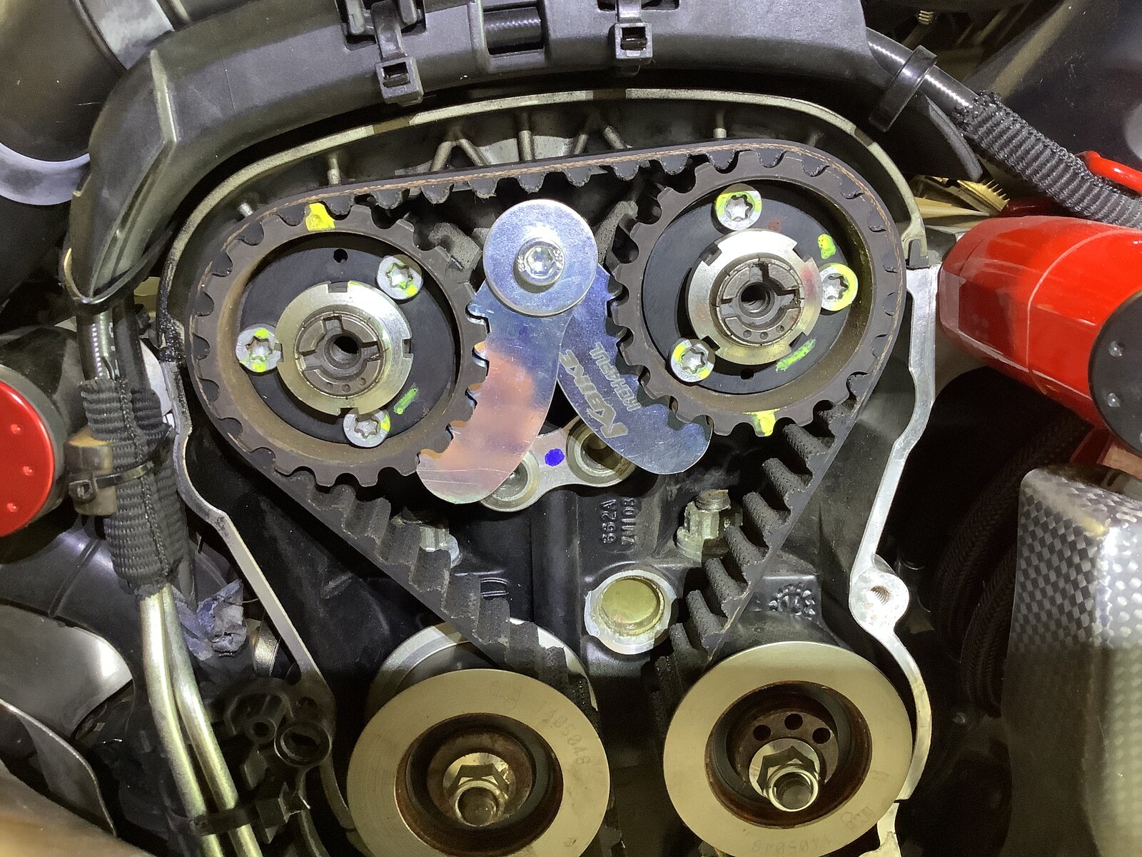

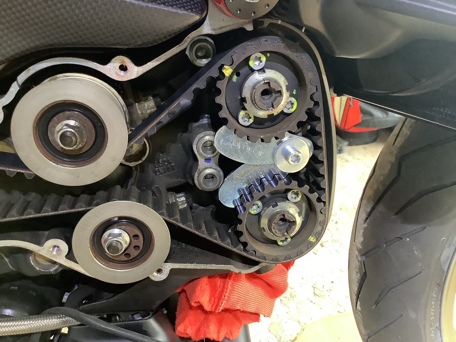

  1. I’m in the process of changing the belts on my 2015 Monster 1200s,I have the covers off and the old belts still in place with the cam pulleys locked up with a pair of locking tools,as nothing now can move is it simply a case of fitting the new belts and tensioning them?
    TIA
  2. Is the horizontal cylinder at TDC on the compression stroke?
    Have you got a workshop manual or looked at any YouTube guides?
  3. Yes, but make sure that every thing is in the correct position. The dot on the bottom pulley should line up with the line on the engine casing. And mark reference points on the cam pulleys and and adjacent points on the cylinder heads to be sure.
  4. It should be and the vertical cylinder will be halfway down the inlet stroke with the valve fully open.
  5. Thank for your reply,don’t have a workshop manual,yes I have watched you tube videos,I have the vertical cylinder at BDC,does that mean the horizontal is at TDC and how do I know it’s the compression stroke,sorry for my ignorance but it’s the first time doing this
  6. Line up the dot on the bottom pulley with the line on the engine cover and everything will be in the correct position. Then lock the cams and mark them for safety. Then you can change the belts.
  7. Very small centre punch mark on the bottom pulley now lined up with the notch on the casing,locked in place,should I worry about anything else being lined up?
  8. That looks good. Interesting cam lock tools you have. Where did you get them?
  9. Kbike in Italy,35quid delivered,had to use the Dremel on one of the slots to line up with the mounting hole,nothing moving anywhere with them in place
    thank you so much for your help
