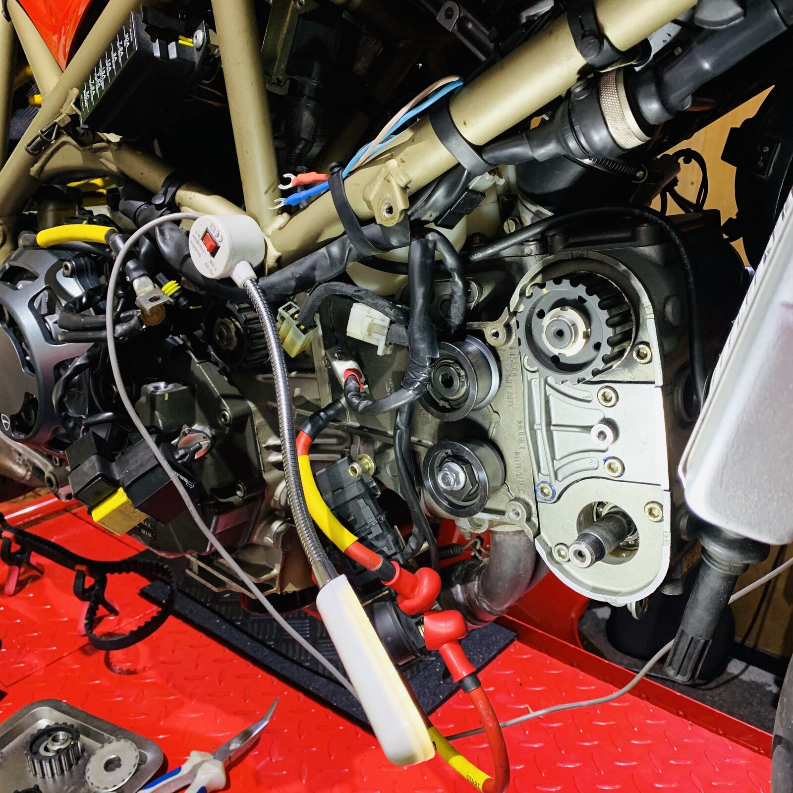

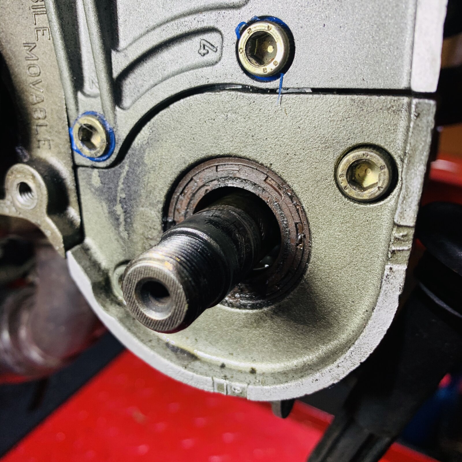

  1. I would like to share my findings and solution in reassembly A camshaft pulley oil seal.

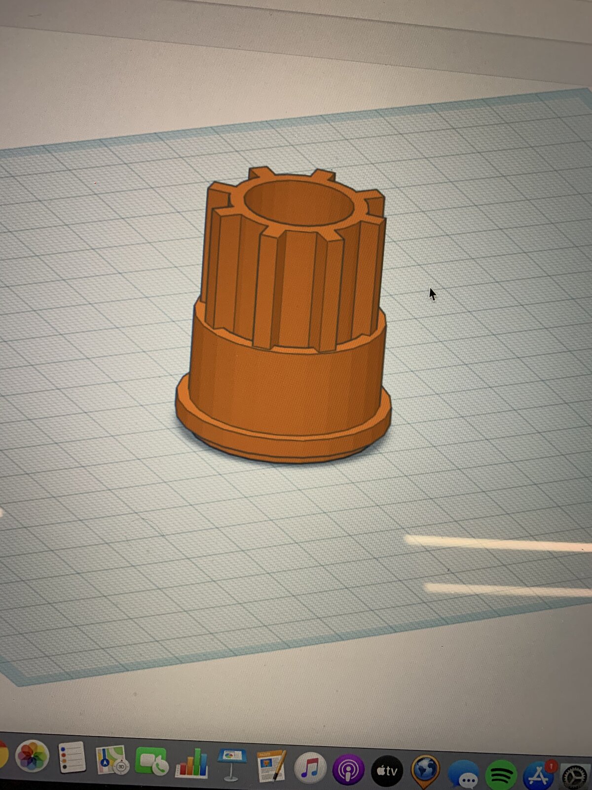

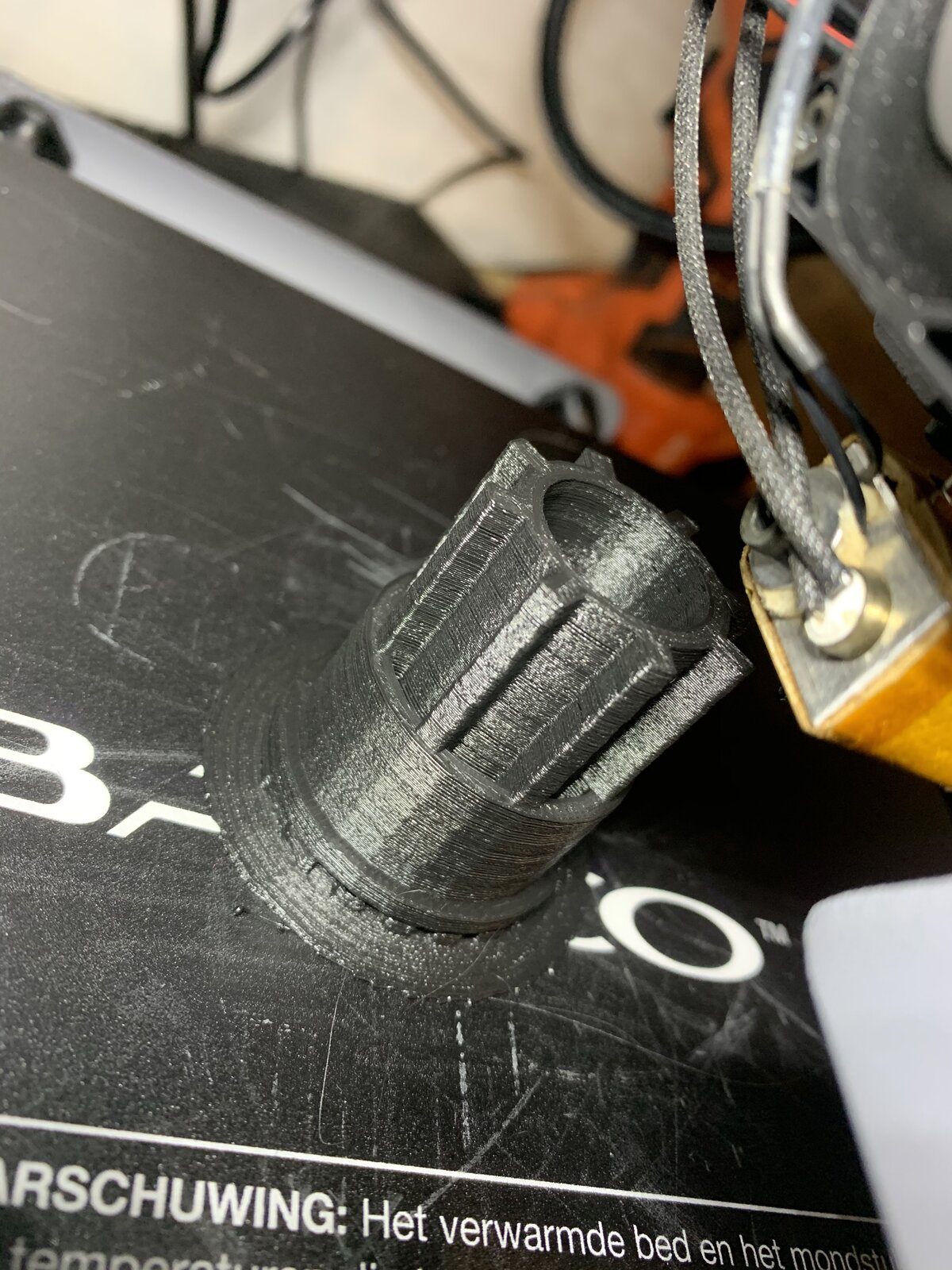

    The 3D printed ‘seal guide tool’ became very handy :)
    I can share the STL file I somebody would like it.

  2. Is that guide to bang the new seal into place? How do you get the old one out?
