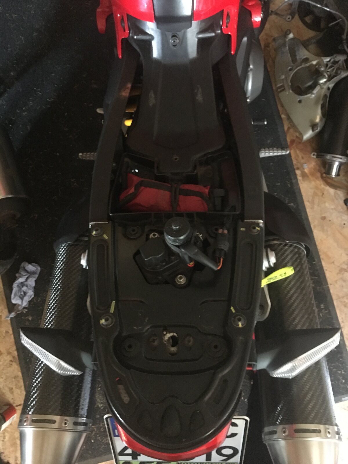

I took the cover off the battery bay. I can see the red battery post but not the black. Can anyone tell me how I get to it?
You can see the live feed - on the other side where i guess the negative / black feed is there is a big plastic electrical block that has fuses etc. How do you get to the negative though so you can attach an eyelet connected to a cable?
There must be a faster holding the fuse block in place? Will it not lift off once the faster is removed?

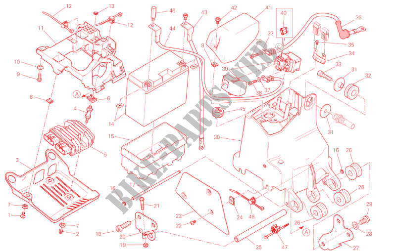

I couldn’t see the bolts to unfasten it. Item 9 seems to come up from underneath but I couldn’t see it from on top - how do you get to it? Can you see more bolts holding that cover down? Sorry to be thick. I’m sure it’s really obvious
TBF it looks like an appalling installation - it will be in your manual however, this link to a base model maybe the same: https://www.manualslib.com/manual/1097237/Ducati-Monster-1200.html?page=226 Have fun
I think I’m going to give up with it and just stick an SAE connector on the end of my garmin power cable. I’ll use the optimiate lead installed by the dealer/previous owner for charging when the bike is parked up and then plug it in to my Garmin lead when out on the bike. Shame really as I’ll have to take off the seat every time I park up at home to do the above
Yeah seen that - he drops the battery out the bottom. I tried that and failed - could persever I guess but seems a lot of work just to get to the negative lead
You have to get underneath the bike to release the battery holder and drop the battery out from under the bike . I'm not sure Ducati could have made it any more inaccessible. Jump to 1 min in and watch from there.
