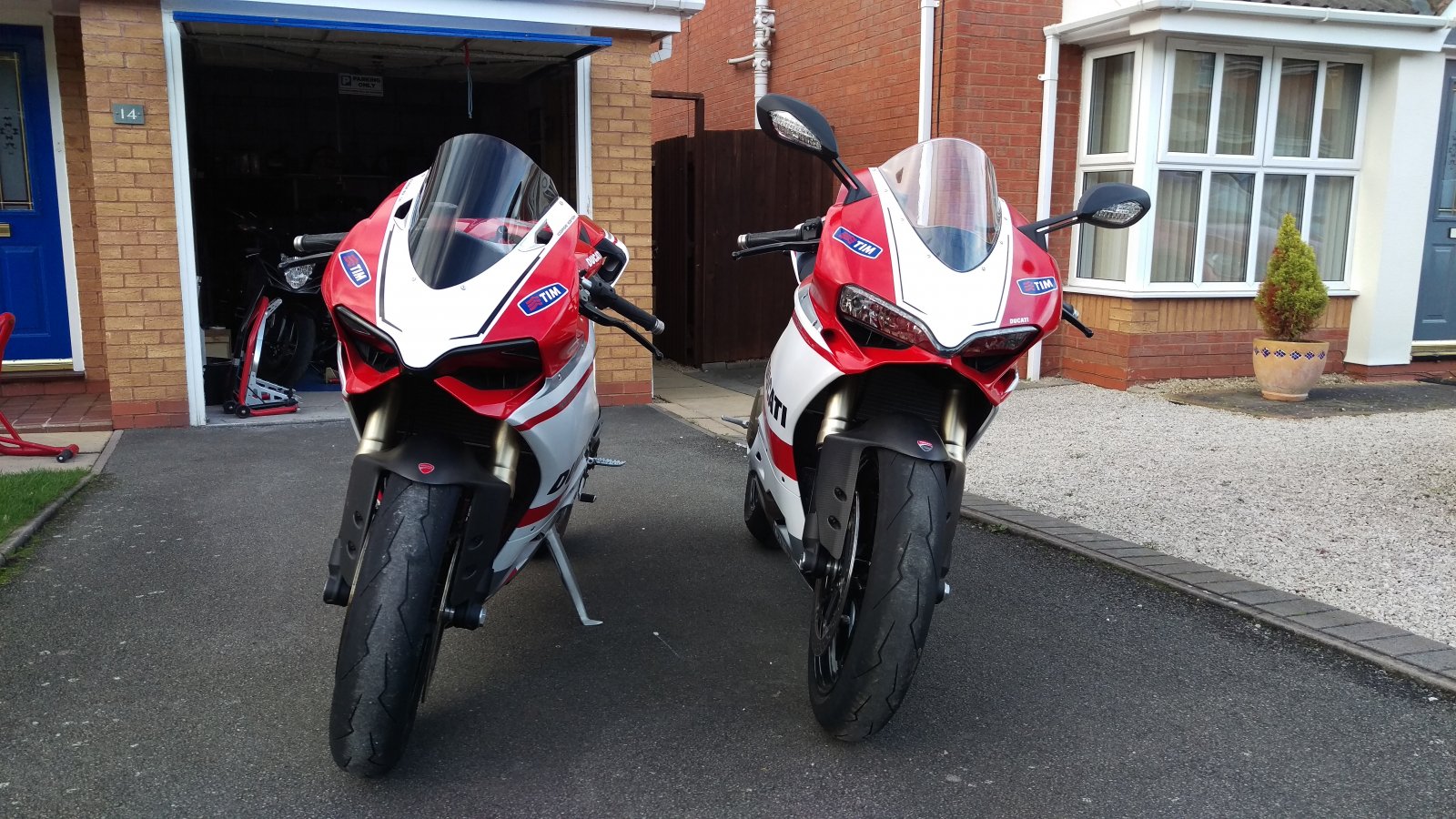

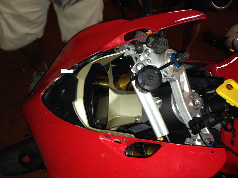

  5. Yo
    I've got both 1199 and 1299 and just removed both fairings for painting.
    The nose fairing mounts are different because of the mirror mounts.
    The sides and lower are the same.
    As you can see the 1199 mounts run along the screen edge.
    The 1299 run outwards.

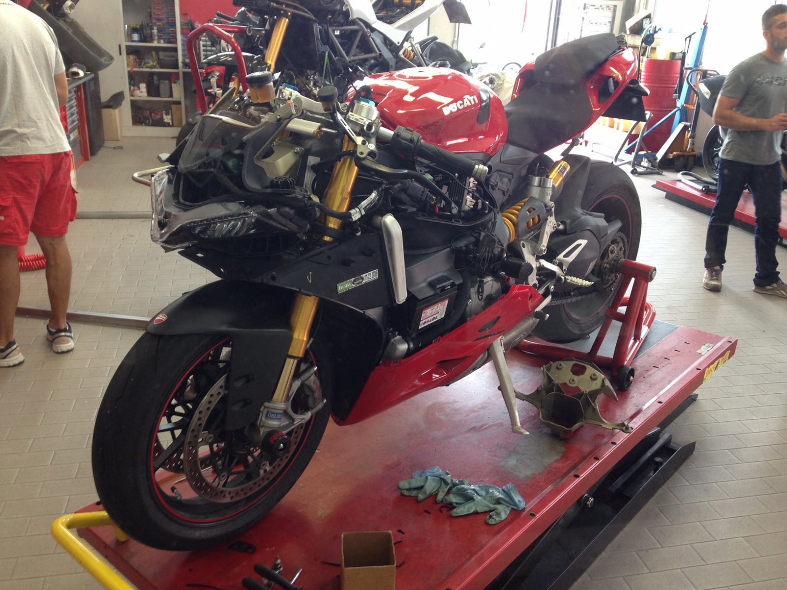

    Prefer the fact they fold back. Dealer told me he pushed one once perhaps to hard but it broke the mag bracket, nose cone flexed so that was fine.
  8. I was thinking the same when I first saw the 1299 mirrors as I pretty much permanently have them folded forward in London traffic on the 1199. Same thing happens with the 1199 mirrors anyhow mind. I dropped the bank on a very slow hairpin in the Alps and luckily my luggage saved the bike from any other damage but the mirror snapped off at the bracket mounting point so I had to get a new nose bracket fitted in Bologna a few days later. Very annoying for such minor damage, but a handy excuse to visit Borgo Panigale :)
