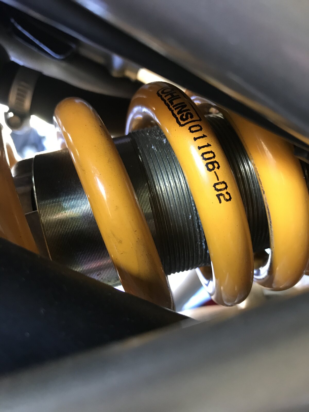

  1. It’s on my 1000ss DU010 shock and it’s too hard. I’ve searched online for a clue but not much info available in relation to this reference number.

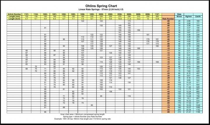

  4. it's a progressive rate spring many folk who race DesmoDue change to a linear rate spring
    you could send Mark hammond at mh racing in Wiltshire an email . he will tell you definitively what that spring is and your options for changes
