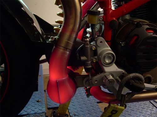

can someone please tell me why this 848 evo has red inside the pipes? is that from the heat of the exhausts? how come my 749 doesnt have red inside? i want red inside! Ducati 848 Evo - Termignoni Flamethrower - YouTube

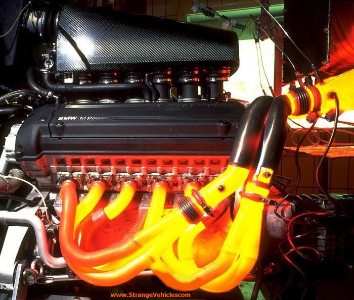

No cats in there there straight through . The answer is they all do that its lots of heat and very little cooling . Outside theres lots of air cooling things down so not so obvious but in the dark it will still be seen. When my 9R was dynoed the pipes coming out the cylinders were bright red. The best I have ever seen were on a generator working full chat the whole manifold turbo and pipe were glowing bright red. Heres a couple of internet pictures of some good ones .
Carbon cans will contribute too, as they are vastly better insulated. (Ever notice how they always remain cold to the touch?) that heat has to go somewhere -edit- just watched the video and those aren't actually carbon, but the heat theory still applies, as they aren't in a cooling air flow.

the red inside the pipes is the glow from the cats, the flames are caused by un burnt gas. the red from the cats is perfectly normal.
