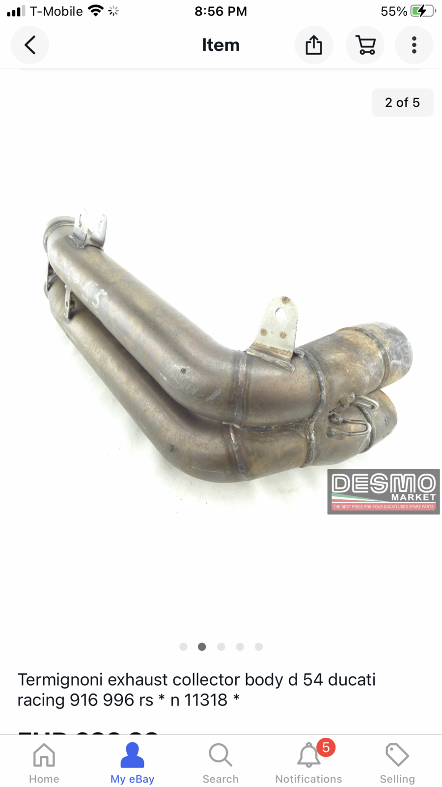

    In a fit of low blood sugar I bought the wrong termi link pipe (inlet/outlet much too large) which I cannot return. Yay for me!
    https://www.ebay.com/itm/Termignoni...=p2349624.m2548.l6249&mkrid=709-127639-2357-0
    Could I hand my standard link pipe and this termi unit to a skilled welder/fabricator and ask them to create what I want from the 2 units?

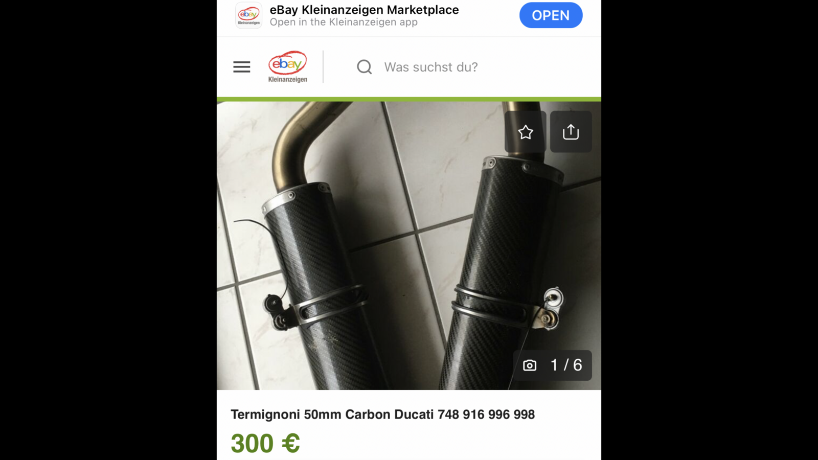

  11. Thank you @DucRider for finding these bits. Good lord trying to buy something on eBay Germany if you aren’t in the EU is rather like herding cats. In the end a friend in Germany had to buy the parts on my behalf and is now forwarding them to me.
    Thank you @West Cork Paul for all of your offline efforts as well.

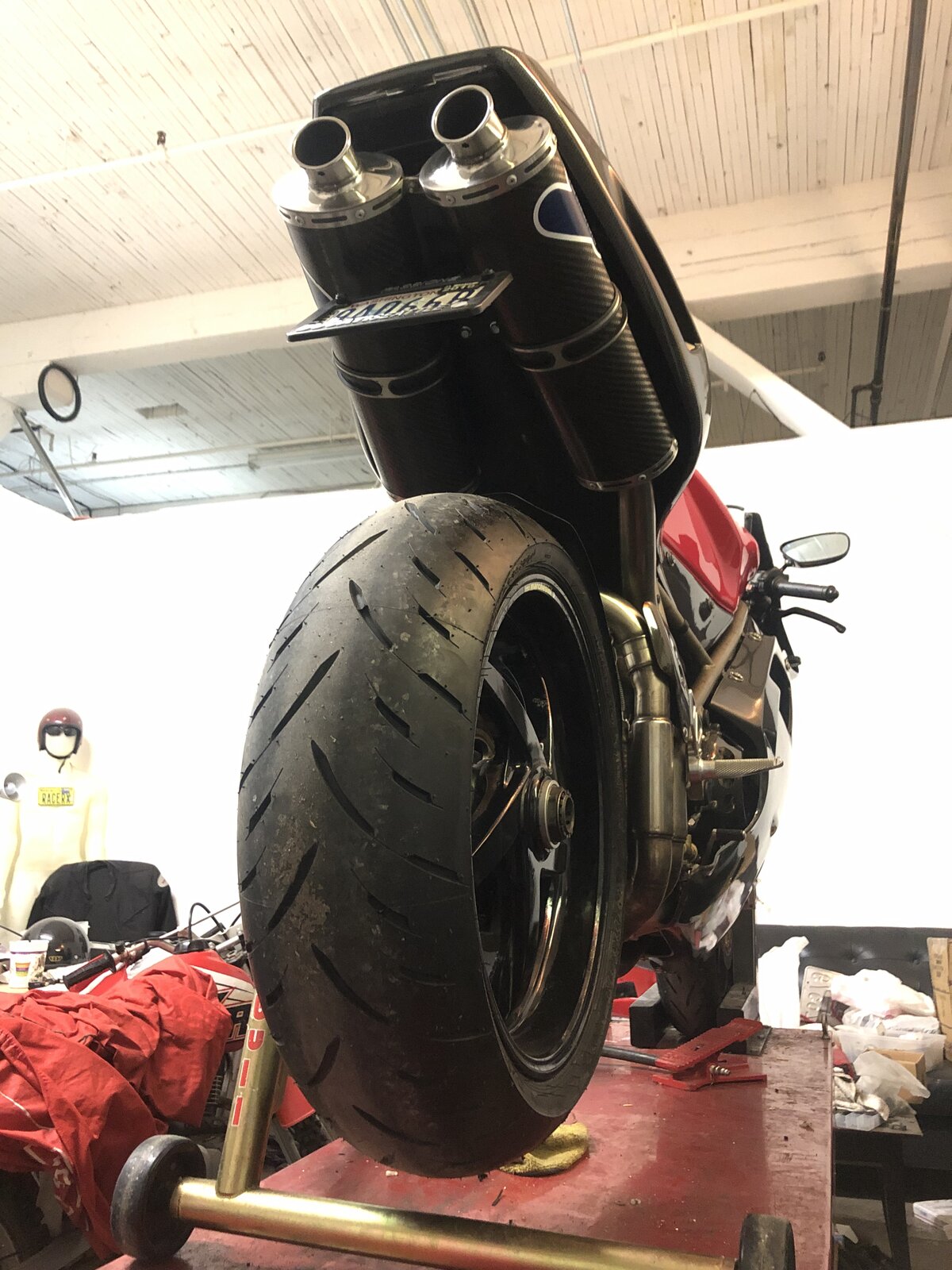

    Buh-bai to these measly 45’s and bring on the 50’s!
    F6EBFE71-1508-4B59-999C-048CFA14BCBC.png B325E3F5-9BAC-42B3-B535-4F59FDA8B801.png FAB4BF67-5D07-4CD8-9C74-779246D38AB2.jpeg

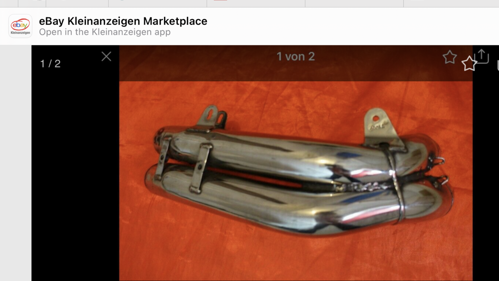

  12. Not sure why anyone would go to the trouble when the standard link pipe is exactly this? granted it has the 'silencing' bulge/thingy built in but I doubt there's anything to be gained by removing it.
    On another note, for sure a decent fabricator could make something for you especially if you have the relevant 'donor' parts but my question would be why?
  13. Simple answer? Vanity. I hate looking at the bulgy thing. Before this thread I thought sourcing the appropriate mid pipe might prove impossible. Hence my inquiry into modifying the wrong mid pipe that I mistakenly bought and cannot return. Trying to cut my losses here such as it is.
    After 25+ years of being around, owning, buying/selling, riding and modifying literally hundreds of 916 family machines I finally (thanks to this forum) understand the nuances and detail differences between all the exhaust system iterations.
    I’ve always thought the bulgy stocker was restrictive as well as ugly. Over the years I’ve come to associate “bulgy” with “bad”. I don’t want bad. I want good.
    So now I finally GET IT. Stock is 45mm. One can just replace the cans with 45mm units (like on my bike) and leave the stock/ugly mid as there is no cool-looking 45/45 mid as I’ve come to learn. Or one can get 50mm cans and a cool-looking 45/50 mid. Why it took decades for me to understand this bit of simplicity is a mystery. But now I know.
    Thanks this forum, eBay Germany, complete strangers in Deutschland buying parts for me from sellers that won’t ship to the US, etc, I’ve got a set of 50mm termi cans and a 45/50 mid on the way. Those will go on my already heavily modded 95 916.
    The 45mm termi cans currently on my 916 will go on my nearly stock 99 996S. You see? It all make sense! Love it when a plan comes together. No idea what I wil do with the massive race mid pipe I have but I’ll think of something.

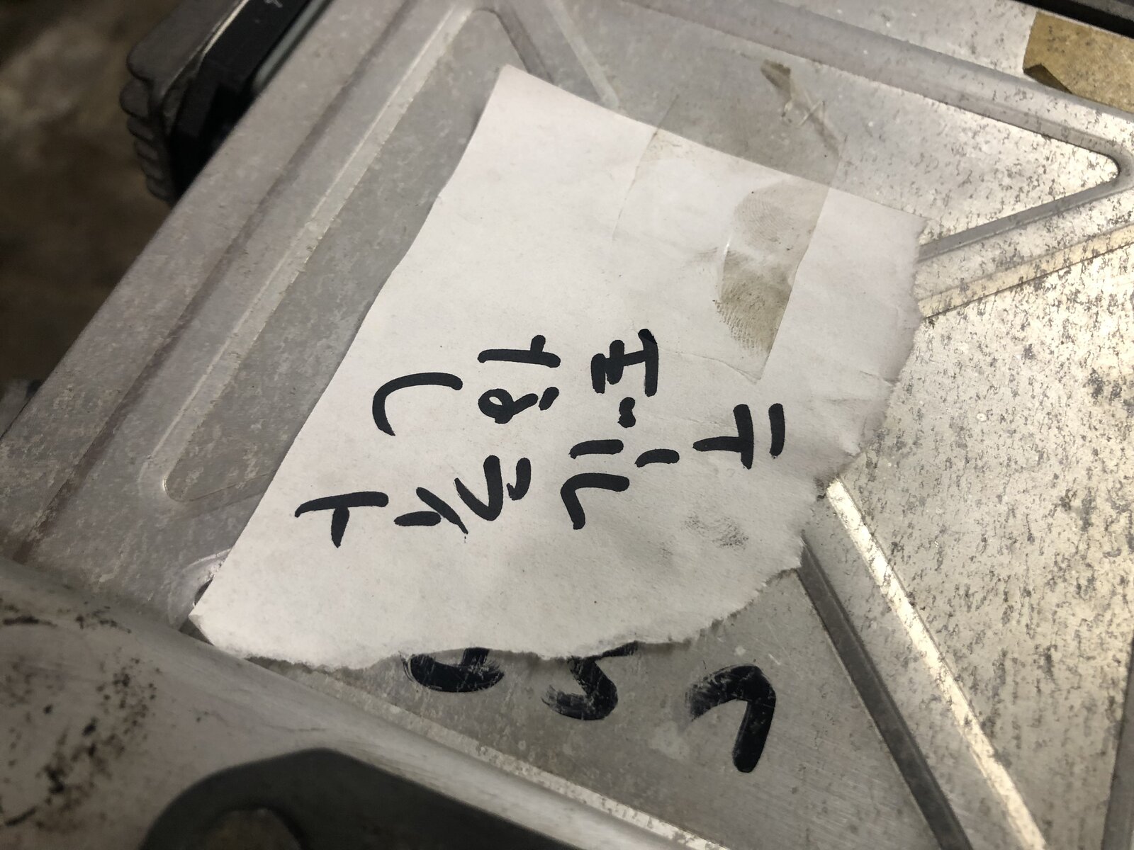

    My bike was tuned a long time ago. I have a chip in a plastic case marked “916 stock chip” so presumably an upgraded chip is in there. Perhaps I’ll crack the lid and have a look. There is a note attached to my ecu that I thought must have something to do with whatever sorcery is happening in there. Out of curiosity I had it translated. “Tail light bulb missing” haha. The note stays.

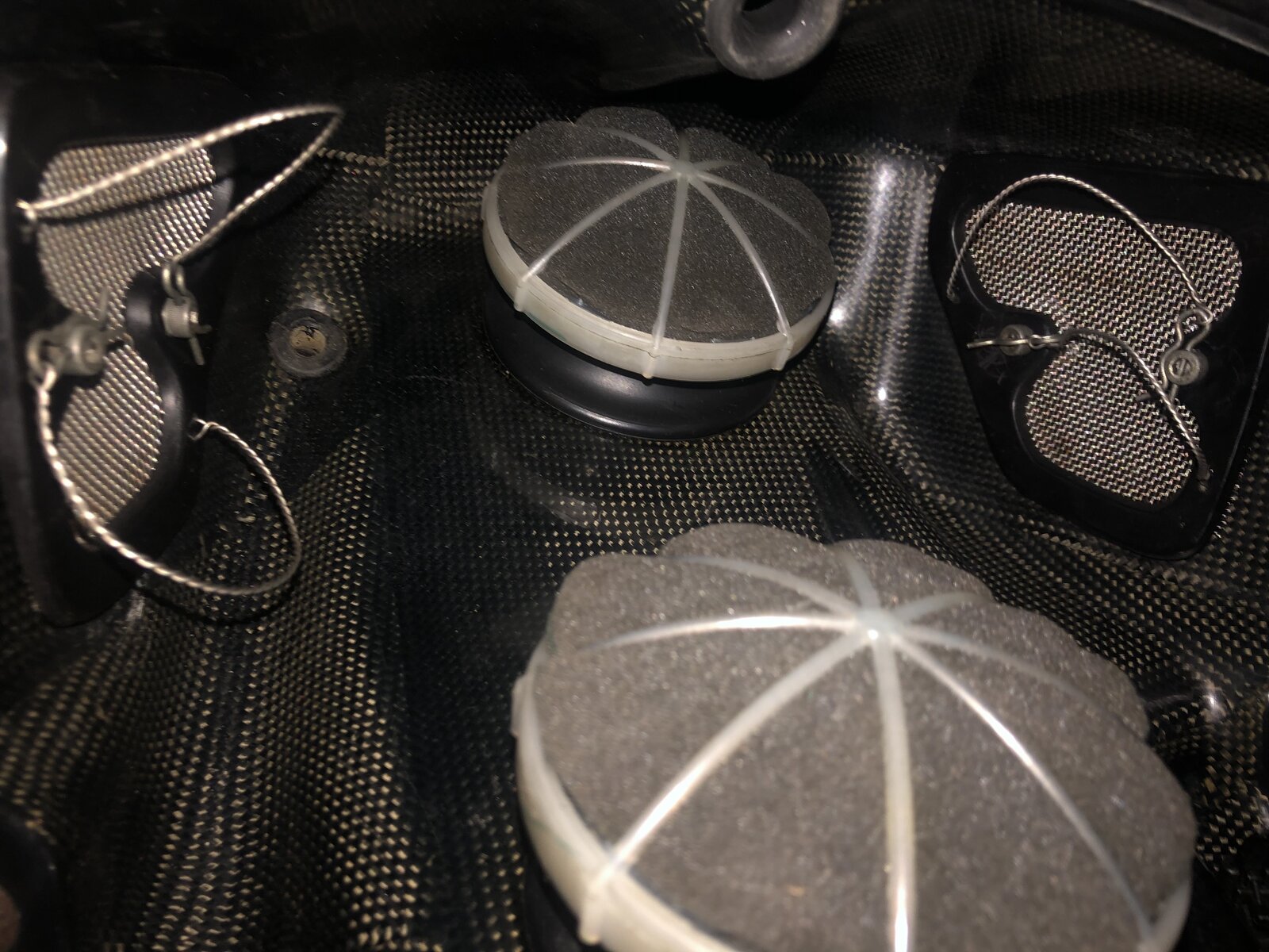

    The stock air runners on my bike are long gone replaced with carbon tubes sans filter provisions. My bike came with these delicate round filter units that snap over the air horns very securely. I had not seen these before and boy my bike really seems to breathe.
    The stock air intake screens from the original main fairing have been reinstalled onto my carbon fairing. Are there gains to be had by removing those? I rather like the way they look.
