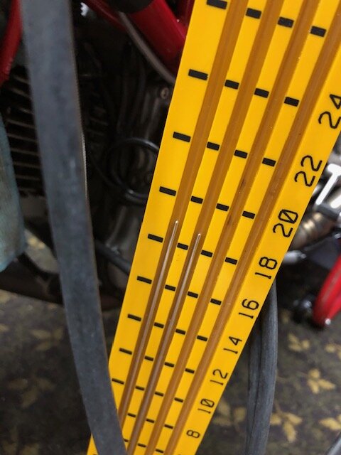

  8. old fashioned, outdated mercury carb stix here, work perfectly
  9. That's beautiful
    Must be a few years old?
