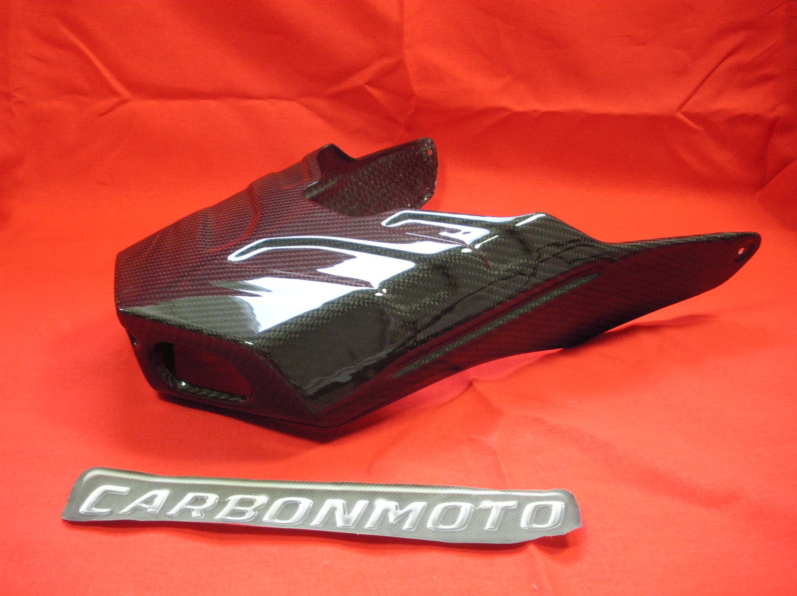

    I can't afford a Termignoni system right now but love the look of the carbon rear end. So my question: Do carbon exhaust heat shields like this really fit and has anyone here had experience of them and any images of it fitted?

  2. Ducati did a carbon cover for the stock system. The outlet holes are a lot smaller than the ones for the termi system. Would probably look daft if you fitted a termi one with stock cans.
  3. 96964703B from DP.

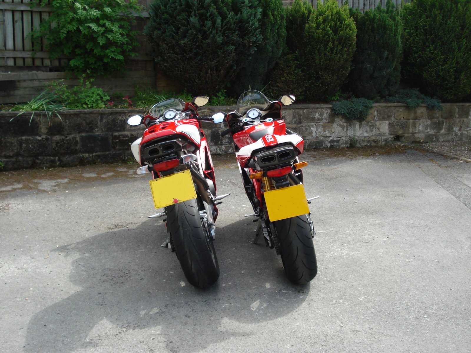

  4. I put a genuine Termi cover on my stock exhaust. I don't have that bike anymore so can't look but I never really noticed the holes being a lot bigger. There were no issues with fitting and it looked ok. See what you think:
  5. That's not a Termi cover, it's the DP carbon cover for a stock silencer.
  6. The differences in the outlets are

  7. one on the left is my 749 and that has the exact cover with standerd exahust one on right is my xerox with the factory oe cover and the termi race exahust so you can see the holes for the 2 type of exhaust the carbonmoto one does not look to much different to a oe one when together you do notice a bit of difference but nothing to moan about
