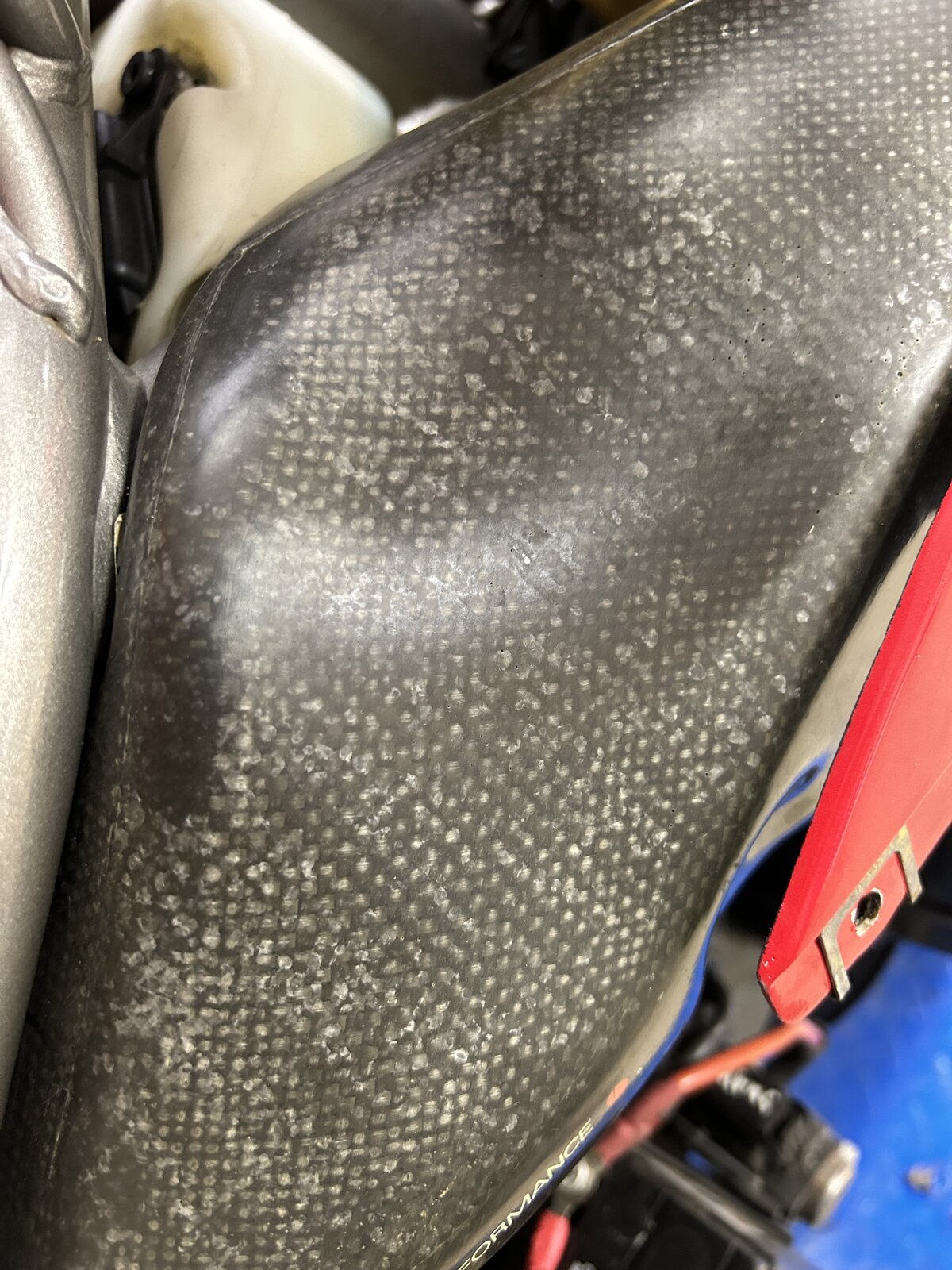

  1. Some of my carbon fibre seems to have gone mouldy. Is there a way to return it to shiny please?

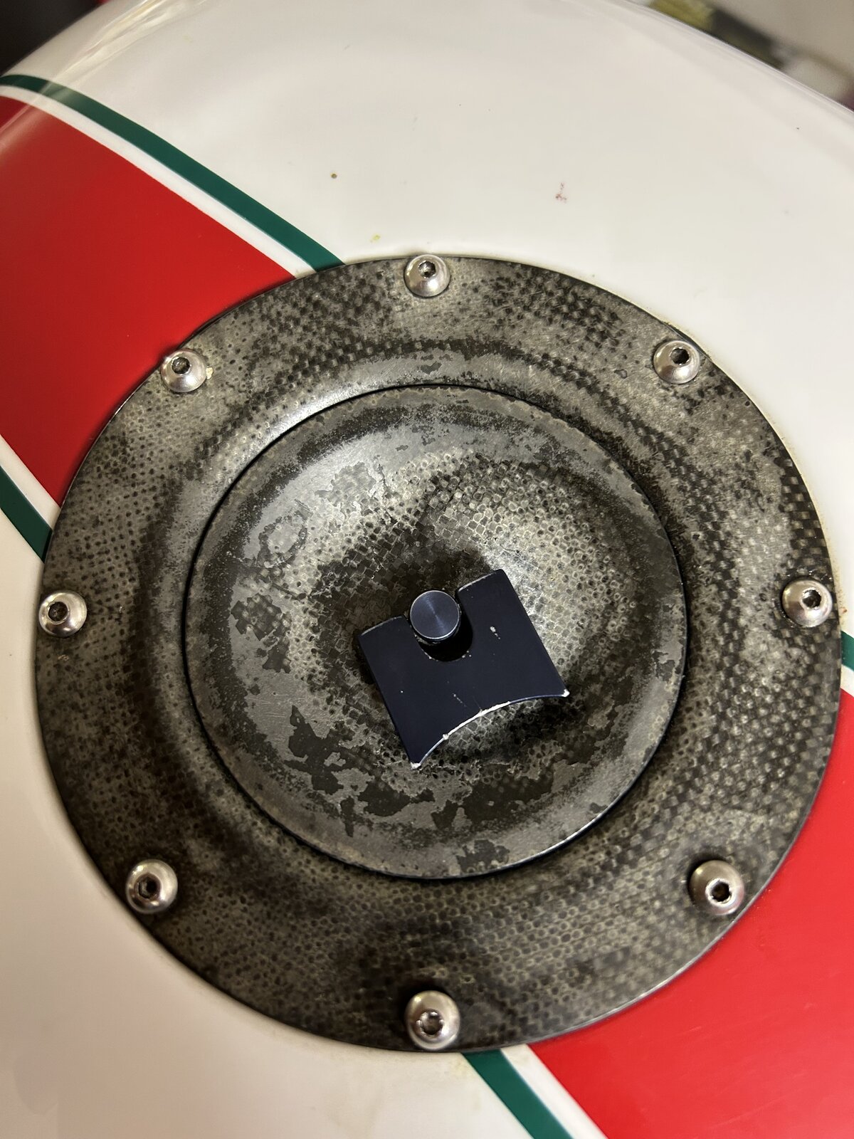

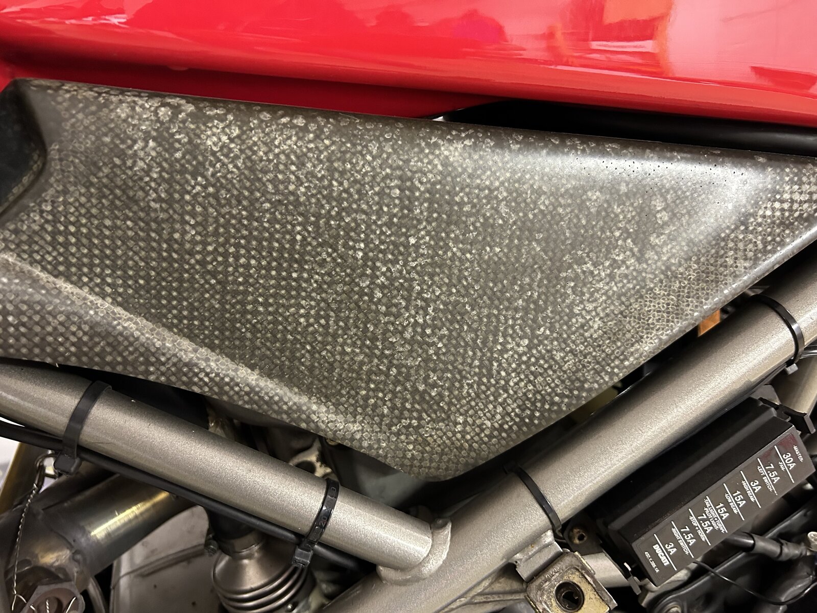

  2. It’s spreading!
  3. That looks like the lacquer is letting go.
  4. i had this on a hugger, mine was the lacquer, i rubbed mine down with wet and dry, when its wet it looks how it will look when lacquered, i tried to lacquer it myself and it looked shit so i paid £80 to have it done properly
    id rub down first hopefully its just the lacquer and not the weave

  8. Just be a little beware when sanding carbon fibre, you don't want to be inhaling particles of the dust it can produce!
  9. This is true. Mask for any sanding or spraying. When rubbing down take care not to rub past all lacquer coats to the fibre itself. You just want to remove the top layer or two.
