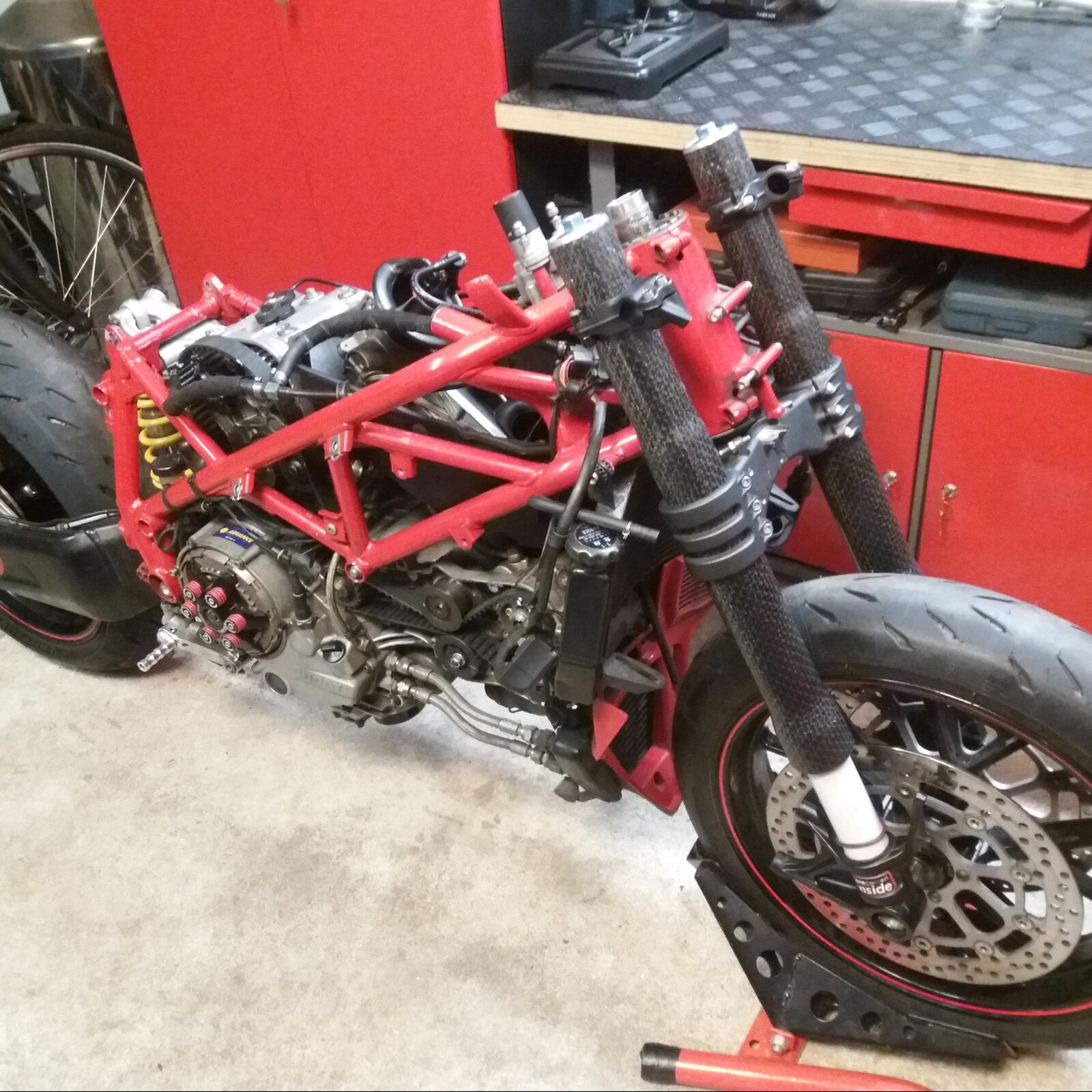

  1. Hi,
    for my new projekt, a 999 rebuild in full carbon, i'm surching a BST-Carbonswingarm 1098, Carbotech Carbon valve covers. Can anyone help me to find this parts?

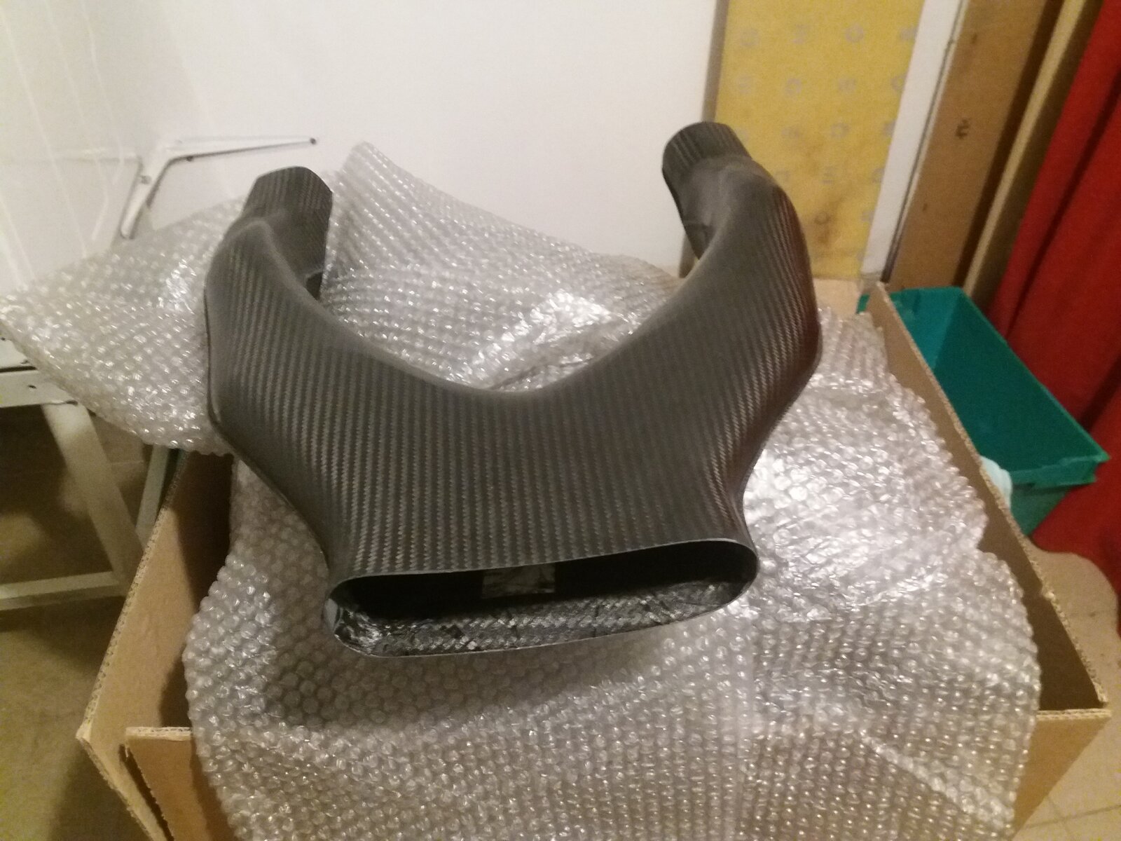

    Many thanks,
    Jens

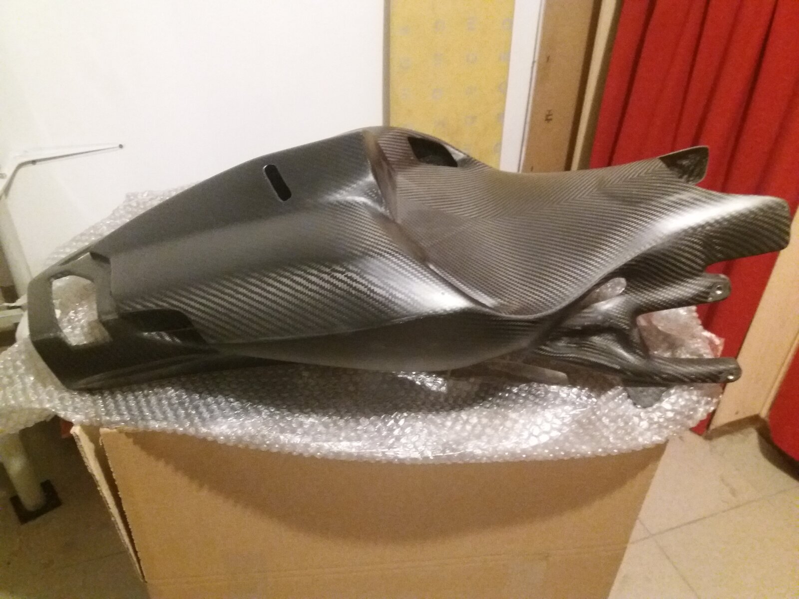

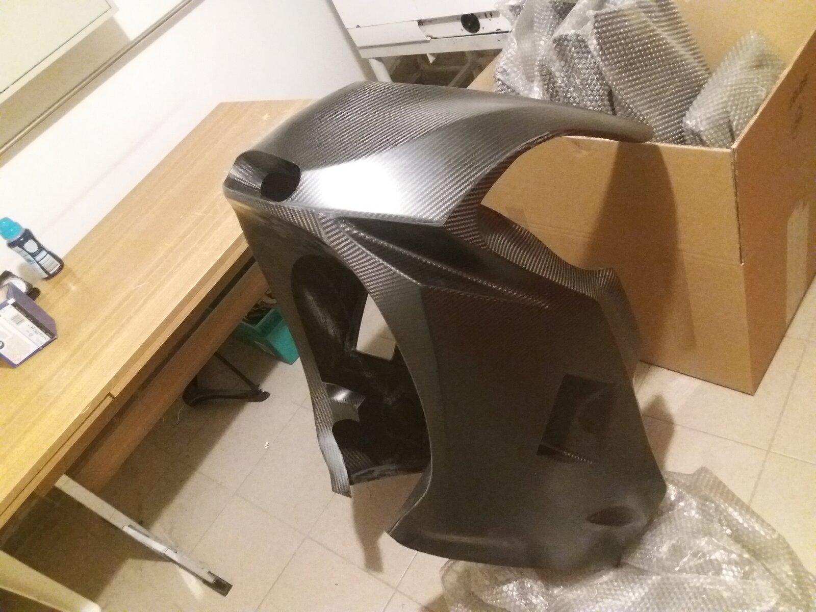

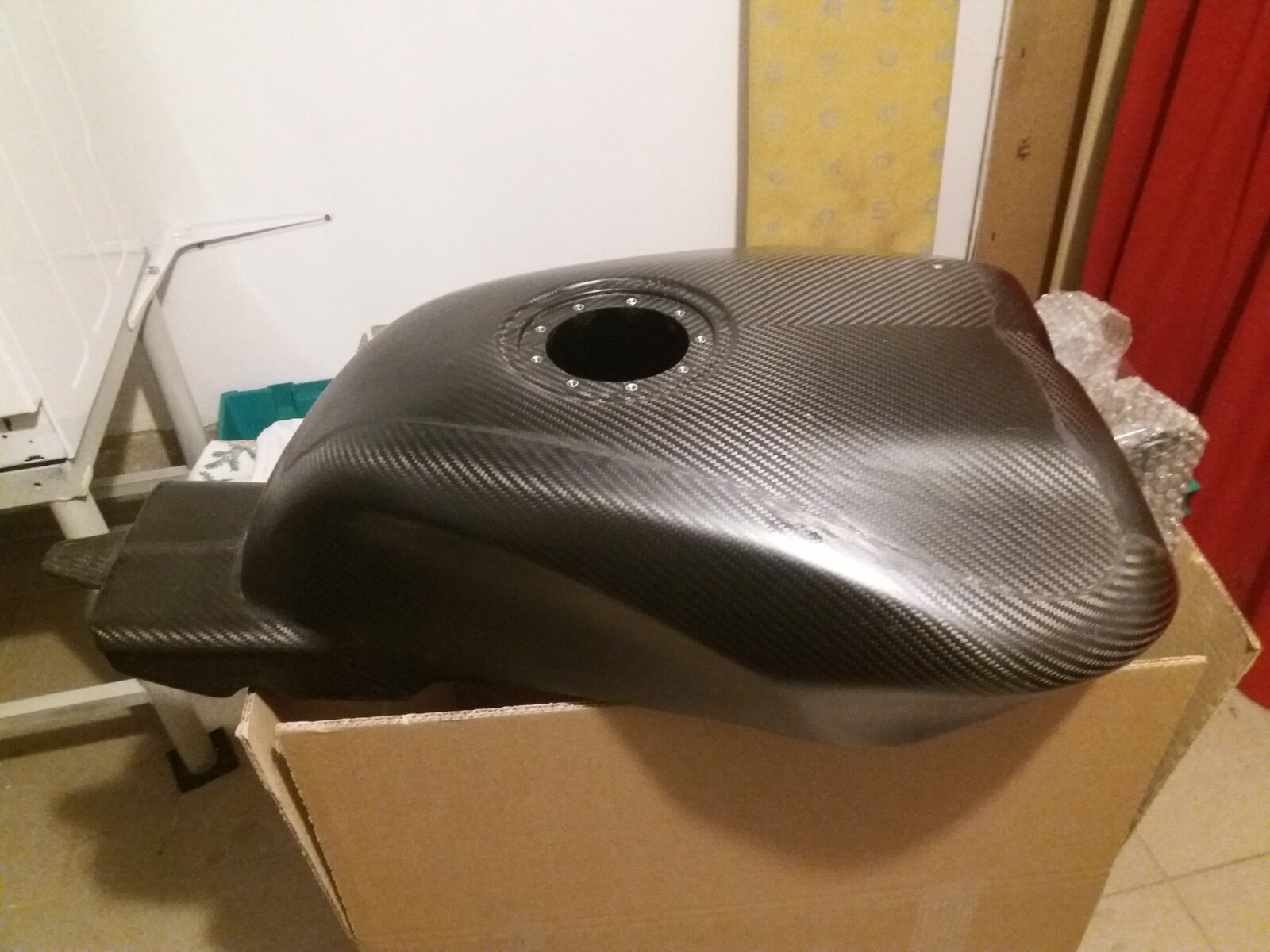

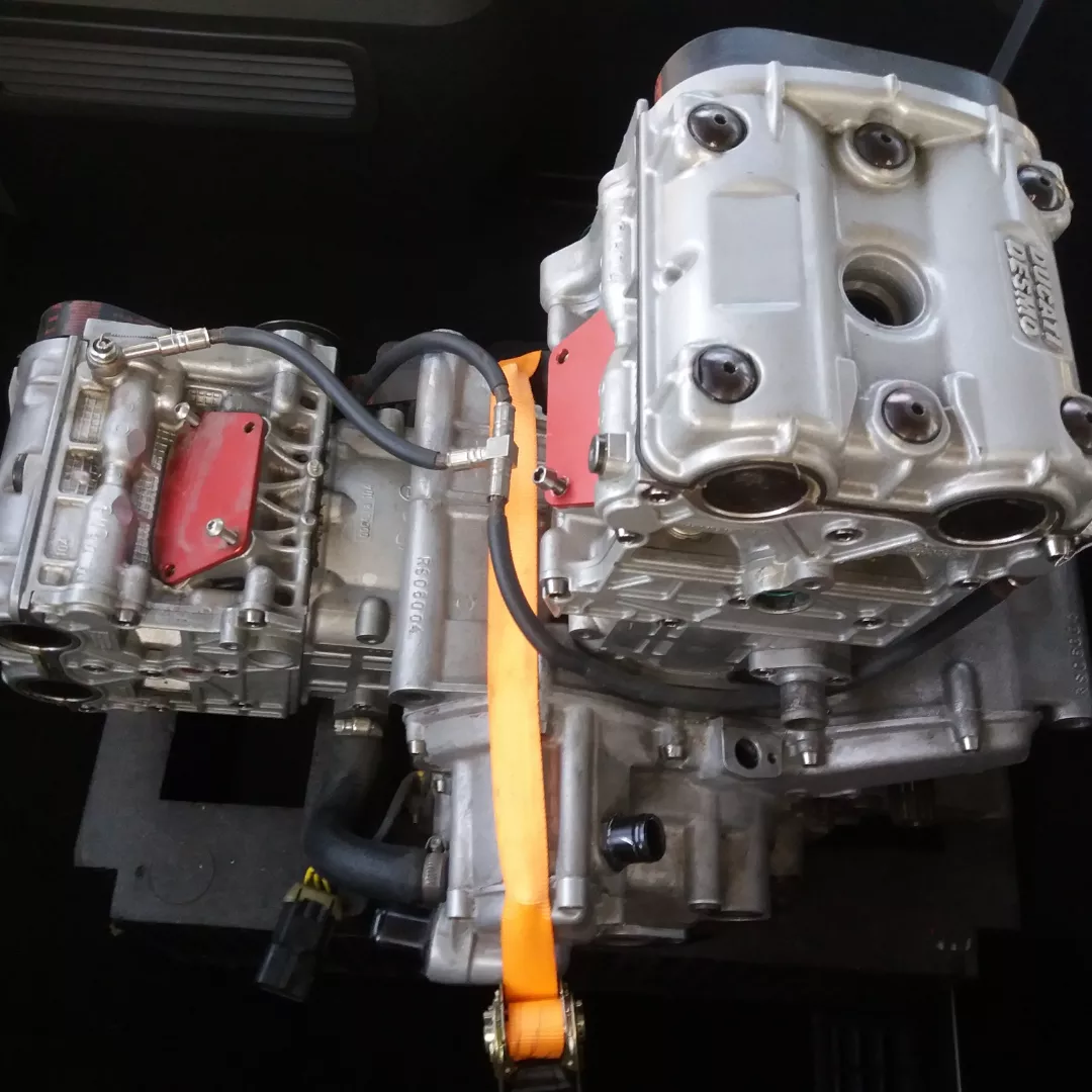

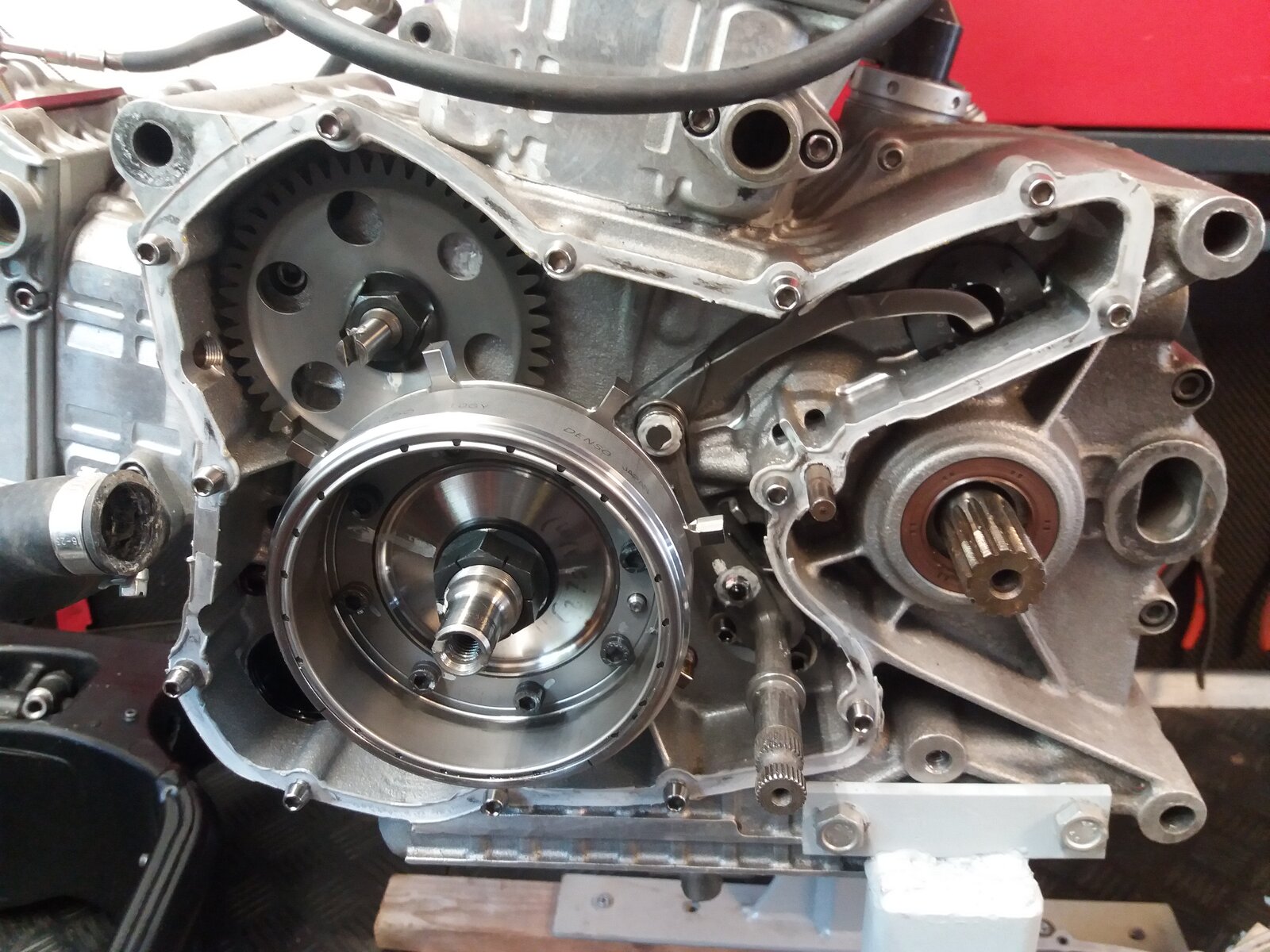

  4. The target for my 999 ultralight is a dryweight complett ready for race 140kg or lighter. The Panigale R ,that i have before, have 140kg. 2 weeks ago i pick up a 999F06-engine. This engine is 13,3kg lighter as the standard999-engine. The fork that i have is a CeraCarbon-'Fork. She is 1,5kg lighter as a Standard-Fork.

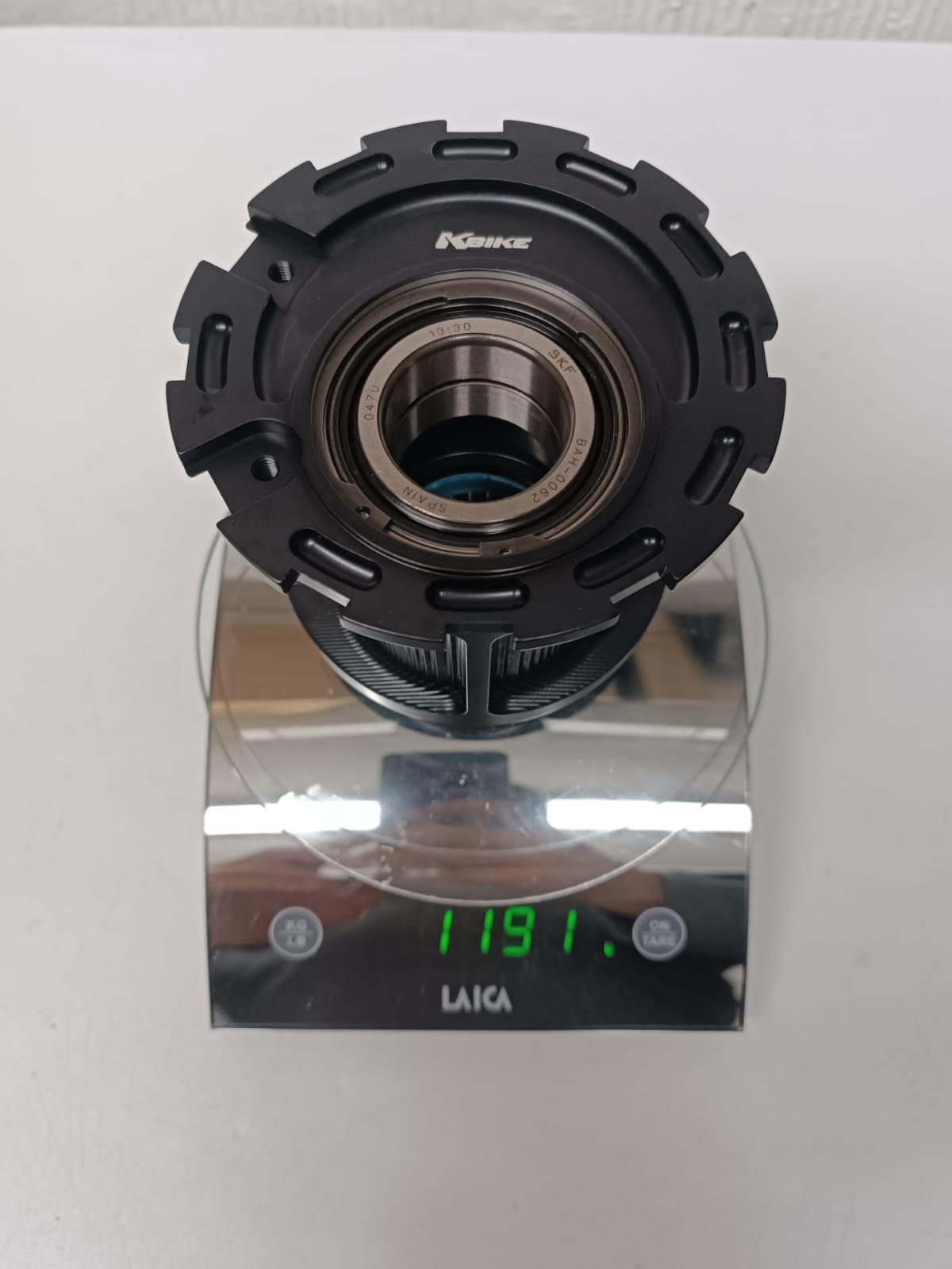

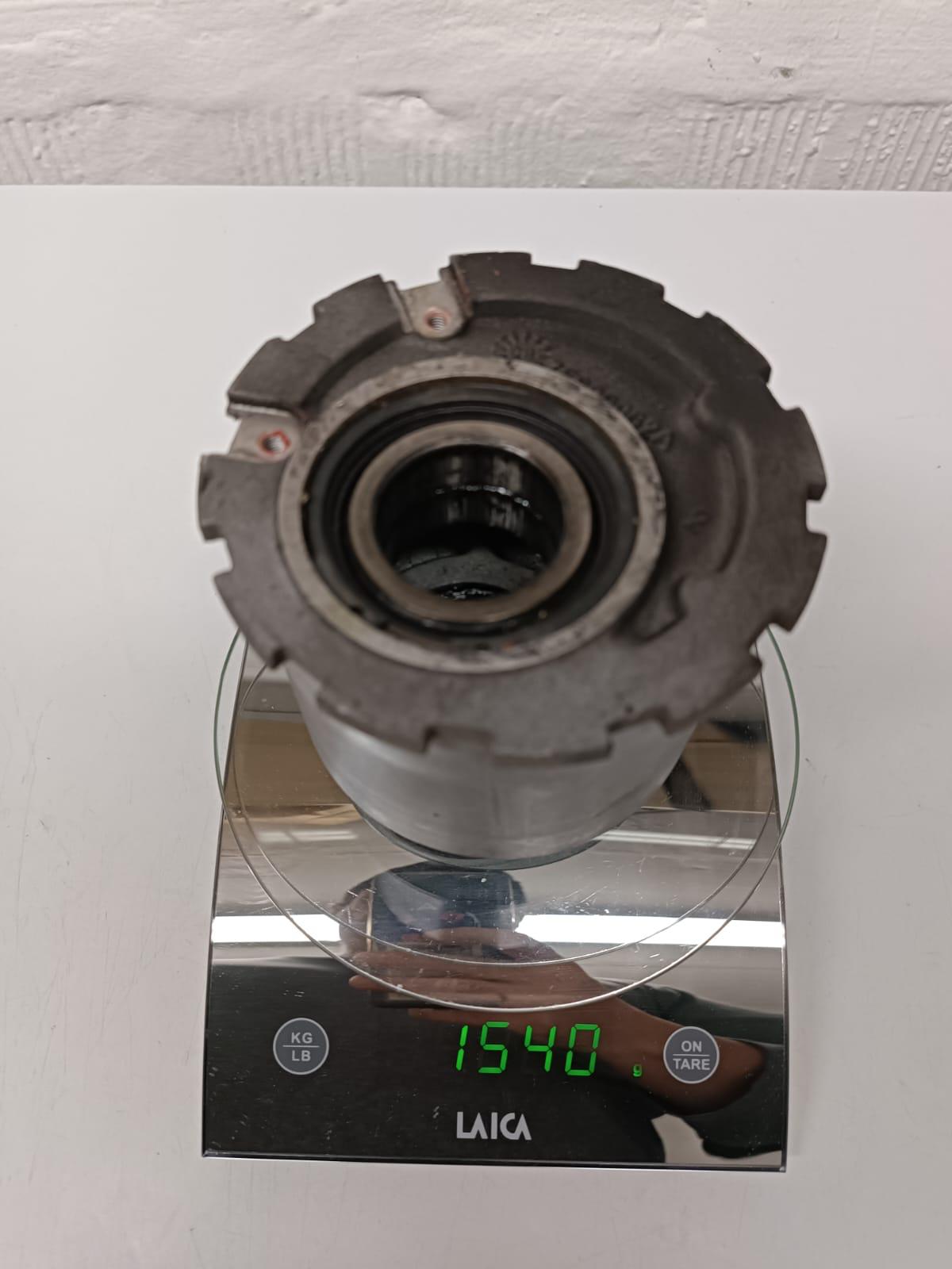

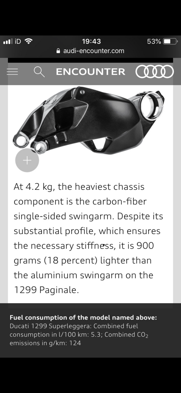

  9. The BST swingarm weighs 4.3kg. Add the eccentric which is more than 1kg and you're pretty close to the black 999 swingarm (5.6kg) already... Not to mention the steel rear wheel spindle on the single sider. Get a Ti axle for the 999 swingarm and be done with it. Unless this is really about the "look at mee" factor instead of weight :)

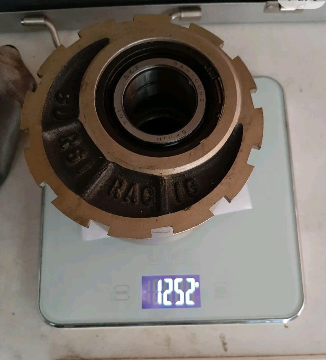

  10. The small hub eccentric is 1.5kg:
    I had a Mg one as well:
    Kbike CNC:
    • Useful Useful x 2
  11. Really 4,3 kg? And the Bursi-WSBK-Swingarm? Is this swingarm lighter als the black swingarm?

  13. Wow, I'm loving that carbon bodywork.
    Are you able to give me an idea of how much that costs please?
    TIA
    Deaks
  14. Here is the link to Tom(Carbon-sigl)
    Here is the link to Tom(Carbon-Sigl)
    https://shop.carbon-sigl.com/Ducati-999-Komplettumbau/SW10058
    Please ask Tom for the price. The price that i paid i cant say. Because i'm working together with Tom since 12 years. So i have other prices than normal.
