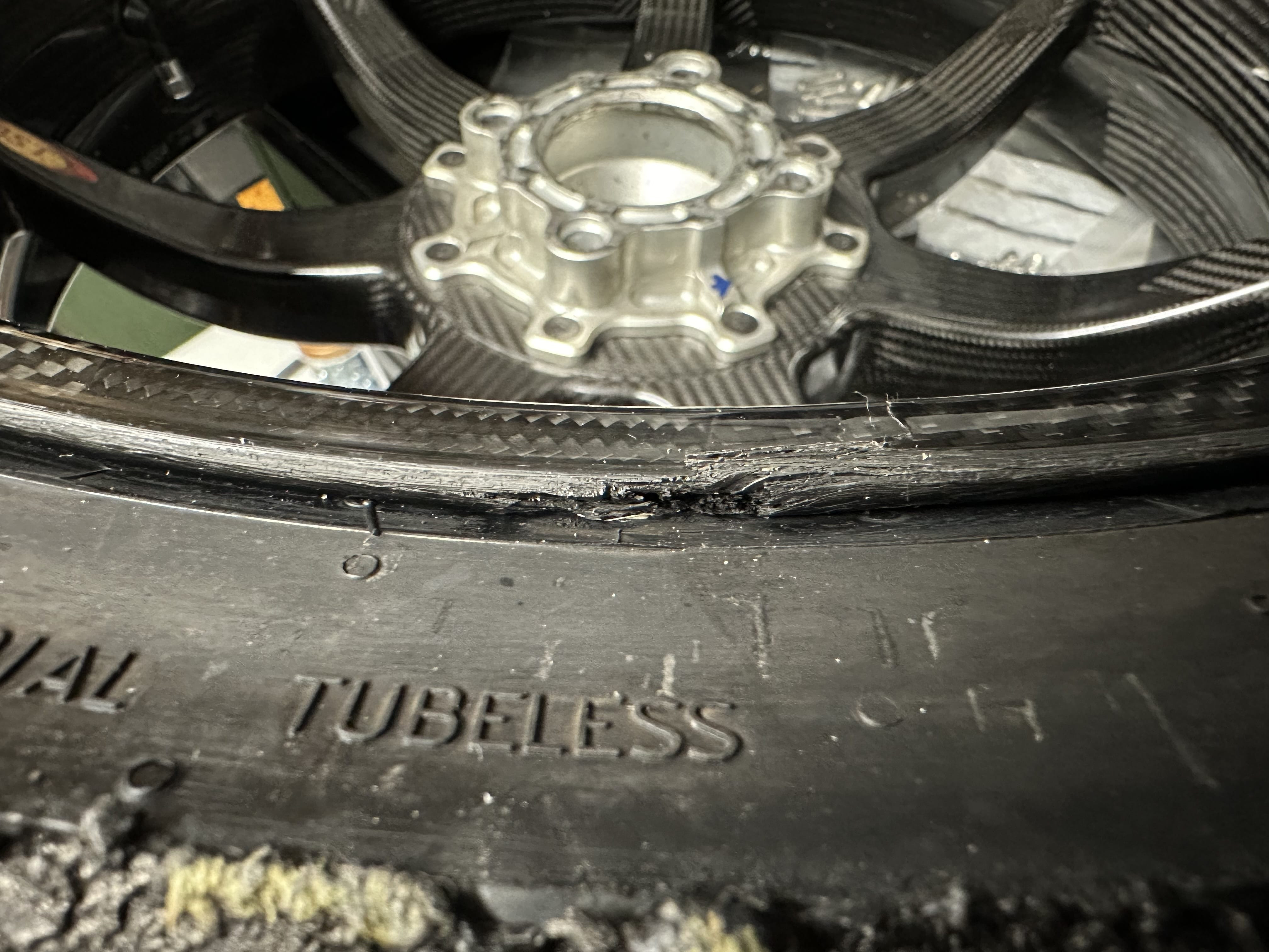

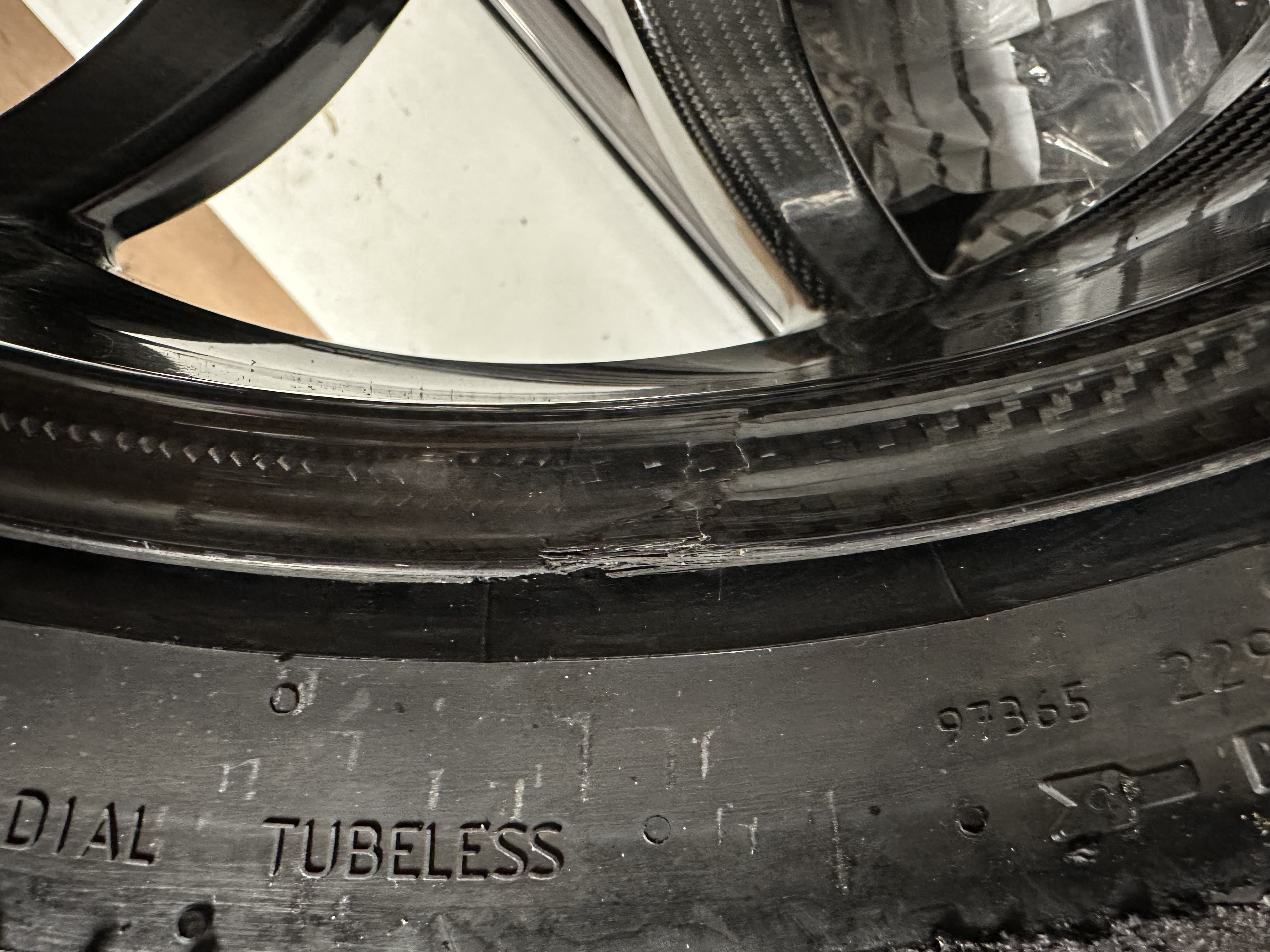

  1. Bought a set of BST carbon wheels from a friend and stupidly didn't inspect them when I picked them up. They've sat in my van+garage for the past month since collecting, and inspecting last weekend, to my untrained eye the rim looks to have had a big impact causing cracking and severe damage.
    Thoughts?
    Of course the convo didn't go well speaking to matey, who denied knowing anything :confused:

  2. Well, it's certainly fucked, and the trouble with CF is that a lot of the damage won't be visible. Refund time....

  6. IMO the wheel has been down a pot hole and I have to say, the said “defence” is conclusive proof the damage was known about. Andy

  8. Could be damage from a bad tyre change with levers but I’d get rid it’s not worth the risk.
    edit: I’ve just zoomed in on the first picture, that wheels knackered

  10. When I had some BST's a well regarded tyre fitter wouldn't touch them, he'd had a similar experience with a BST wheel, ended up having to pay for a new wheel, apparently they are more prone to tyre lever damage than other brands, in his opinion.
    The seller knew about it, how ever they were damaged

    On the first pic, the threads look cut which seems more like an impact rather than tyre lever, but I'm not expert by any means.

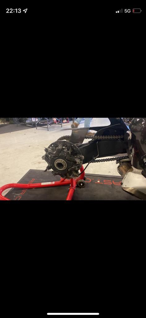

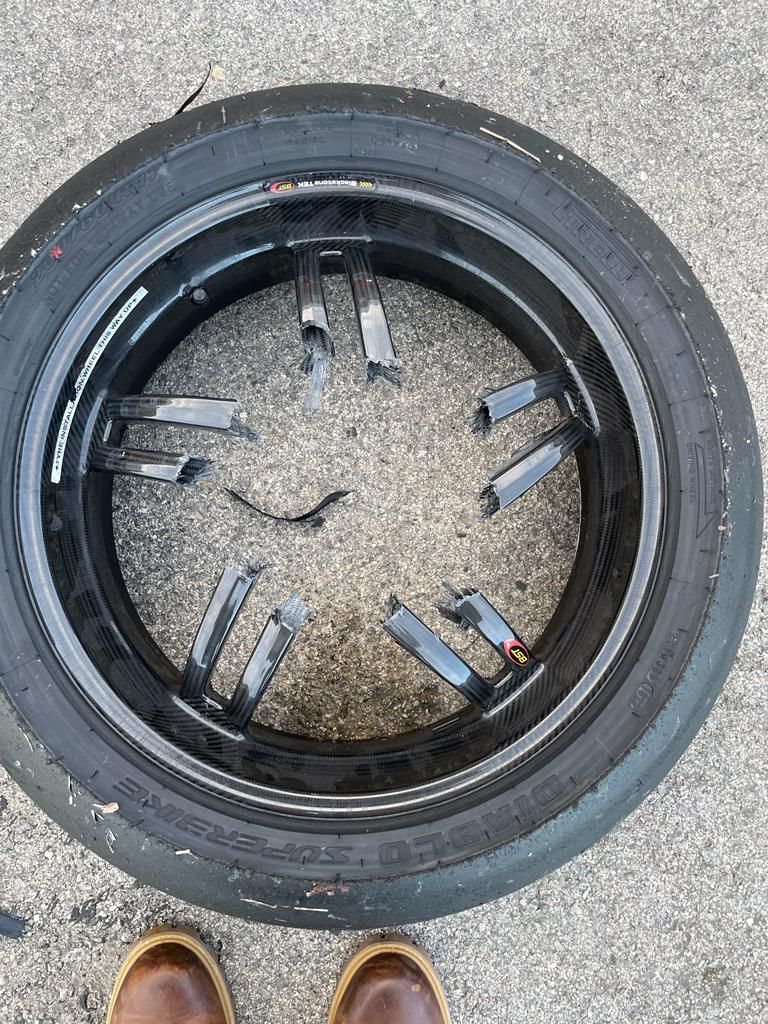

  17. Me personally wouldn't fit carbon wheels ever again. My mates wheels imploded brand new v4 brand new bst wheels.
    • WTF WTF x 11
  18. Bloody hell...what was the outcome of that?
  19. Shades of Robert Dunlop at the TT
  20. But to be fair, that was a SSSA Marvic mag alloy wheel failure, not carbon.
