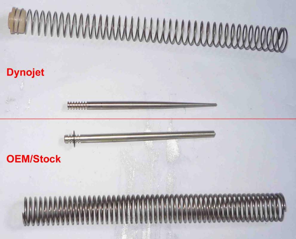

  3. Post a pic of the needle and the spring....I can tell by looking at them if they are Dynojet or not....
    You could also look and see if there are any numbers on the needle....DJ needles don't have numbers.
    Also, the jet. photo the number or tell us exactly what there is on it....DJ jets aren't the same as OEM jets even if the number is the same.......The OEM jet has a little square motif near the number...in fact all the OEM parts have the same motif.
    DJ jets have nothing but a number.
    And you could use the 600 carbs, but you will need to swap a few things over.....I know exactly what you need to change etc etc etc, so don't go buying new parts just yet.....
    In fact, I just found this pic I took a few weeks ago........might tell you summmat...... Needles & Springzah.jpg
    AL

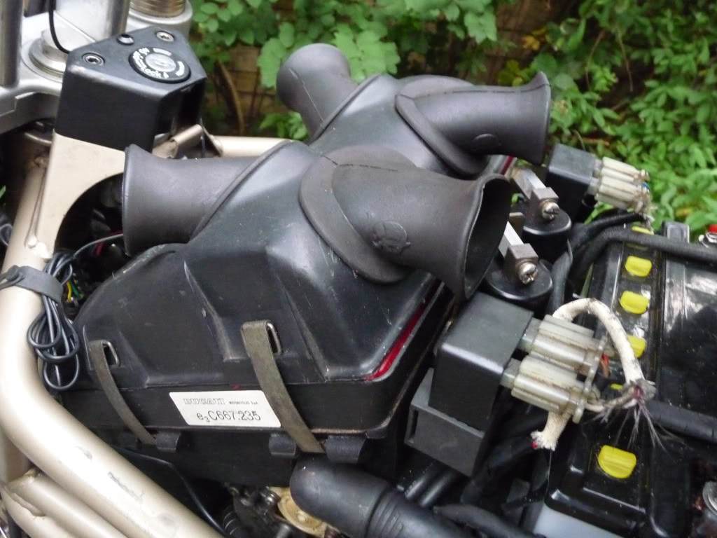

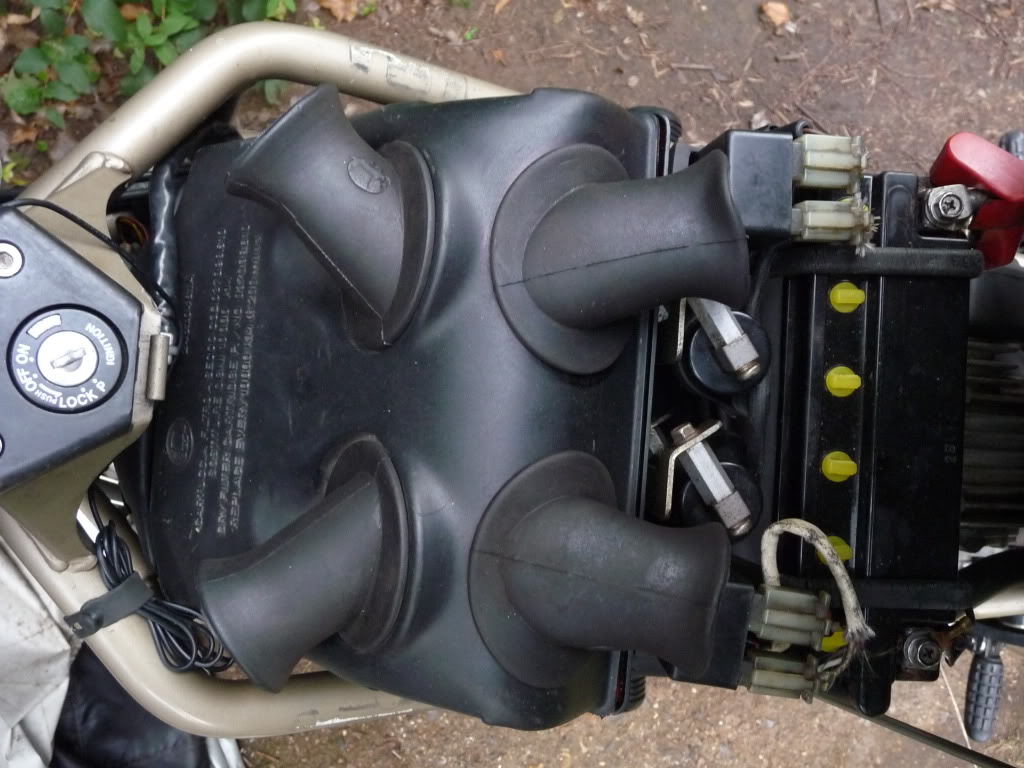

  16. just for reference re: Dynojet, here's my airbox mod that I tried when I got water entering carbs via usual, fully cut down lid a few weeks ago :- [​IMG][​IMG]

  17. That's clever, Chris.....Fortunately, I just have the trumpets removed from mine, so water isn't a problem (so far), but I am intrigued by your rearward facing ones......
    .....If you recall the days of car mods and bonnet scoops, the correct thing was to have an 'Out' but not an 'In'......but I guess with yours you have clean cool air passing through the airbox......It would probably be even better if the front trumpets were relocated lower down and more forward (blanking off the OEM holes)....that way the air would pass right over the whole of the filter.
    Next job, maybe?
    AL
  18. Interesting suggestion AL but it was always going to be a compromise rather than an aerodynamics/windtunnel venture as there are hardly any places where you can site additional trumpets (this is shrek 2 btw) - correction, I think this is the only place you can site additional trumpets without more modifying. It's a personal thing , and I guess most people wouldn't even bother fitting the additional trumpets.At the end of the day I only posted it because it works. I tried one trumpet to begin with but that was starving engine of air at top end but two really work a treat. If engine had far more mods then I'd look at it again but meanwhile very happy with result.
  19. I meant keep the rearward facing ones...seem like a brilliant idea, but possibly move the front ones down, unless there is not any room to do so...but I suppose they could end up being exposed to water again if they were lower.
    However, your idea does lend itself to a much simpler mod than hacking the top of the airbox as others have done....and thats cut the airbox straight across the back about 1"+ above the bottom (roughly where the bottom your rear trumpets are) and cut the side curves back to the line of where the front trumpets dished areas are. Then cut another 1" off the curve in line with the cross cut you already made and junk the offcut......That way you have a flap which can be raised slightly....add a couple of infill bits to the sides with glue (or pop rivets) and you have a full width rearward facing scoop.
    Just an idea.
    AL.
