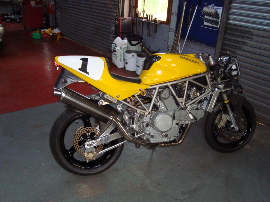

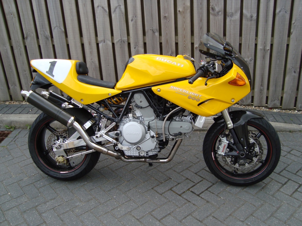

Was this bike someone's on here?. I think it started as a 900ss and ended up with a st3 engine? And carbon wheels etc. I reckon it would be fabulous to ride. I've been looking for a nice superlight for a while, but there's none about. I've thought of buying a SS and trying to create my own vision. The main problems are I've no real mechanical knowledge and a single garage with no room so I would have to pay someone to do all the fettling which I'm sure would soon make the costs spiral out of control

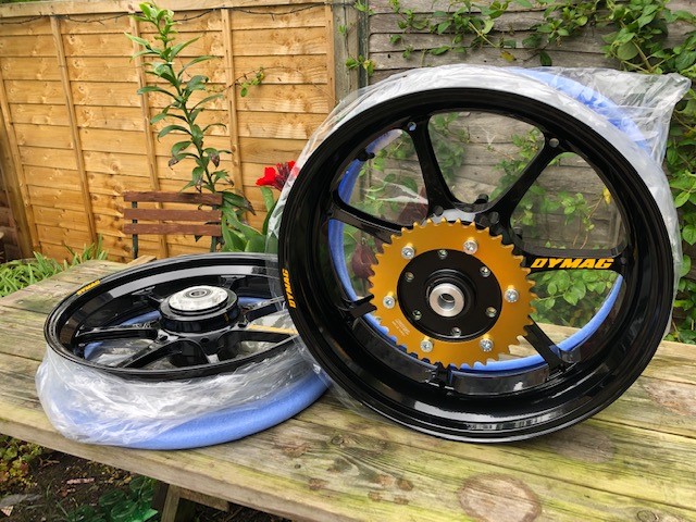

Just by way of an update on my original question about replacement wheels, these beauties arrived recently
Hi Ian, great stuff. Please keep us updated, as I've thought about the same project for a number of years! I came across a racebike 900ie that was 135kg! Wow! It was however running total loss ignition, and no flywheel (!).. instantaneous revs Cheers Grant
For me it was between OZ & Dymags, I must admit I didn’t even consider BST. I went for the Dymags as they were slightly lighter than OZ & I like the idea of being a little bit different
