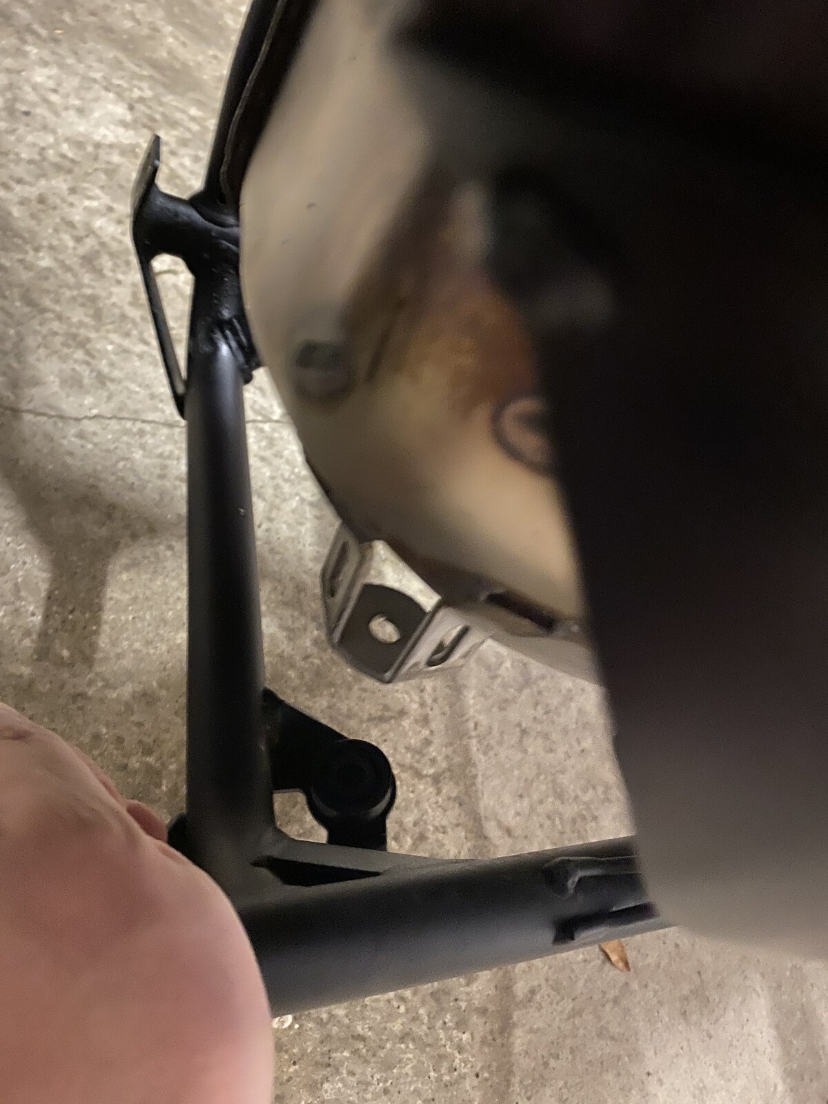

    My centre stand makes a right good clang when I push the bike off it.
    Should there be a rubber bung or something in this hole on the cat?
    Cheers
  2. Mines the same. There's a stop on the stand that aligned with it. I'll check out the schematics
  3. Thank you.
    Yeah there’s a thin rubber grommet on the stand itself.
    just looks like that bracket and hole should have a purpose
  4. Yeah. You shoulda bought a Honda if you want a silent bike :bucktooth:
  5. I put a rubber door stop on mine. Works well.
  6. ^
    What he said.
    I found one laying about and added it to the stand to do away with that hammering on the pipe.

  8. Try putting the bike on the side stand and pulling the main stand away on it's spring and letting go to see what's hitting what first. Something maybe misaligned. Also if your chain is too slack that can get noisy.

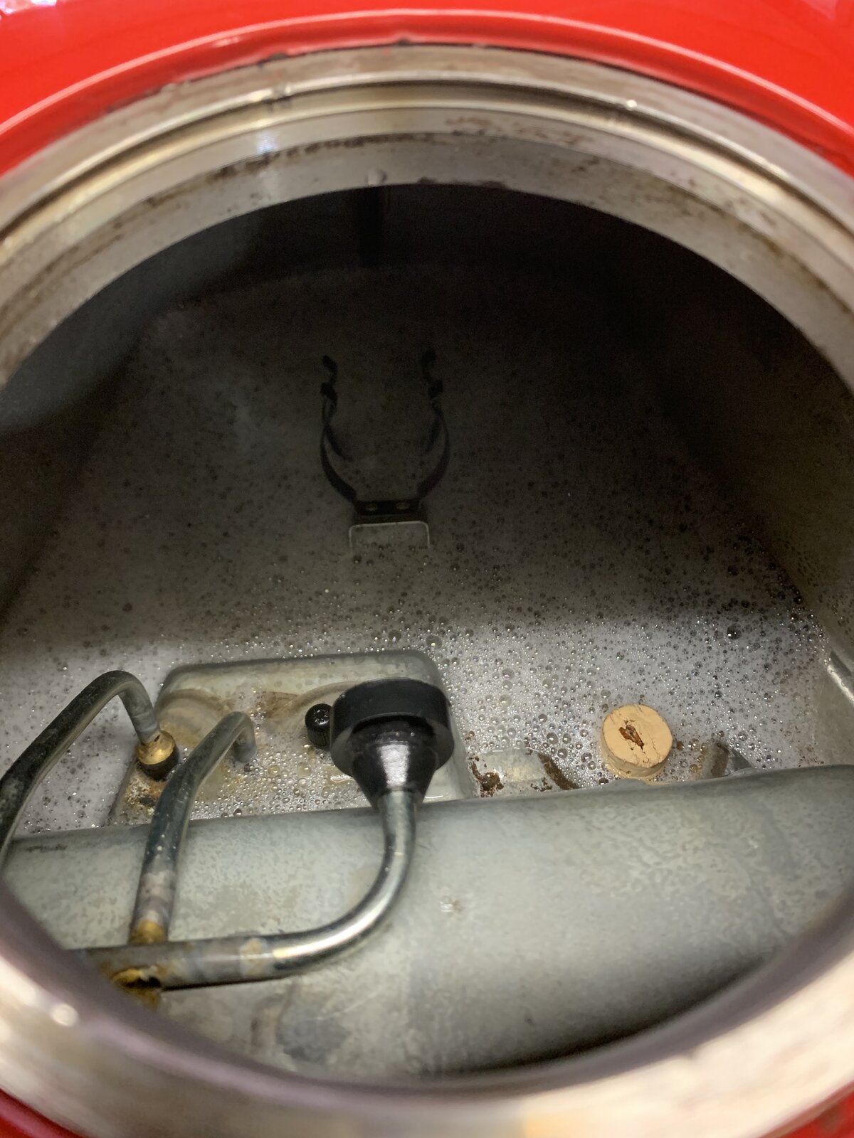

  10. Using a centre stand bump stop to block pipework whilst restoring a petrol tank. Necessity is the mother of invention :joy: Andy
  11. Ive had it up up on the sky lift and all seemed correct apart from the empty bracket on the cat.
    I’ll try the door stop route I think, though don’t want it pushed down too much.
  12. Yep.. I definitely missed that on the end of the pipe.
  13. There is a rubber bung on the centre stand. Two rubber bungs is a luxury :)
  14. As a side effect, when I put a door stop on the stand it lowered the stand a little, so that my left heel didn't hit the stand when balls of feet on pegs. And not so low that it grounded on left handers. Might touch down on a track tho.
  15. Aha - im glad its not just me. I thought surely i dont have to have my heels on the pegs on this thing, after years of having the balls of my feet on the pegs.
    Ive actually ordered a rubber bung for a Honda as seems to be a similar size. So im sure it will do the job absolutely perfectly. I'll let you all know.
