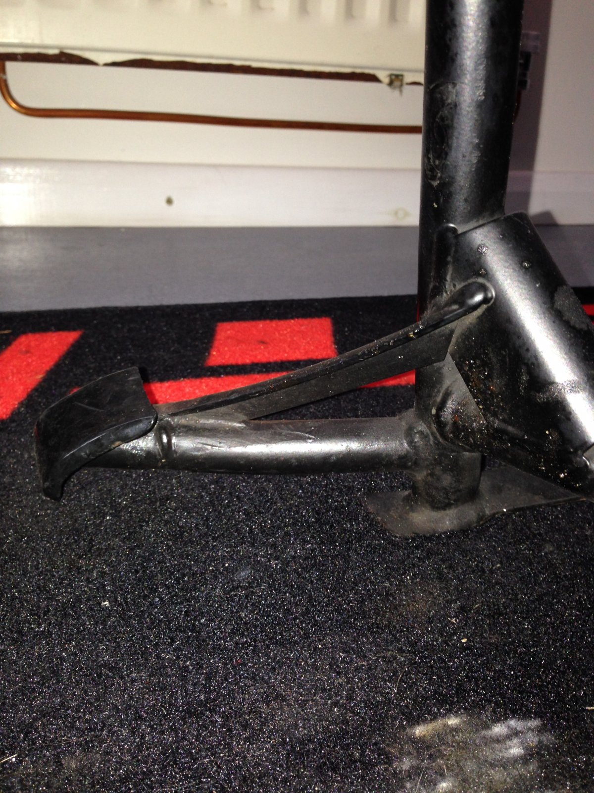

    Did you cut and weld your own then or find someone else to do it? Did you cut out a section and re-weld the original foot press plate?
  14. Looks a bit of a mess because it's covered in chain lube.
    But I knifed off the support bar then cut the bit out between the foot tread, put a piece of bar inside the tube and welded it all back up and sprayed it black again.
