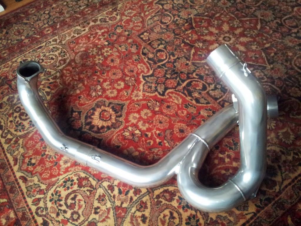

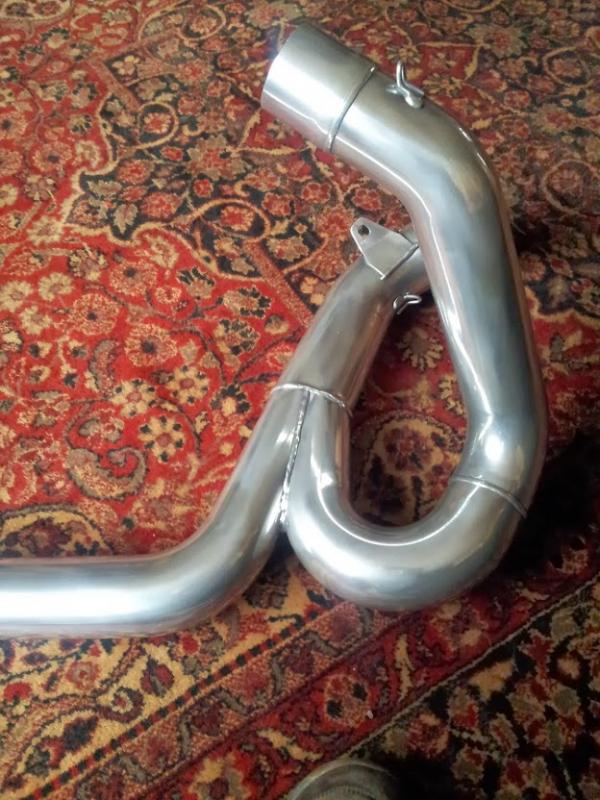

  4. I was pissed off with the stainless on my full Termi system turning rusty all the time. Last winter I spent the best part of 3 days polishing it. Within a few weeks it was as bad ever. :mad:
    This winter I sent the pipes to Camcoat and had them coated inside and out. The external finish is CermaKrome although it's not quite like chrome plate, looks like very highly polished aluminium.
    Sorry I haven't got a pic of them on the bike yet. These photos don't really do them justice.

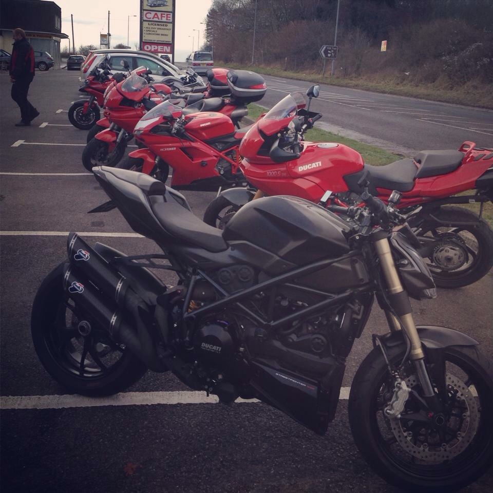

    All back on.... Not the greatest pic but I'm happy enough with the look... Fairing back on this weekend so I'll have a better idea..
