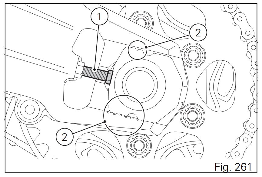

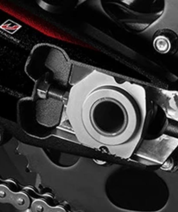

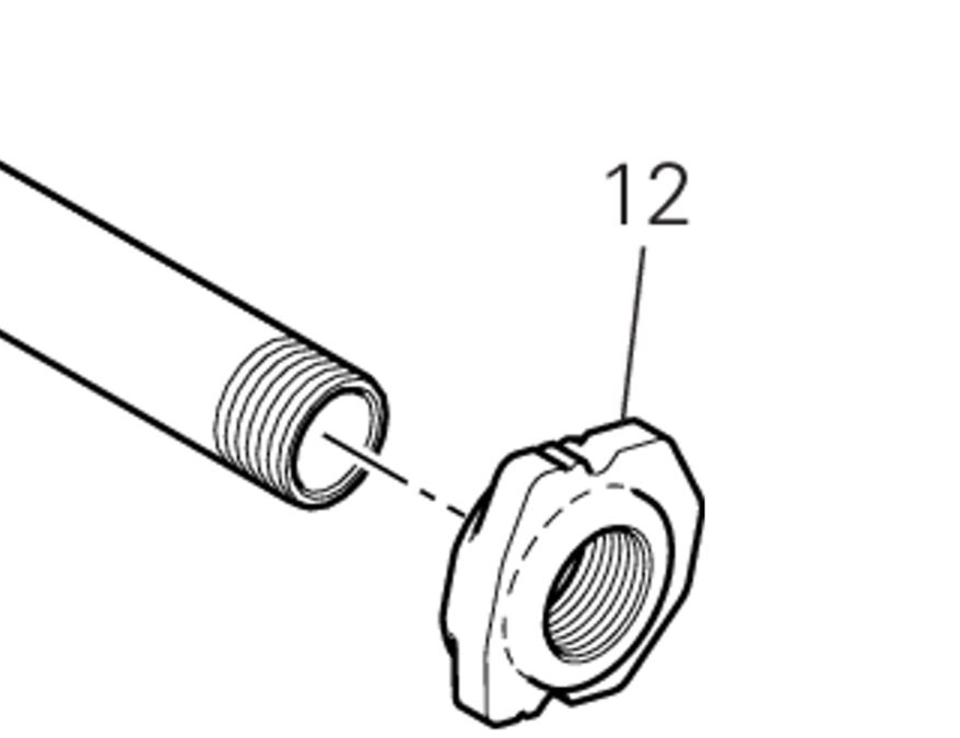

  1. Just wondered if anyone else has noticed that the drawings in the owners manual and parts catalogue show the chain adjusters for the Enduro the other way round to how they seem to come out of the factory!!!
    The drawings make more sense as the alignment notch would line up with the adjustment marks on the swing arm but every pic I've seen has them set up like mine, the other way round. I guess this keeps the adjustment screws shorter. Anyone got them set up as per the drawings?

  2. Not sure which way round mine are (without going out to the garage) but I did wonder why they don't align with the marks. I'll probably change 'em round.

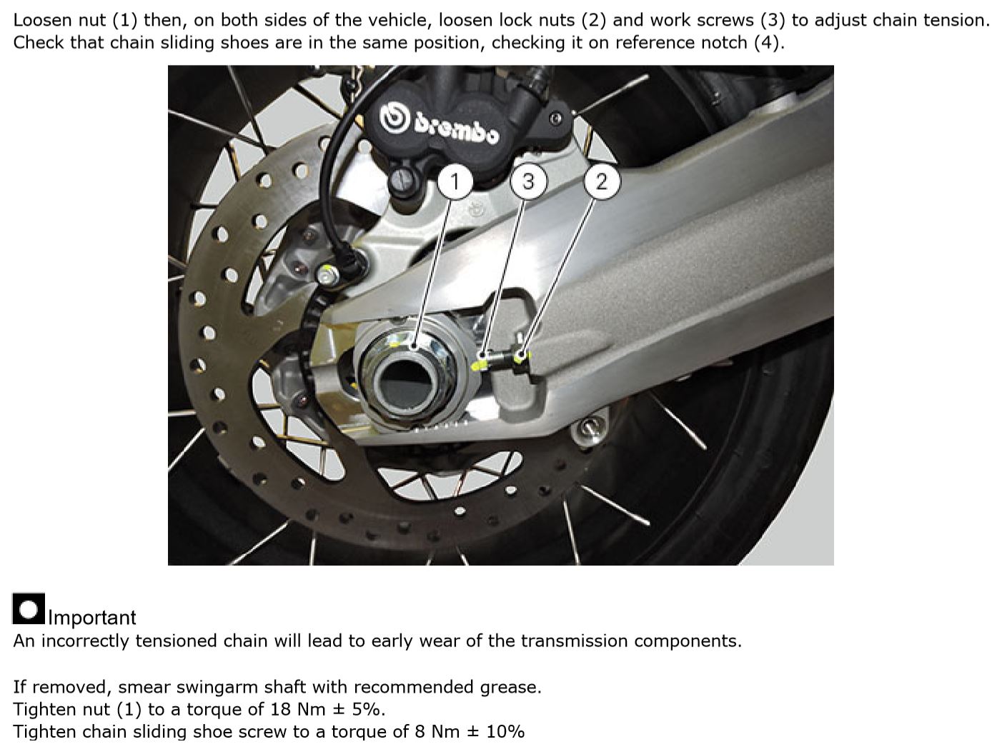

  3. One of my pics comes from the workshop manual which shows them with the notches to the rear as all the pics I've found show them. although it does state the torque settings as 18Nm instead of 180Nm!! :astonished:
