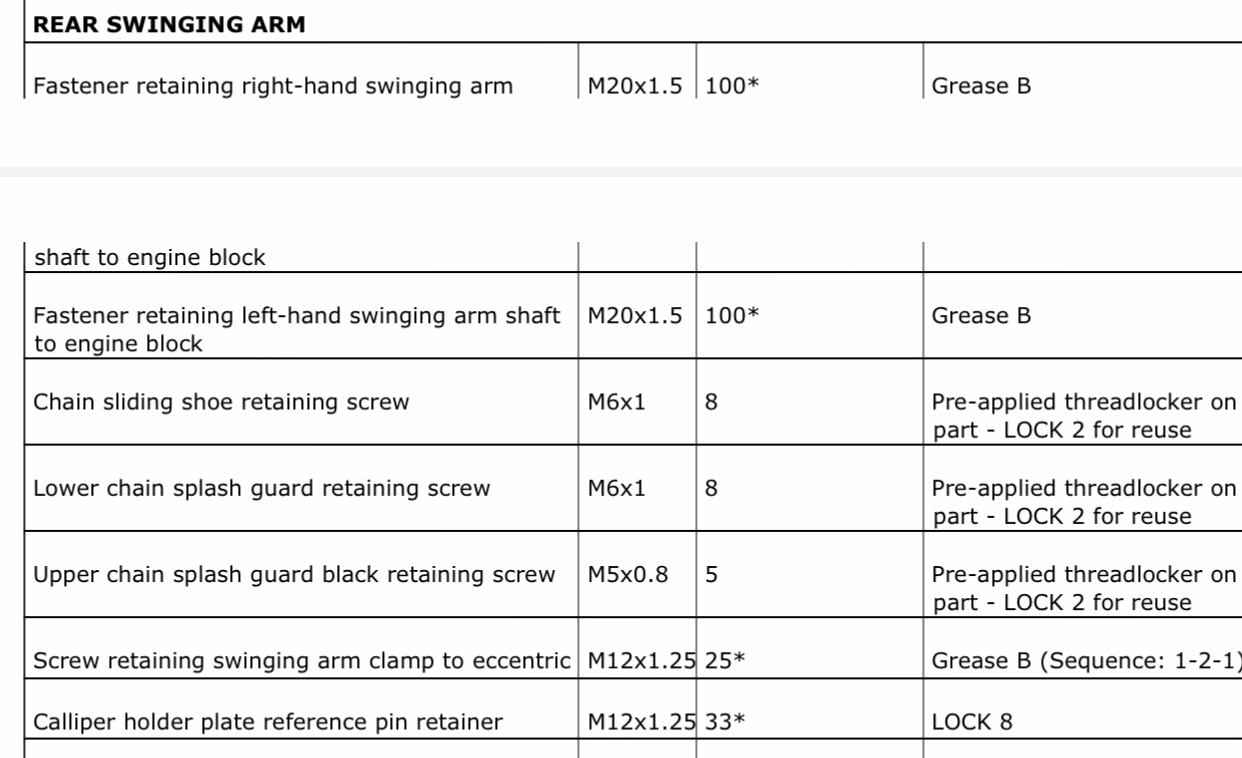

  1. ive contacted Ducati and they have said to tension the two pinch bolts on the swinging arm to 25nm but I've seen elsewhere 32-35nm having had a few issues with this particular Ducati shop not shaw what is right does anyone know cheers
  2. For a 2015 Multi the book says 35Nm, generically a M12 bolt is 30 Nm. I think the important thing is that you Torque bolt No1 then No2, then back to No1 (and maybe back to No2). When you do it you will know why.
    Chers

  5. Workshop manual says 25Nm as your dealer stated.... it has been known for the manual to be wrong (but that is usually because they left a torque figure for a 1299 in the 959 manual - so has too high a figure for the 959, not usually the other way round).
