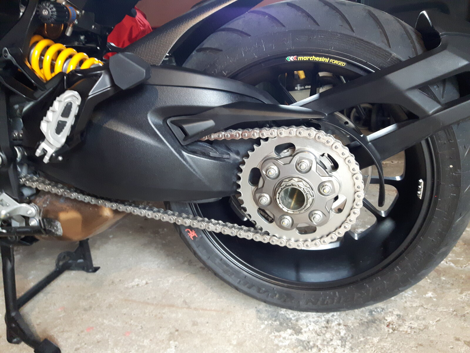

  3. Here's a blingy Supersprox one:
  4. I've just gone with the SuperSprox, 42T great improvement, and the DID chain. Expensive but worth it.
  5. Stock is 15/40......
  6. Like the supersprox one a lot. Not overly bothered about going up 2 on the rear.
    Could I ask exige where you got it from and what front sprocket did you use? Cheers
  7. Not sure what's on the front but it was already on a 1098R I bought, not a Multistrada

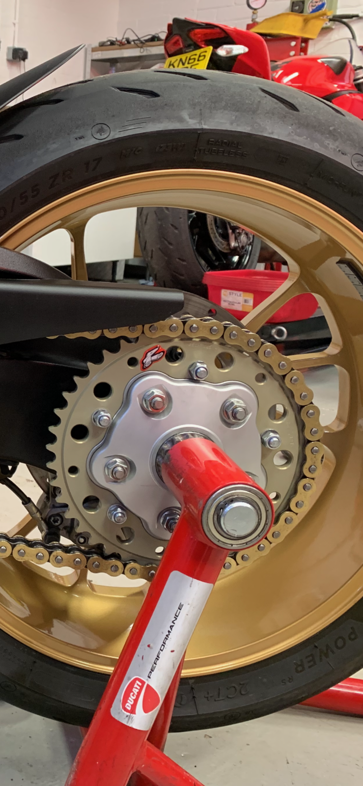

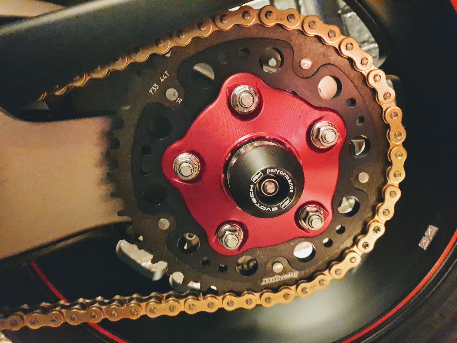

  10. Renthal sprocket, DID chain, renthal sprocket carrier
  11. Andy, do you need the renthal sprocket carrier specifically or is that just for ease of changing sprockets?
  12. You need it, I've used a JT carrier before, much cheaper than the Renthal
    They are for ease of changing, 5 bolts and the sprocket is off.
    Not sure what set ups are available for the Multi's.
    Personally I prefer the look over standard set up
  13. Yep I think it'll be renthal rear with a DID chain. Definitely like the look of that. Cheers
  14. As long as you're aware that the Renthal sprockets are aluminium and won't last anywhere near as long as steel or a Supersprox with steel teeth !

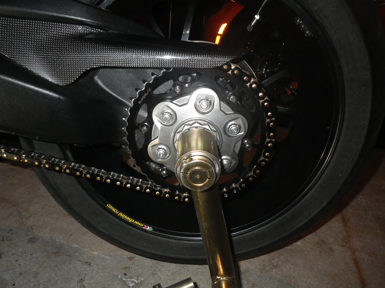

    You have plenty of options Bro. Here's some:
    ESJOT Stainless Steel with DID chain
    Black Superlite steel with quick change carrier and EK Black / Gold chain.

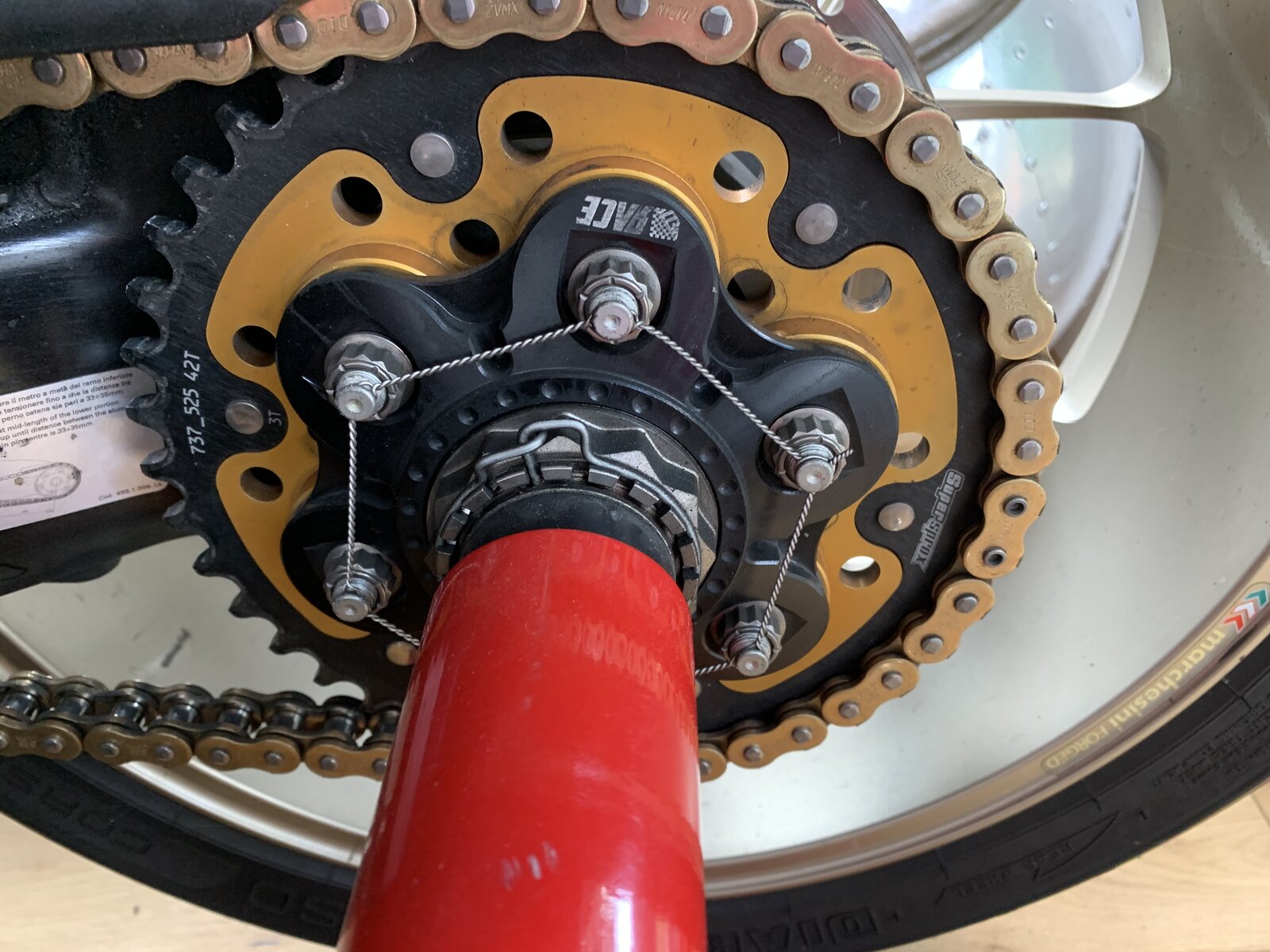

  16. Had a look at Calsport, ebay, etc. can't seem to find where to buy just the coloured plate for the Supersprox rear ???
  17. If you're referring to the red retainer flange in my picture, you are unlikely to find one the same as it's an official Ducati Performance product from several years ago, but coloured similar versions are available from the likes of AEM factory and Ducabike on the Conquest Racing website.
