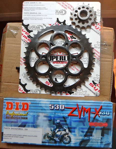

  5. I went DID 530ZVXM 110 links with a 42 tooth rear Supersprox. The extra two links combined with the extra teeth will put your chain adjuster about where it is for stock. I didn't change the size on the front as I felt the rear gave me enough compromise. 6th gear is now usable and less of an 80mph+ "over drive". it also makes low speed more manageable and the pick up better , but not overly feisty for the traffic light grand prix.

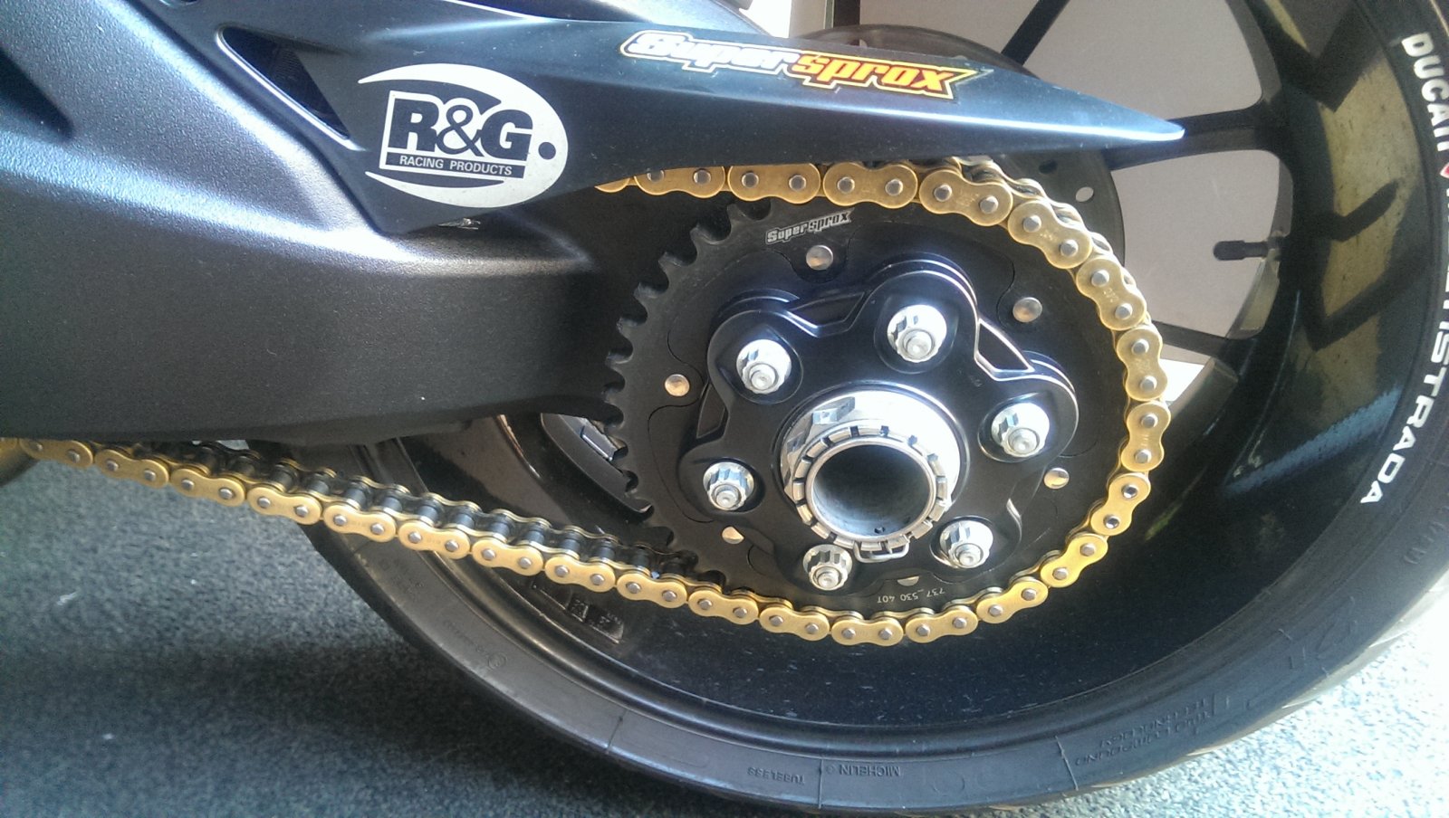

  7. I went DiD gold 530 zvxm standard teeth rear superprox and 1 tooth less on front, much better acceleration and when travelling around town find it happy to sit around 30mph in 3rd. Copied AndyW look but love it :)
