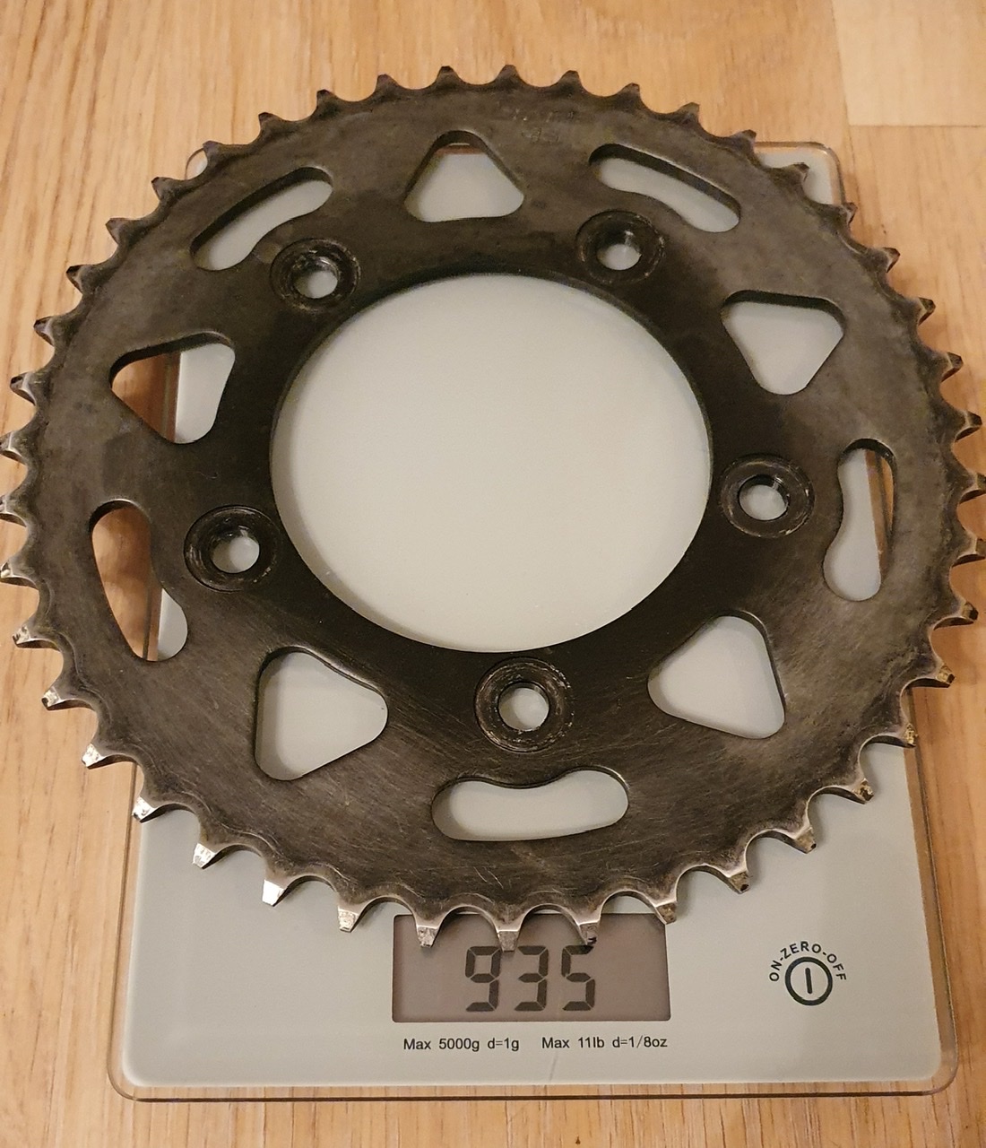

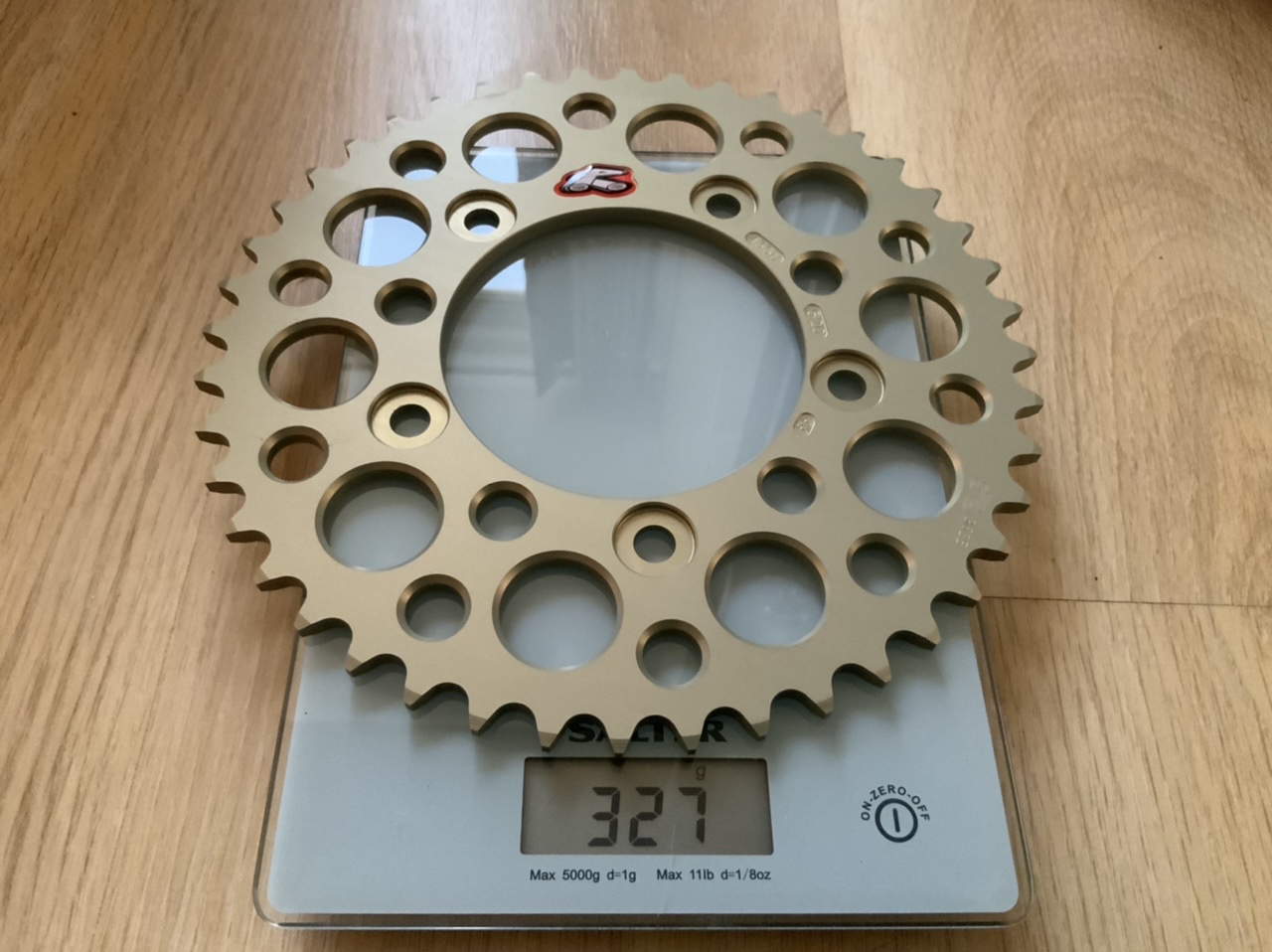

  4. Steel is going to last longer - but look at the difference in weight on the steel vs alloy - these are from my 959 and for a track bike the difference is worth it in my opinion.
    D2797311-B6E9-4665-9BB9-48AD8436E89F.jpeg 3C8775FF-B069-46E7-AFC8-B4310CAC4C84.jpeg

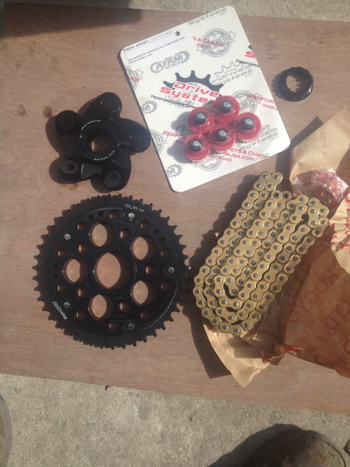

  10. At the time i could only find Afam poly cush drive rubbers at the same time I’d ordered some other bits from the USA. The ones Birdie linked to look similar and are cheaper.
    The carrier us CNC racing italy.
