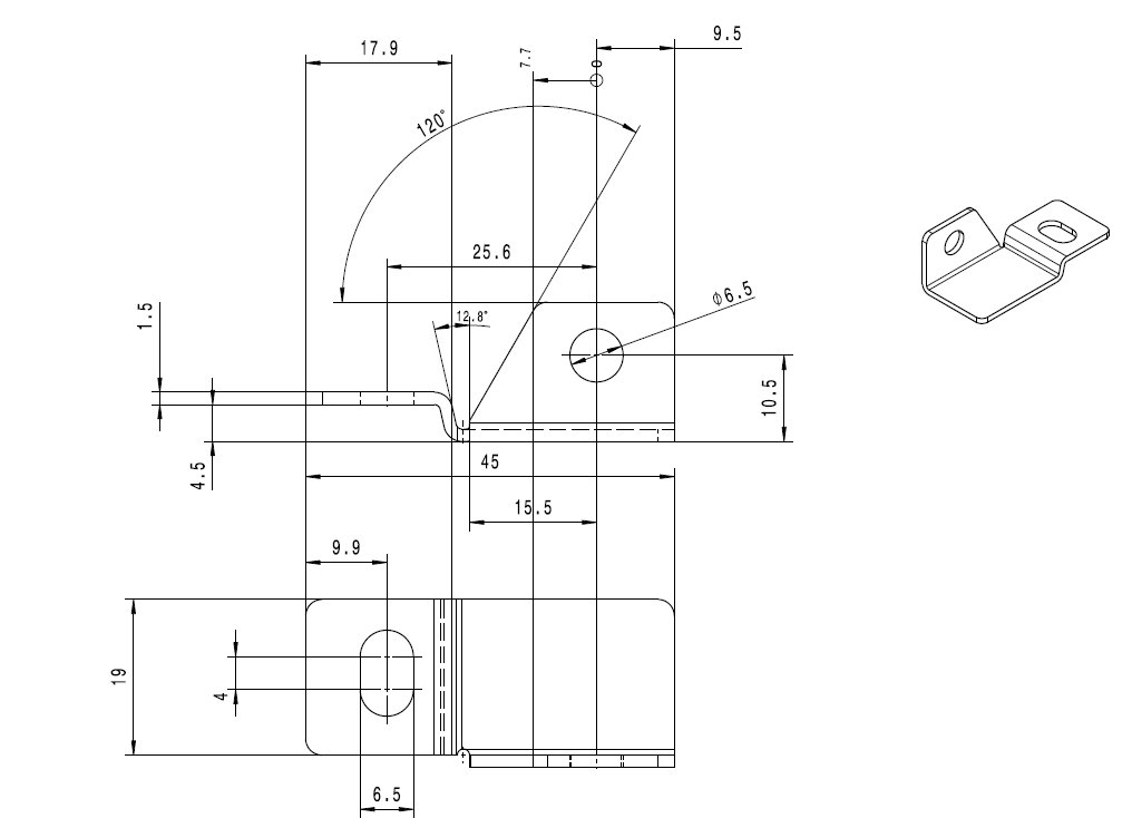

    Material: 1,5mm Stainless Steel
    Here is a sketch for a sheet metal part, if you prefer the original Scottoiler
    dual injektor. The placement is a little bit higher than the part from Andy,
    so it is a little further away from the chain .
    I have also used it a short time, but then I changed to the Plastic nozzle with Ducatilog
    (design reasons ).
    Gruss, Reiner

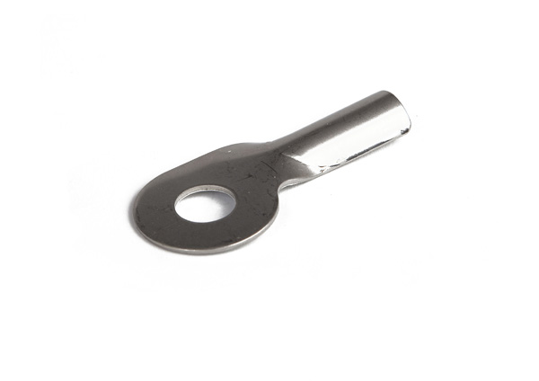

  7. Got the single Scotoiler injector on mine. Seems to work %50 of the time. Nozzle slope cut to a 45 degree angle must face away from sproket face so it doesn't clog. As NOT seen on a photo above.
  8. Fiddly but works better.............rather than just a straight 45 degree cut for the delivery tube cut a small V notch in the side of the tube that faces the sprocket as well - helps keep it clear ;-)

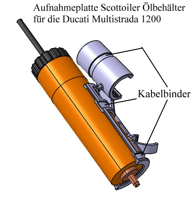

  12. The reason for the dry chain may also come from an oil reservoir which is mounted to flat.
    There may be air in the line and the oil stops for a time.
    So it was with me. Since I have the tank mounted differently it is good.
    The dual injector works, if you find a solution to mount it.
    ( look to the picture of the sheet metal part in this thread )
    Greets, Reiner
  13. Yes with the limited mounting options (somewhere safe and out of site) the reservoir is likely to be mounted at a less than 'optimal' angle (ideal would be upright) but slightly more regular topping up ensures no issue - mine runs ok for approaching 1000 miles between fill-ups)

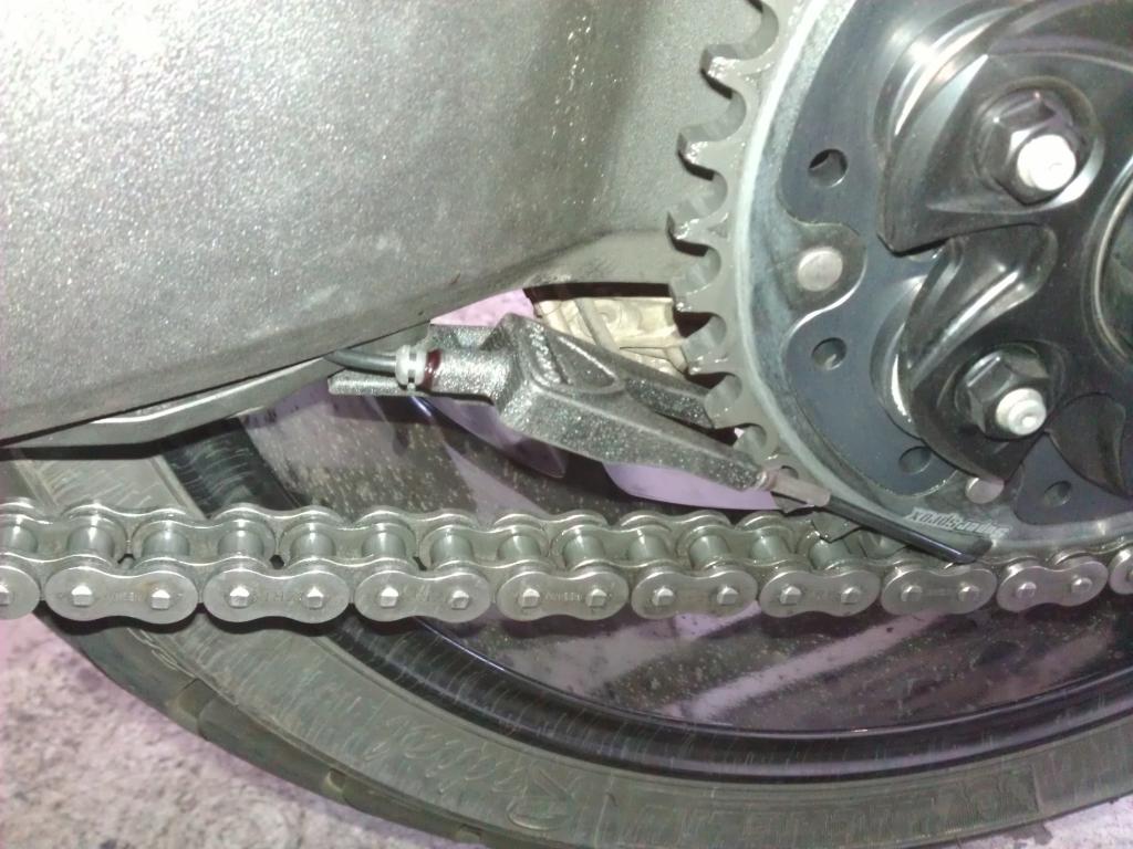

    Standard Scottoiler dual injector hardware.....modified mounting ;-)
    ...more photos here: Multistrada 1200 Scottoiler eSystem Install - AndyW-inuk's Photos

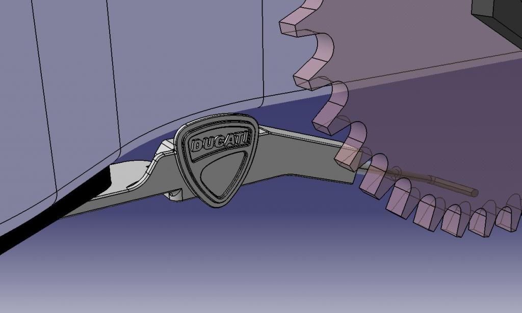

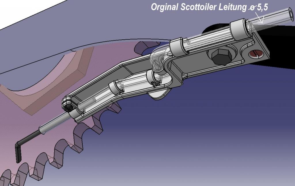

  14. Here is a photo of my lasersintered Dual Injector:
    Reiner
