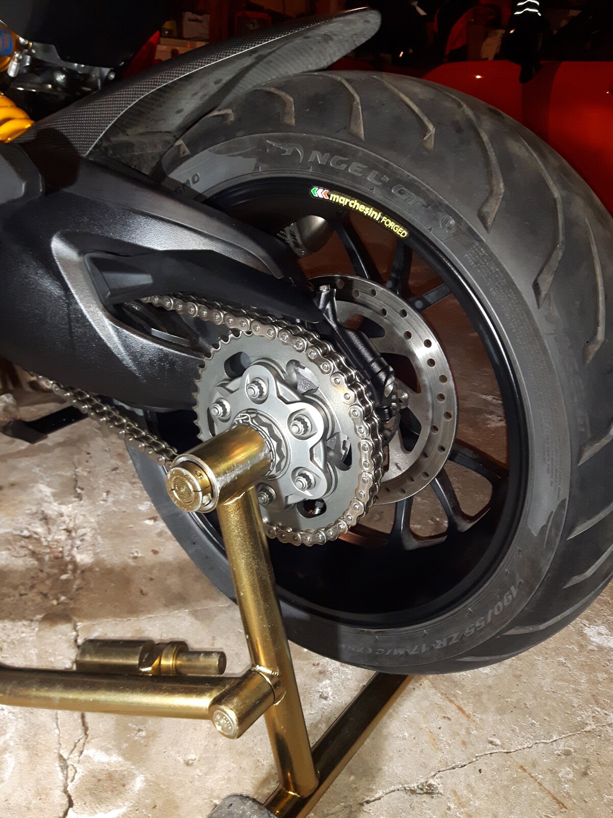

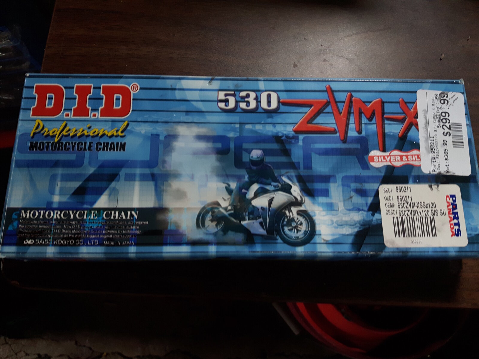

  8. Yup. Regina are OEM and they're crap. I had a gearing change done at the first 600 miles service. Best decision I've done.
    Why endure 15,000 kms with the stock gearing?
    I have: 42T ESJOT steel sprocket and DID chain.
  9. I'm with him :upyeah:. Same set up, just fitted and it is a much nicer bike to ride.
