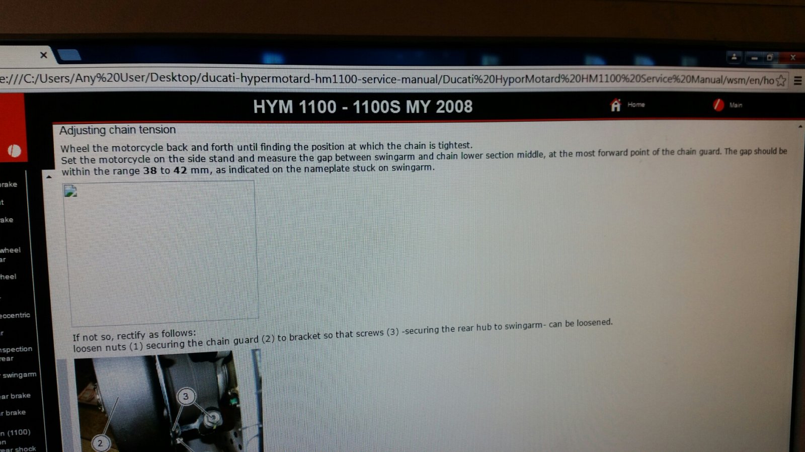

    Swingarm sticker says 30-33mm
    Workshop manual says 38-42mm (which it then states the swingarm sticker says)
    Strange as it seems when I set it to 31mm on the paddock stand it measured 40mm when on the sidestand
