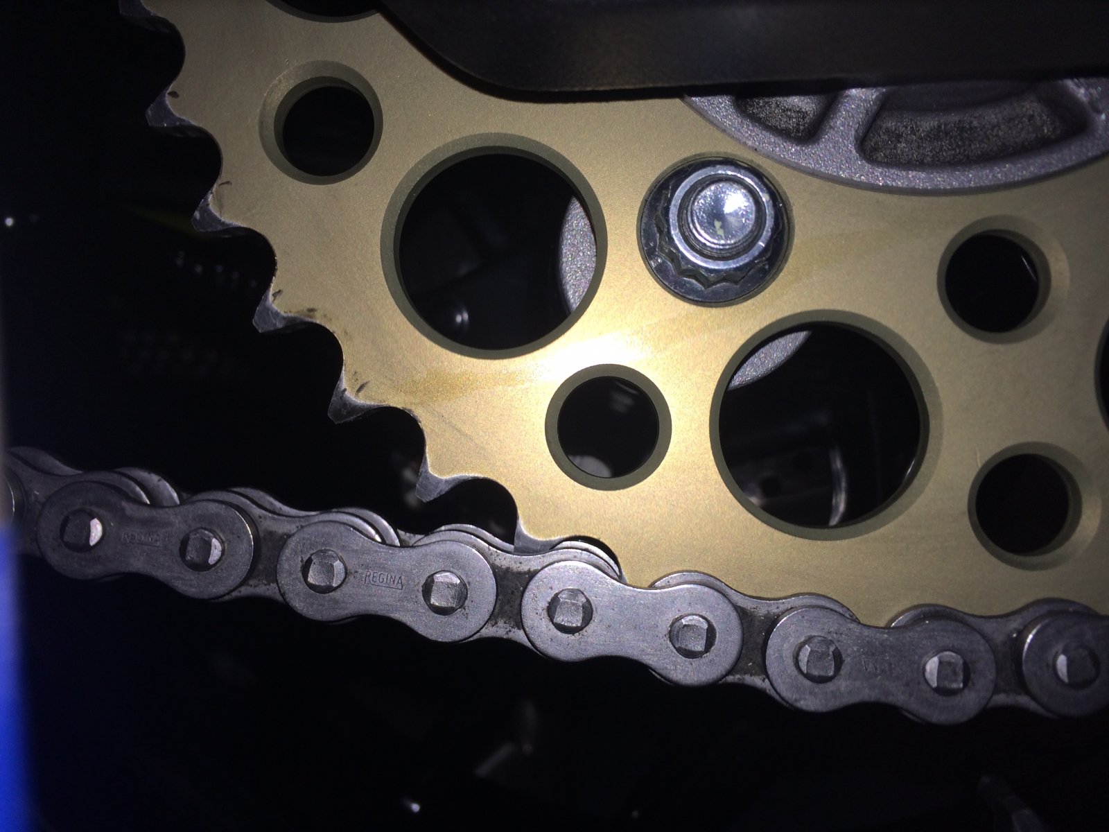

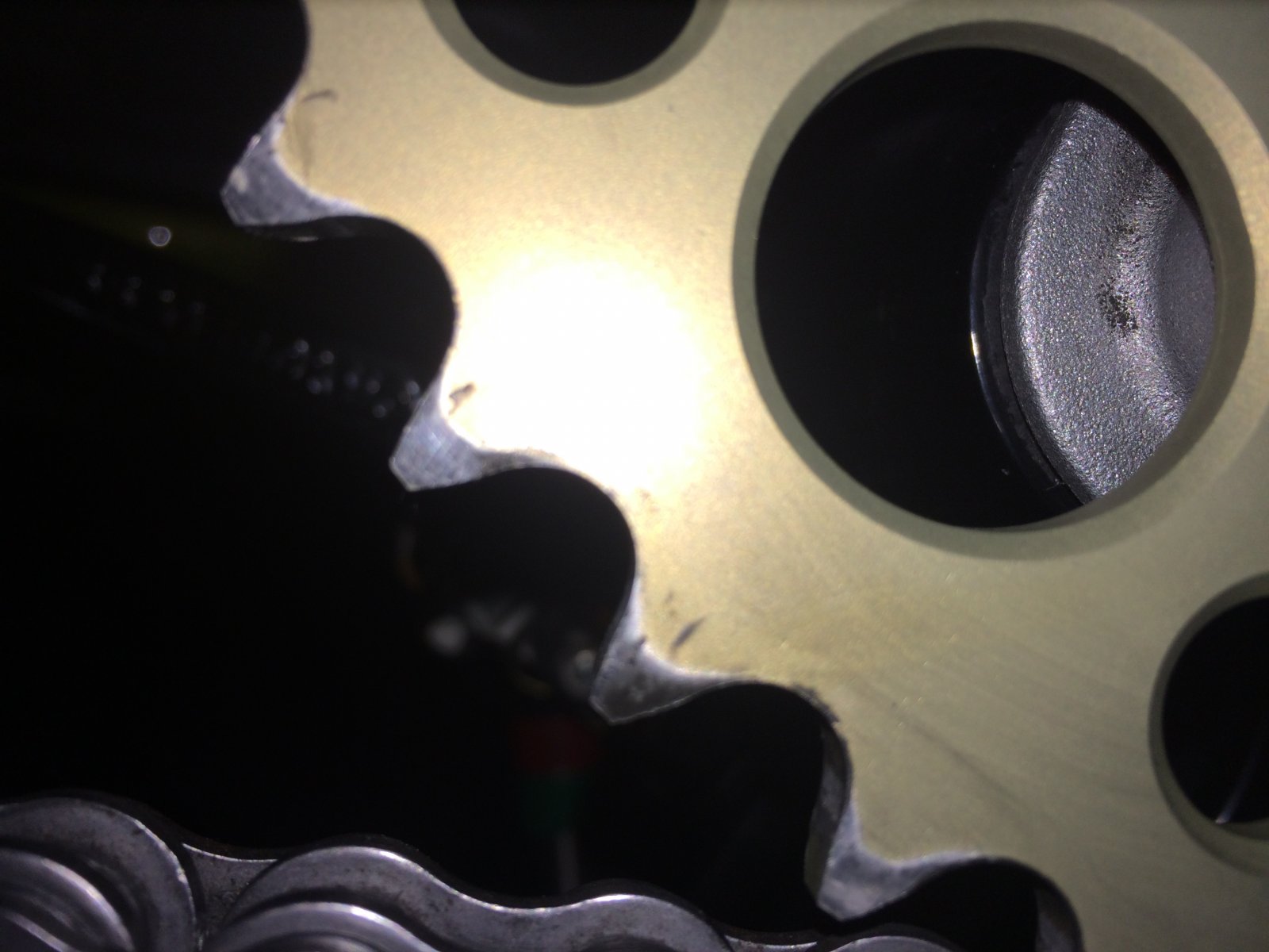

  3. the rear i don't mind as i have renthal and don't expect more than 4000 miles out of it and has already done over 2500 miles anyway but the front is a pain in the arse to change... even to inspect is a fart on

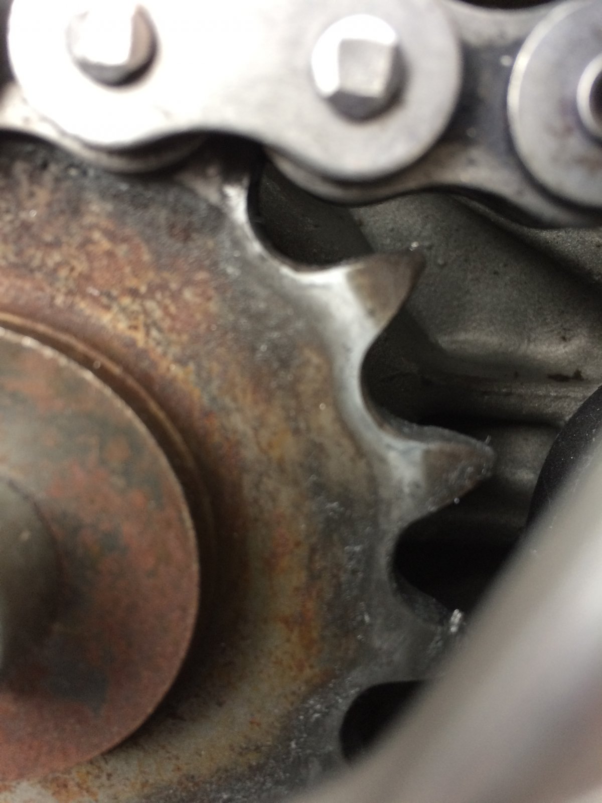

  4. Doesn't look bad. Just starting to show signs of Wear now. Will see what the front looks like. Would be much easier to just replace the chain and no sprockets

  7. Front just starting to show signs of Wear now so worth replacing both sprockets when I do the chain
    What a faff to check the sprocket. Side fairing off, QS and clutch slave just to get access to the cover... tool the chance to replace the cheese bolt on the QS to selecter arm which was getting rounded off after just one removal. Some of the bolts and fixings ducati use are a joke
