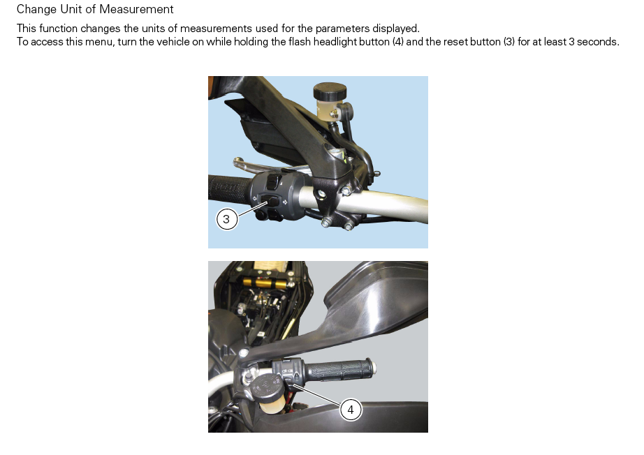

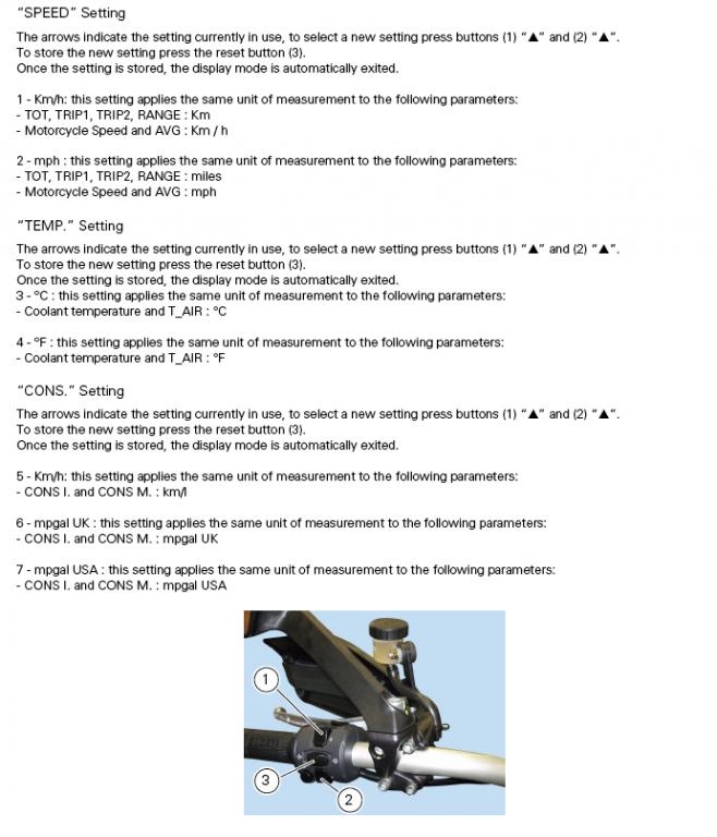

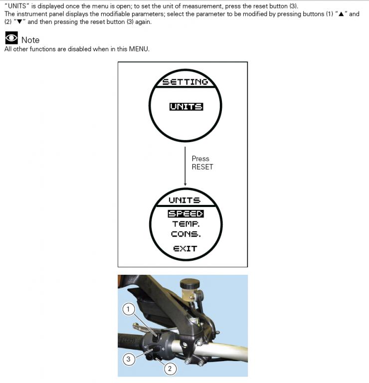

  8. It's not in the owner's manual but it is in the workshop manual-
    Screen Shot 2013-07-04 at 17.28.45.png Screen Shot 2013-07-04 at 17.29.08.jpg Screen Shot 2013-07-04 at 17.29.32.jpg Screen Shot 2013-07-04 at 17.29.46.png
