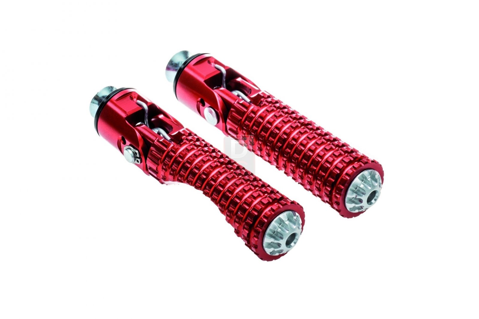

thanks mate, appreciated ive recently ordered these from design corse Ducati Footpegs Folding Universal Comfort CNC Racing

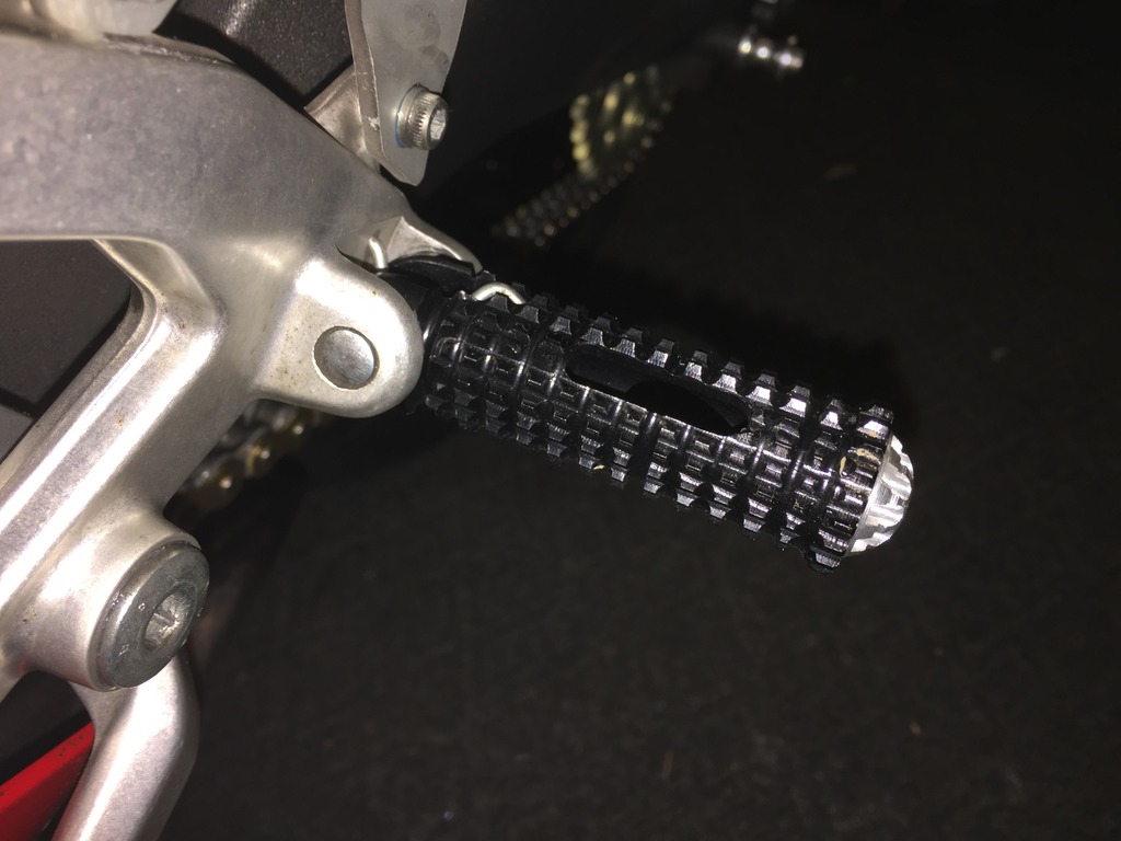

Red, If you have ordered the exact ones in the pic shown they won't fit, you just need the "peg" bit, from the pivot pin forwards if you get my drift? Your footrest hanger has the pivot pin locations cast into it, there wont be a hole to put the big countersunk head screw through. Mine fitted :- I ordered and fitted the exact same footpegs, they are a bit shorter than the original pegs but your foot stays on ok as they are a lot grippier. Hope this helps
