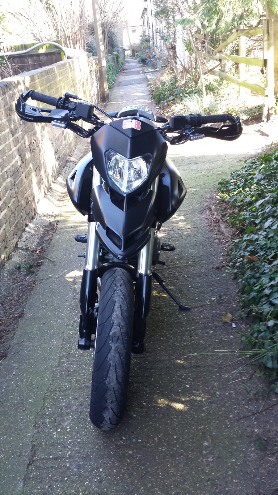

  1. I'm keen to change my flappy mirrors for traditional ones and remove the hand guards on my 796 because I commute thought central London each day and I've found I have my mirrors folded in all the time.
    Seems a common mod however I've not been able to find any pics of people doing it on a 2012 796 like mine (See handle bar pics below).
    I'm planing on removing the hand guards too to make it easier to filter so I need mirrors with LEDs, I think.

  12. So just if in case there are any other numpties like me who completely misunderstood what was intended for this mirror mod.. here are some pics of mine with the process.
    I ended up purchasing these (Ryde Motorbike 22mm Handlebar Mirror Mount - Black) for £4.90
    Ryde Motorbike 22mm Handlebar Mirror Mount - Black: Amazon.co.uk: Car & Motorbike
    and these temporary mirrors (Excellent Quality E-Marked Motorcycle Motorbike Wing Mirrors To Fit 10mm) for £19.95. I probably could have gotten cheaper ones on ebay in hind sight but these ones look like top quality to if they end up being permanent I'll be happy.
    Excellent Quality E-Marked Motorcycle Motorbike Wing Mirrors To Fit 10mm Thread: Amazon.co.uk: Car & Motorbike
    I still plan to remove the hand guards and then add mirrors with LED indicators... but I've only been able to find them in the US so far from motor-science.. but they seem pretty good.
    With new 'half' the clamp being screwed in
    One of the new mirrors in place
    Mirrors in place, old bike on the right going to be up for sale soon
    New mirrors other angle
