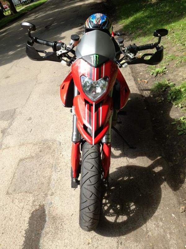

  5. I fitted a pair of mini indicators to my hand guards and a a pair of small mirrors to end of my bars. they work great far better then the crappy ducati mirrors (straight in the bin) IMG_0310.jpg
