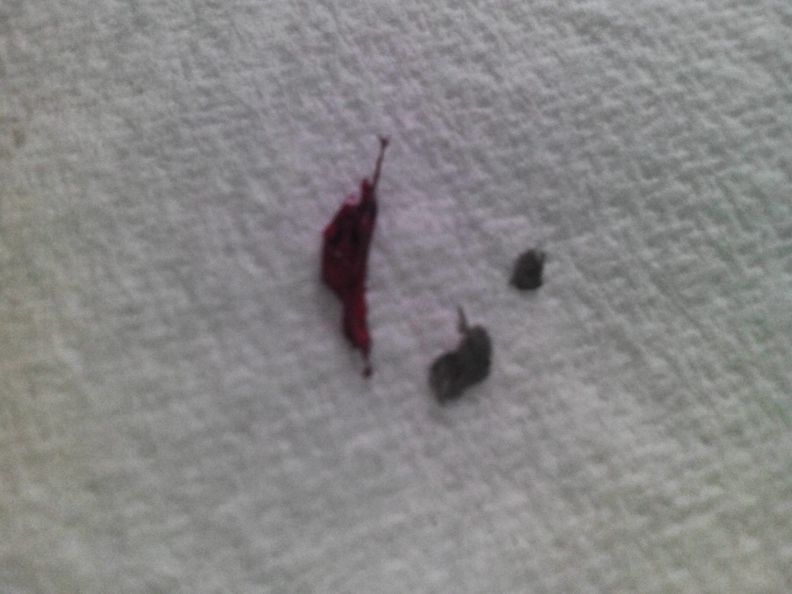

    This i what was in there !!! Much better than i expected especially when you read the Horror stories...:Wideyed: i also popped a magmet tool inside the sump area beyond the sieve just incase anything was hangin about but nothing & only a v slight bit of metallic on the magnetic plug....
    Red bit looks like some form of gasket sealer & the other two appear to be crankcase paint...They are not Magnetic

  10. Nothing to worry about there.
    Worth checking the filter too but yours will be clean.
