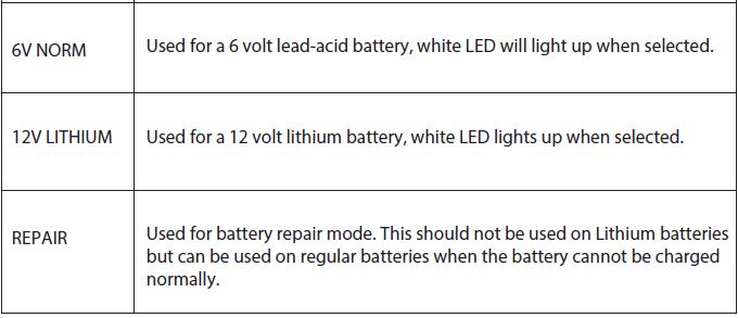

    The charger has 7 modes of charging, and I’m particularly pleased it covers Lithium so my charging needs are future-proofed for a while.
    However, unlike the hugely more expensive CETEK I use to keep my Boat Leisure Batteries and occasionally Land Rover batteries topped up, the Hypercharge doesn’t automatically identify what type of battery technology you’ve connected, so the user needs to choose themselves.
    The first three are obvious, but knowing when to resort to ‘Repair’ might need some clarification:

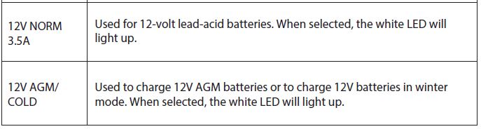

    There are then two modes to charge at 3.5A

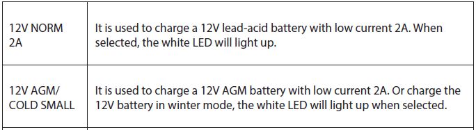

    And two at 2A:
    I think it would be really good to include in the instructions some more details of when to use the 2A and 3.5A modes.
    Unless you know what you are doing it could be easy to ruin a battery with the 3.5A mode.

    I’ve always charged Bike batteries at lower currents, so for a typical say 10AH Bike battery I’d use the 2A Option.
    Am I being over cautious?

  2. Can't answer Q1. Q2, I too choose to use a low current charge for lead acid chemistry motorcycle batteries, I use the 3.5A charge rate for car/leisure batteries. Q3, as far as I understand it, an AGM battery is (marginally) less affected by sulphating so the charging doesn't need to address the problem as often. The repair mode is, I would guess, for recovering a discharged battery, showing 2 or 3 volts. My Noco does this automatically. Setting the mode on the Noco follows the instructions you have. If they don't work on yours, I'd go with what works. If the instructions are not native English, the translation has been probably done by a non English speaker. Andy
