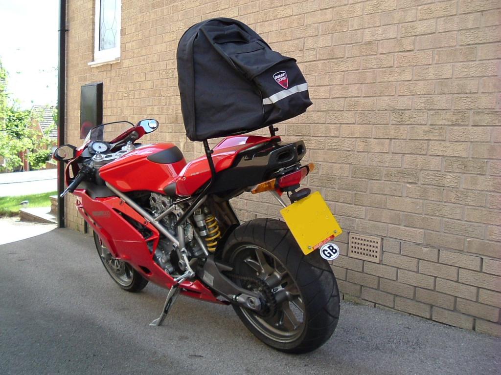

It bolts onto the rear subframe mounting for the mono. Whether it would fit the biposto I do not know. I have this system for my own 999 mono and it is not as stable as my 1198 one that has two fastening points.
Cheers for the photo, That's where I thought it'd fit. Would bolt on the same but I wounder if the mono is narrower at the back where the rack spans over the seat than the bip.

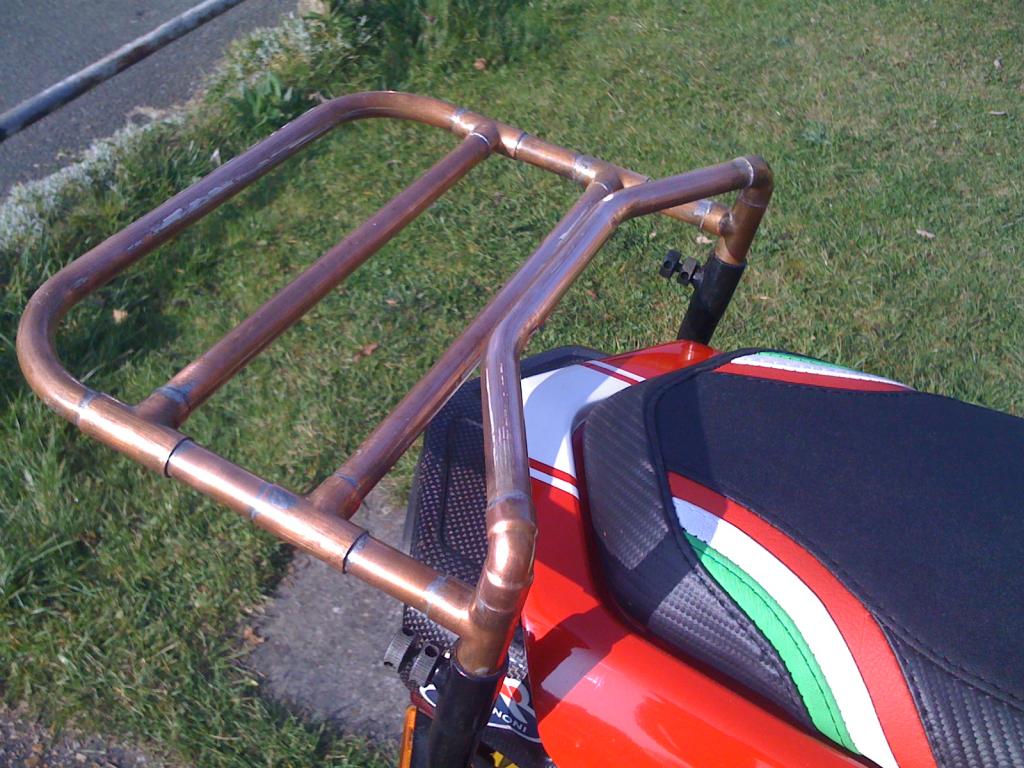

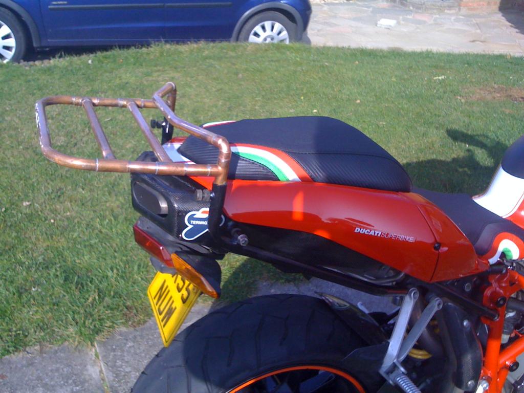

I bought a couple of Ventura side rails cheap and made a small rack from scrap copper . Where the spigots go into the sides is same OD as an endfeed fitting so double thickness where it counts and strong enough. Cost me about £20 inc the ventura bits.

Haven't actually used it yet, I'll spray it black if I do. We travel really light, a tank bag and small backpack does us for a couple of weeks wash'ngo.
