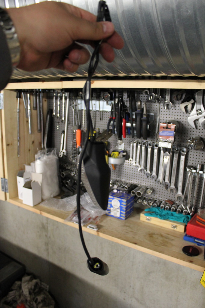

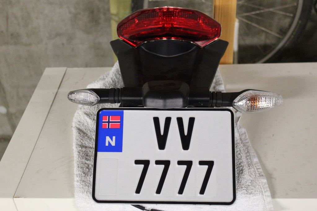

  1. New member here, just said hello in the Multi gallery:cool: I can`t remember anyone have showed this mod, but I found out that the LED rear turn signals on the 1199 Panigale is bolt-on on the Multi:upyeah: Only difference is that the 1199 turn signals have longer wires, but that is not a problem. This lights are also CE-marked, so they are road legal.
    I actually like the original plate holder, but did not like the original bulb turn signals. So I think the 1199 turn signals are perfect! They should have come standard on the Multi, especially now on the 2013 model that even have LED driving lights. I have also changed the plate light bulb to a Osram LED bulb.

  7. Are you looking in the parts list for the USA version? You have to check the parts cataloge for the EURO version, aka the original 1199:biggrin: In USA, and maybe other parts of the world, the 1199 have the same rear turn signals as the Multi (and several other Ducati models).
    P/N for the LED rear 1199 Panigale turn signals are:
    Left: 53010282A
    Right: 53010292A
    On the cardboard box the lights came in, it says front turn signals. But no Ducati have this turn signals in the front. Only the 1199 use them in the rear.. Just Italian logistics I think:tongue:

  8. Excellent mod...and the smaller indicators do not seem to get burnt by my full Termi like my OEM ones did.
    Easy and quick to fit.
    Before (with burnt indy lens)
    After
