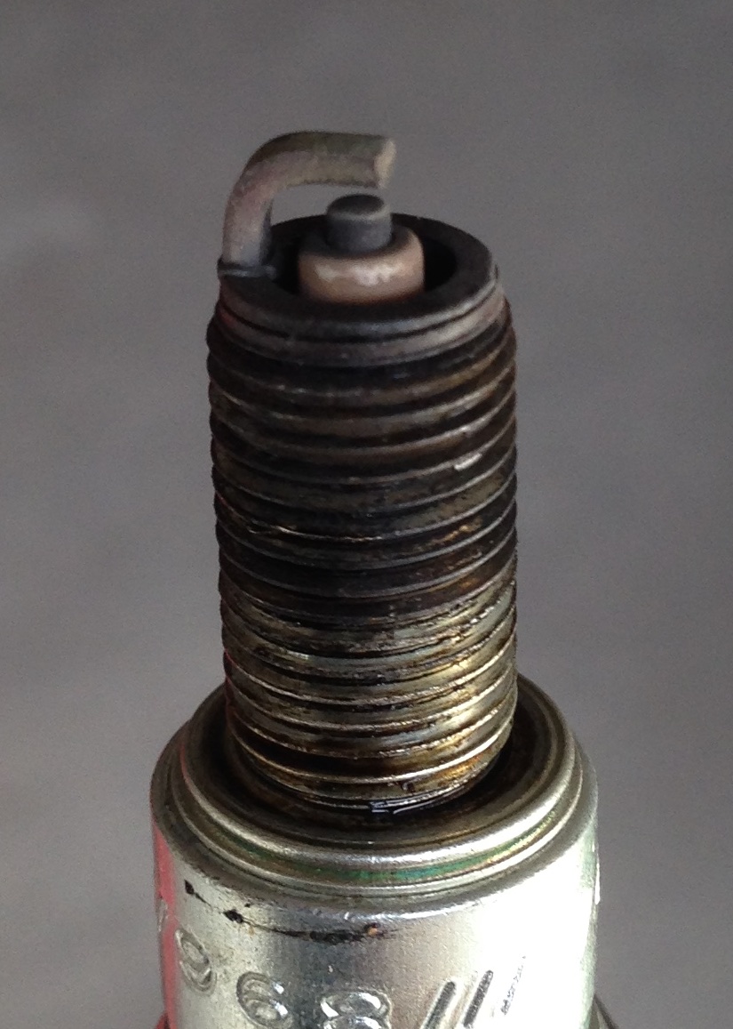

  1. As I am in the process of checking my new bike from A to Z I just have couple of questions I hope you guys can help with. It is a Ducati 749 from 2006.
    1. Is this spark pluk running optimal, or is it a little lean?

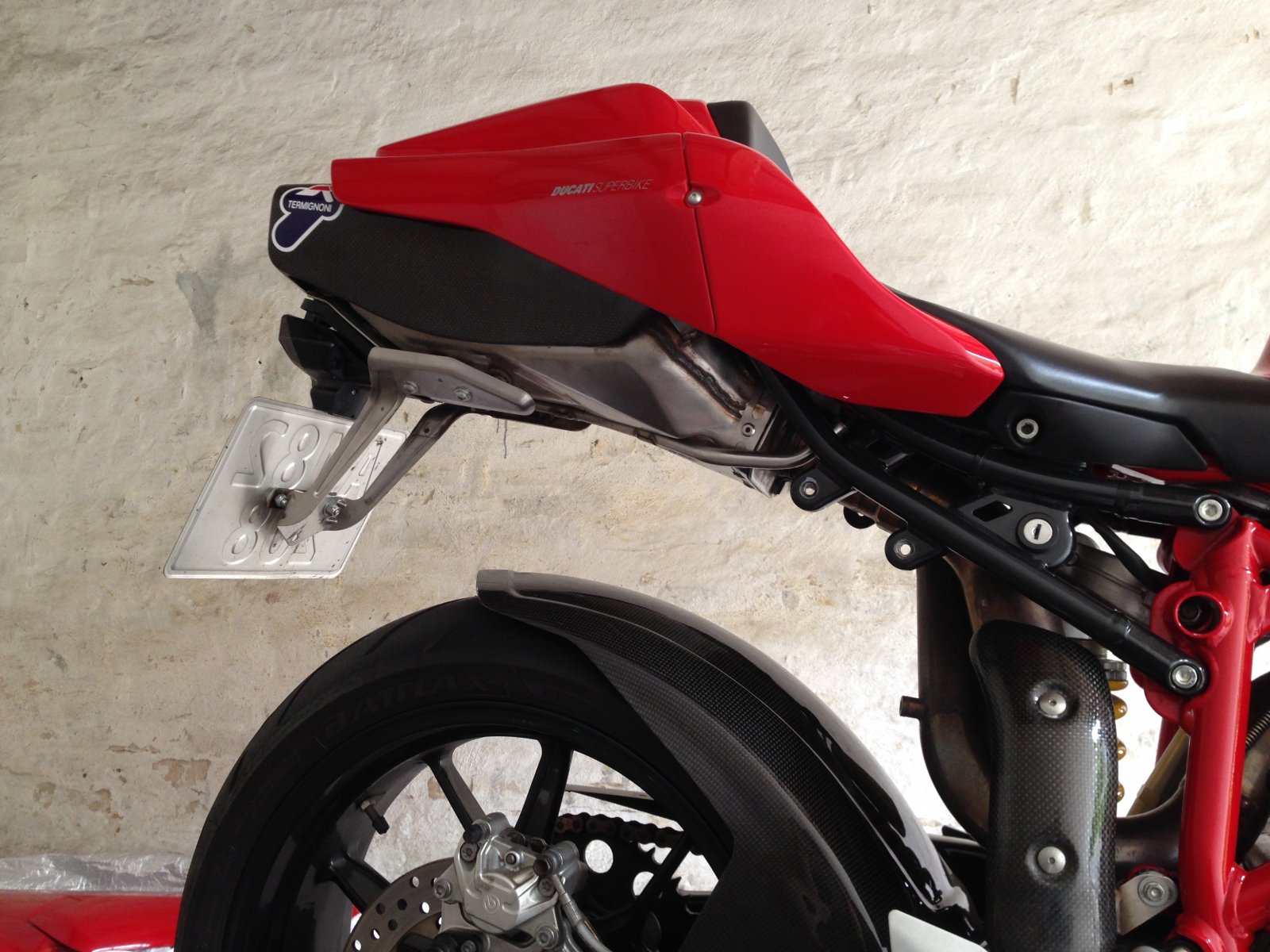

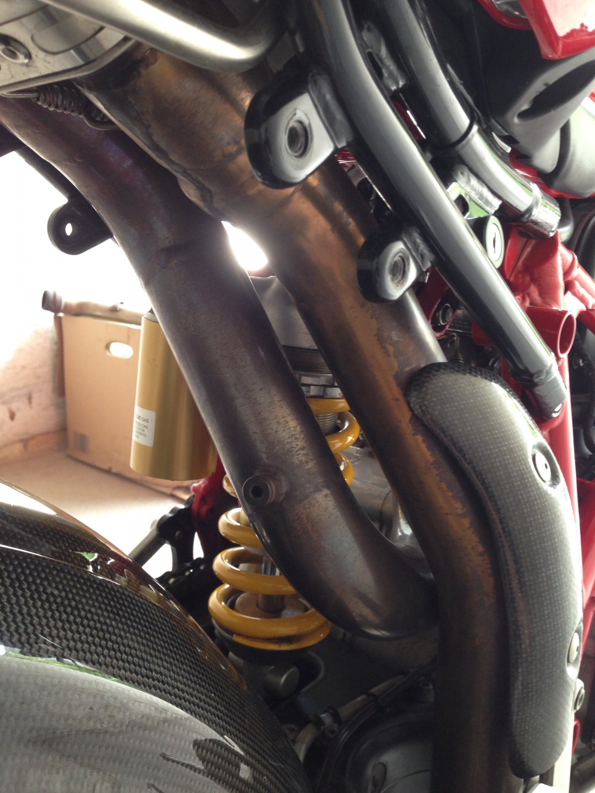

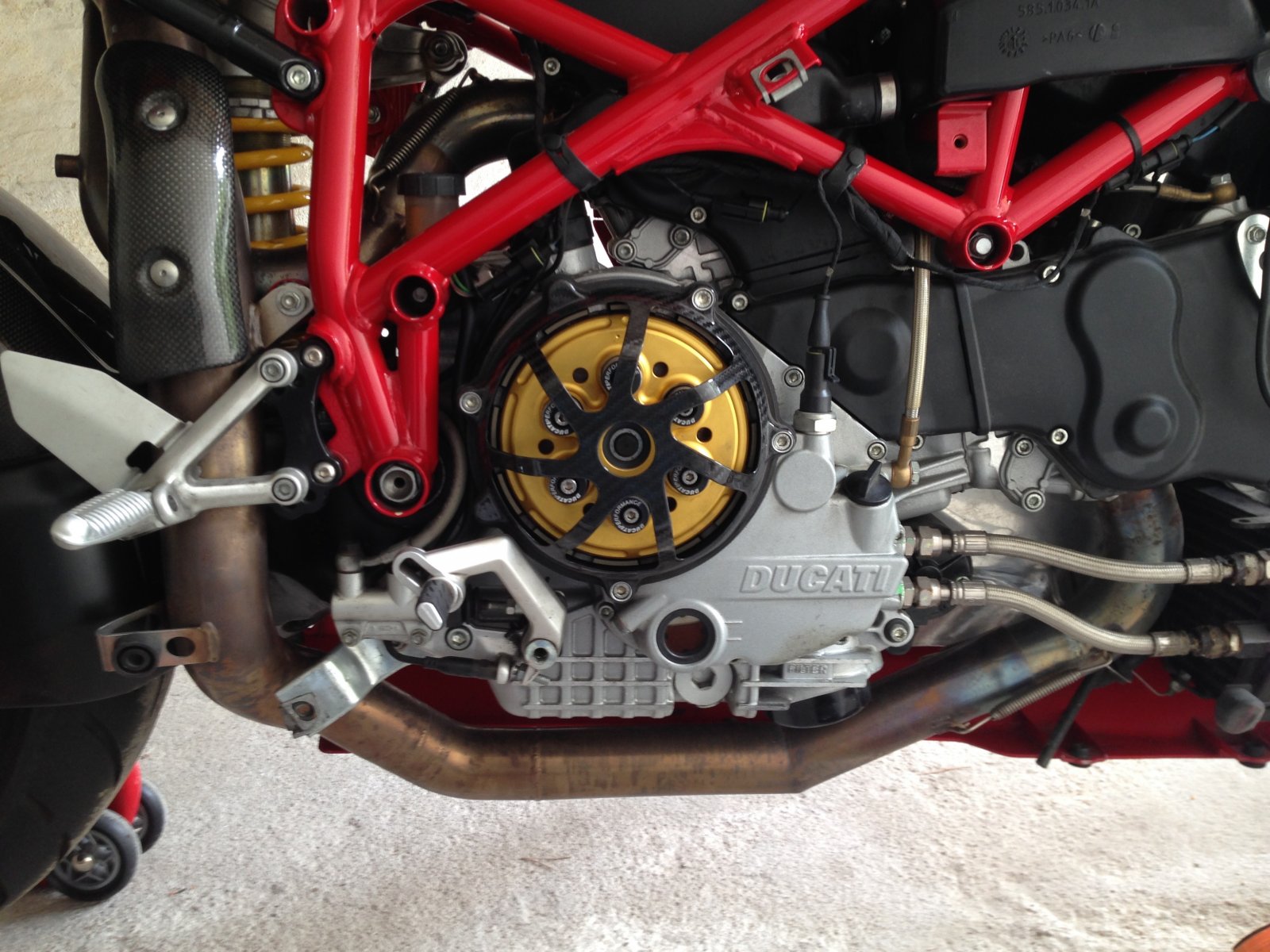

    2. I am having trouble determine what exhaust system my bike has fitted. It seems it is a half system Termigoni, but I am not sure? and is it only the 749R that has the deep sump system?

  2. 1. Looks ok to me.
    2. Looks like a standard asymmetric with a Termi can.
    Only 749R has deep sump on 749 models.
  3. spark plug looks ok to me.
    Fuelling issues are noticeable when coming to the stop at junctions: if it cuts out at near idle speeds, then you need to do TPS reset and adjust CO levels on ECU to fix fuelling.
    Looks like assymetric termignoni to me and shallow sump.
