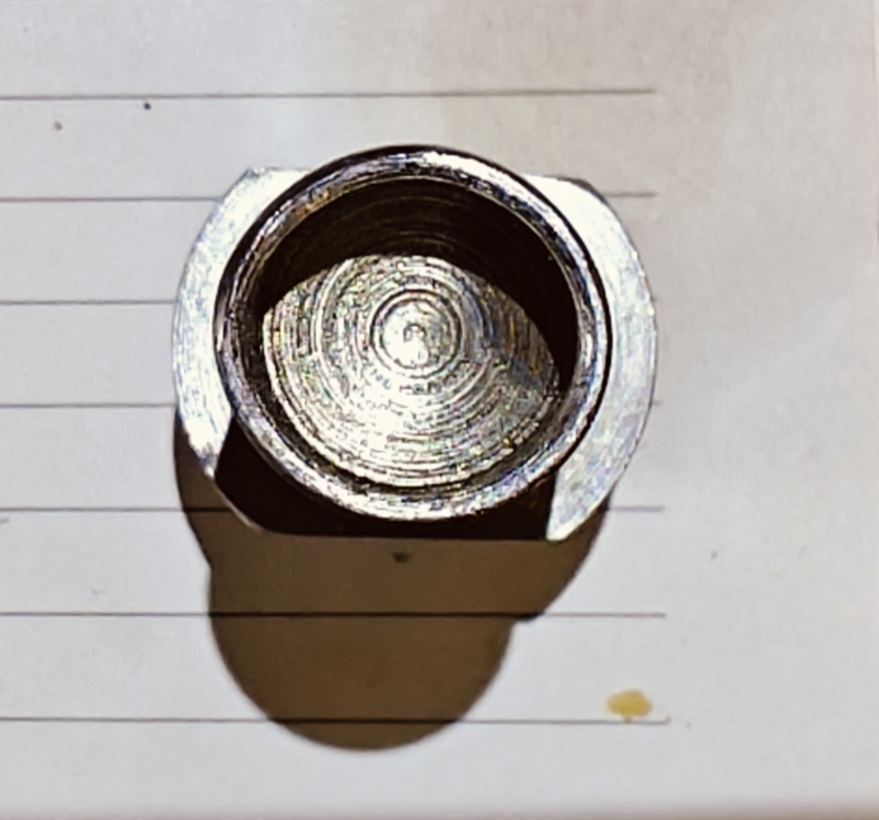

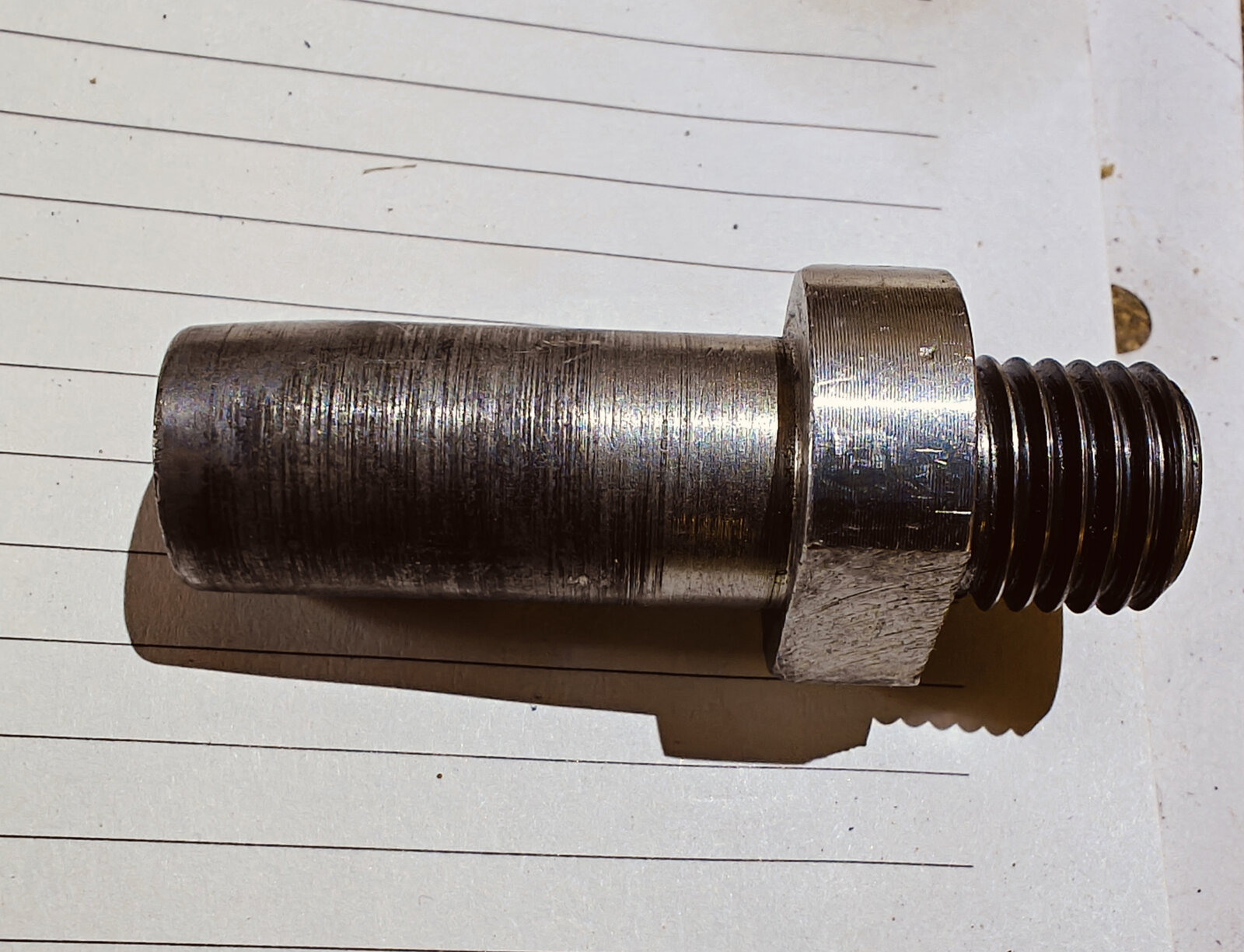

  1. Lifting the Monster onto the 1Jac as usual, when it fell off. No damage to the bike as poor car broke its fall. What's going on? Took a good look at the lifting pin and saw it had collapsed at the end because - inexplicably - the first 10mm was drilled, so rather than a solid pin, you're lifting with a thin walled tube. Check yours regularly! IMG_20240708_180935.jpg IMG_20240708_181051.jpg

  5. They are usually drilled to allow for bolt heads/nuts. You might not need that feature but another bike with the same diameter lifting point does. I'm guessing they use that pin on a number of bikes.
    I have these type of pins on my Abba. Never a problem unless they're not engaged properly.
