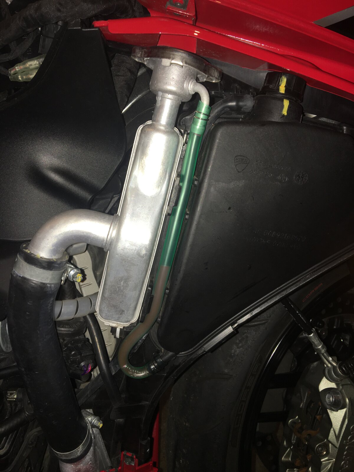

  6. Adding coolant is a pain, but checking is easy. Forget the viewing window tbh. Even shining a light on it or in it, the light still refracts too much imo.
    If you take a line from the window, around to the outside of the tank, make a mark. It’s about half way up iirc. There’s a pipe connected to the bottom of the tank, that runs up to the radiator. Disconnect it at the radiator and hold the open end level with the mark you’ve made. Fill the expansion tank until coolant comes out of the pipe. That’s the level inside the tank. Then just reconnect the pipe.
    It’s took longer to type than it takes to do the job and it’s accurate to.

  8. I've been through this pain also recently having done a coolant change and I used this trick to check the level. What I have seen recommended is actually swapping this pipe for a clear one and then marking the min and max levels on the outside of the tank. Then you can view the level without torches or disconnecting anything
  9. I was wondering whether I could do that. Thanks
  10. I changed the black rubber tube for some transparent stuff.
