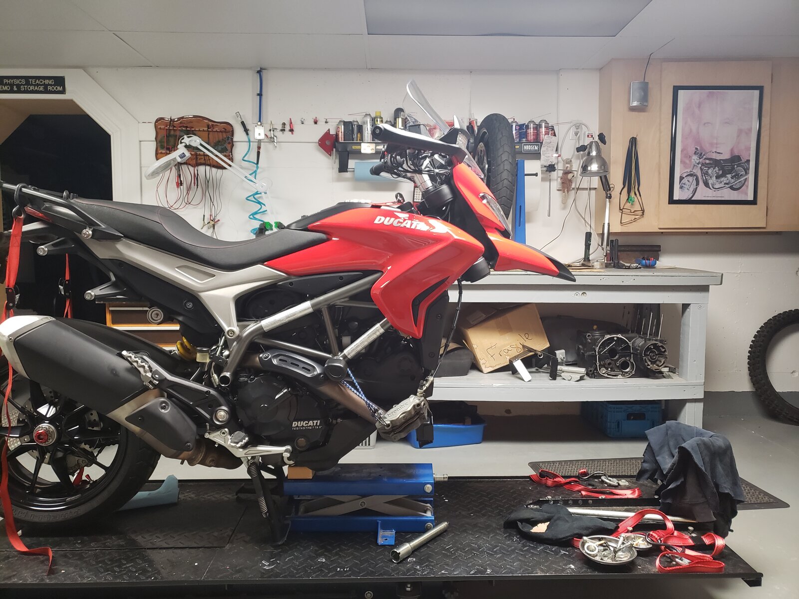

  1. Howdy from Eastern Canada. Since it's freezing cold and i'm up to my elbows in snow, this is the current state of affairs. upload_2022-2-2_21-27-58.jpeg
    After changing the belts, changing all the fluids, new filters, battery and a couple farkles, it was time to see what i can do with the front suspension on my 'new to me' 2016 HS low. Problem is, i'm having a helluva time finding anyone on this continent that can help me. It seems like my possible solutions are Andreani, Mupo, Gears Racing, and possibly Nitron. I took the forks to the local guy and he said he couldn't help me for less then about $3500 CAD. Needless to say, i walked away. I would have tackled the forks myself but was a little leery of the construction of the LH leg. However, it looks like I'm going to get the experience whether i like it or not. Anyone wanting to help out by offering their experience installing carts in these beasts, please feel free to do so. Cheers from the 45th parallel!:)

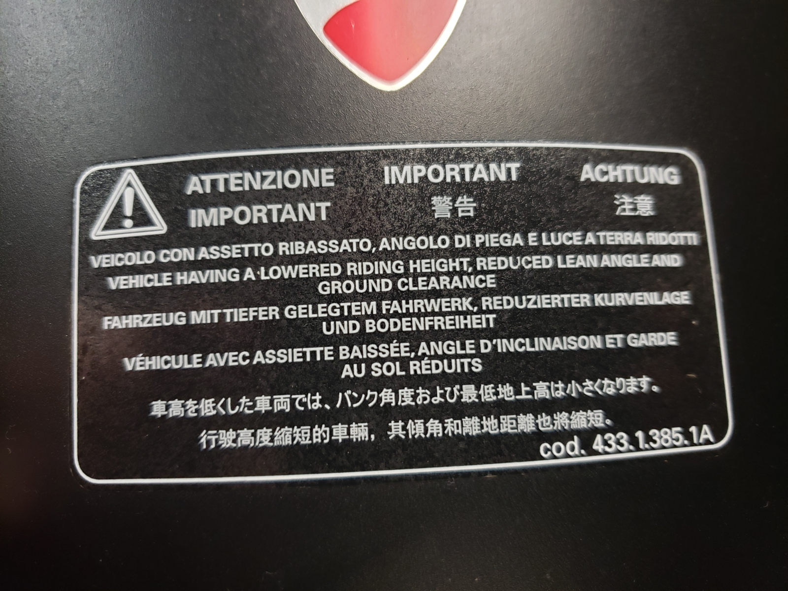

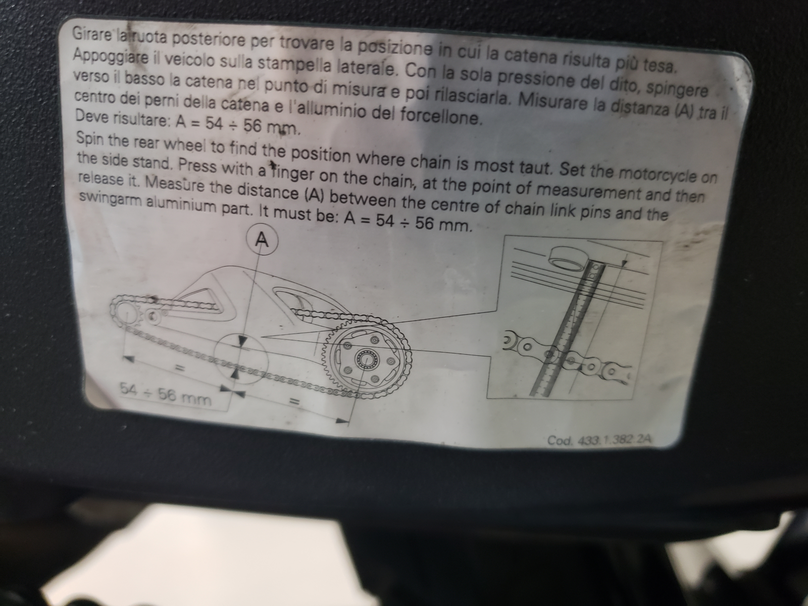

  11. A very good point. In order to check to see if my forks are 'shorter' i'd need some info i can't find. So far the only info on suspension height is the press release describing the suspension as being lower. There are lots of opinions online as to whether or not a low version actually exists. Others say that in 2016 all HS's sold were the low version. The manufacturers service manual makes reference of different seat heights and chain tensions but provides no measurement of any fork components. The VIN number doesn't reflect whether or not it's a low version. My bike has a sticker stating it is lower. That sticker has Italian, English, German, French, Japanese and Chinese text. Which tells me it was sold pretty much world wide. The chain tension specs on a second sticker on the swing arm reflects it's a low version as compared to info in the owners manual. See photos of the sticker below. Andreani sells different versions and specify a low version. Here it is. https://www.andreanigroup.com/prodotti/moto/105|D12E/?CARTUCCIA+DUC.HYPERMOTARD+821+LOW+-+

    I'll measure my standard HM forks at the weekend and let you know, however it certainly looks like you have a low from those stickers...
