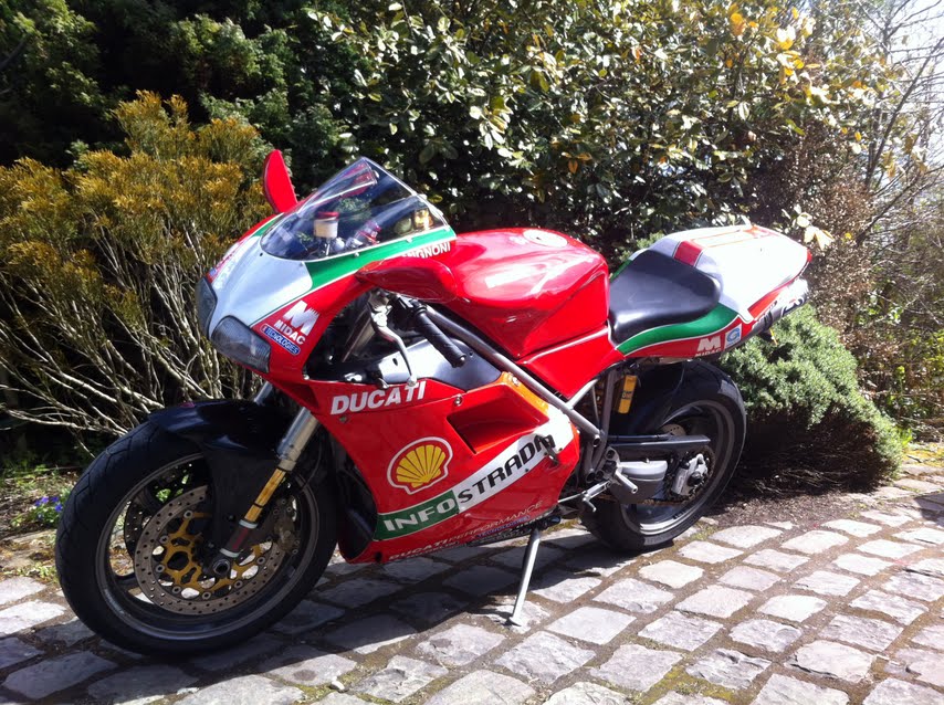

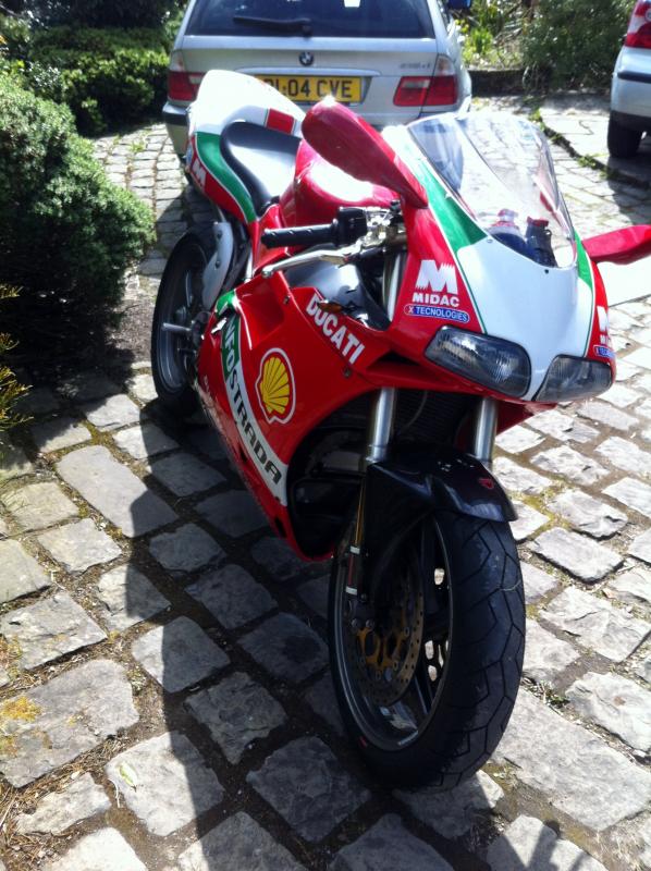

  1. I said I would report back after buying my chinese ebay fairings from 'Mr Yes'
    Overall very happy
    Arrived very well packaged in a box with wooden battens and each bit very well protected
    Mono seat doesnt have posts so had to drill two holes to take supporting posts - otherwise fits fine
    Headlight cowl was slightly misaligned so had to dremel the headlight openings slightly on one side but otherwise fit great
    Side panels came in two pieces - no fixings supplied and the holes are slightly too big for conventional fixings so had to use washers - may source some slightly larger headed bolts as would look better
    The side panels on the right hand side fit with no mod at all
    The left hand side needed a hole drilling as the one in the panel was too far forwards
    And that was it!
    Fitted Dzus as per the originals and they all fit great
    Woulnt want them as road panels as the extra hole or two would bug the hell out of me but tbh the actual paint finish is excellent and as track fairings I think they are brilliant
    Just need to fit some heat foil underneath now and we are done
    Will be at Donny on the 28th May so come say hello
