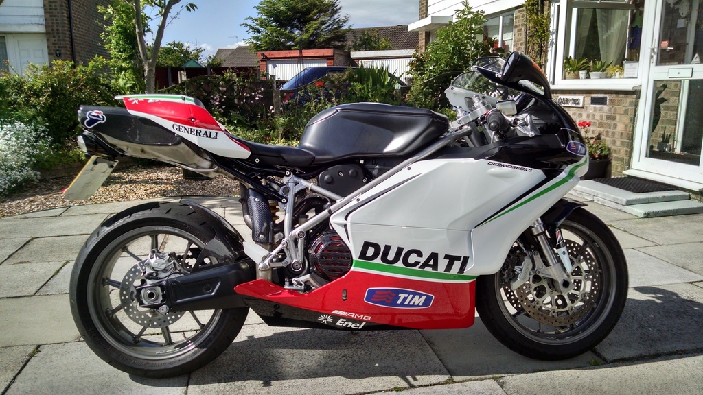

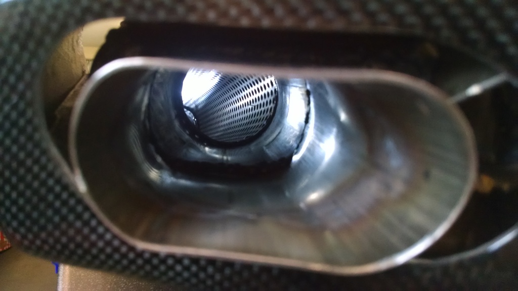

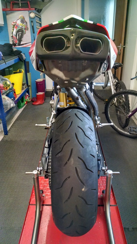

This is a crash damaged 749 Dark i bought last year, Did the valve clearances and belts removed the cat in the front pipe and had the end can de-cored with 1098 outlet pipes, power filters and power commander. Ducati corse slipper clutch and mono subframe. Finished off with a set of Chinese fairings.The exhaust work was carried out by MTC in Burscough, the 1098 outlets were larger than the ones on the Termignoni 749/999 race silencer so the holes in the carbon cover had to be enlarged. Its a deep tone but not ridiculous, MOT was fine and as it was the original silencer body CE marks are still visible.

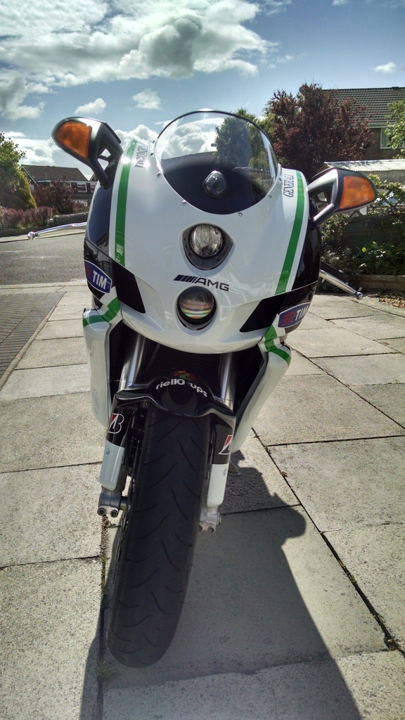

i must admit i was pleasantly surprised with the fairing, i got to choose how i wanted it as they made it to order, 2 weeks later they sent pictures of it complete for my approval. It was fine so i said post it, it arrived 5 days later in a reinforced box with a free screen, full fastener kit, rim tape and tank pad. Paintwork is very good externally with lacquered over decals, just a bit of overspray on the inside, had to open up a few screw holes etc to get the bolts through but once fitted everything lined up great. the cost was £327 and i didn't pay any duty.
